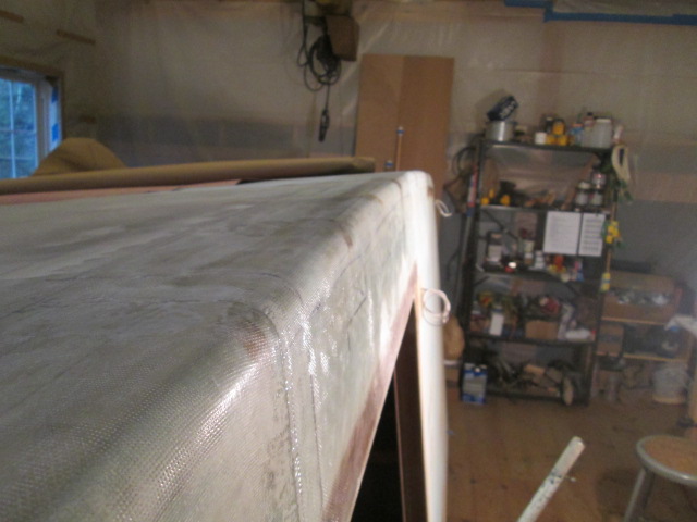

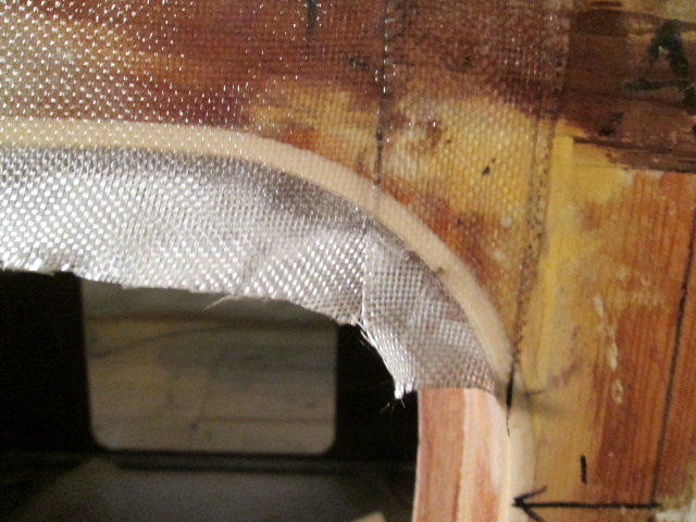

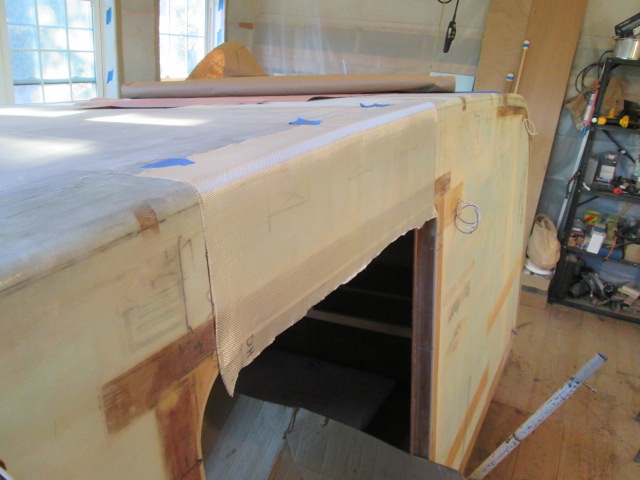

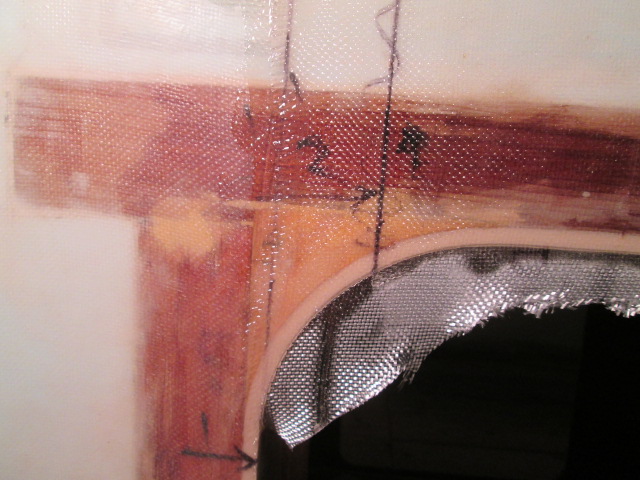

I decided to modify the door header and sill glass slightly. In the sketches I had the lap seams staggered from the front running past the forward door jamb, then again on the header and sill running past the rear jamb. I had the first plies ending flush with the edge of the door and the second plies extending 1-1/2 inches past; but then I realized that would potentially leave odd lumps in the rear portion of the wall layup. So I trimmed the header and sill cloth so that the first plies stop short of the rear jamb and the second plies land flush with the edge of the door. The next section (the large rear portion of the side wall) will have the first ply just overlapping the door opening slightly. The second ply will overlap the jamb by 1-1/2 inches into the door opening, overlapping the header and sill top plies, and I’ll trim the excess out of the jamb opening like I did at the front. The seams will be more symmetrical this way.
Anyway, here is the first ply of cloth taped into position over the header.
Wet that out; drape the second ply; brush that out flat with the palms of my gloved hands; squeegee to bring up any excess wet; daub on more wet as needed; trim most of the excess along the flox edge so that the weight doesn’t bend the fibers away; trim any stray strands around the perimeter that are easy picking; go back around to make sure everything is still laid down properly; and check for goobers/large drips on the surrounding foam. Getting into a routine now.

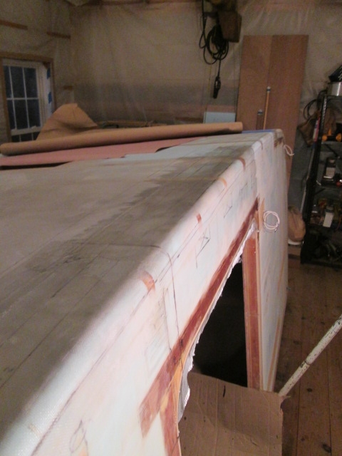

Tonight was 72 when I left work. I stopped by the big orange box to get some more acetone, and I couldn’t help but notice the juxtaposition of the large pile of snow ice as I drove by with the windows down.

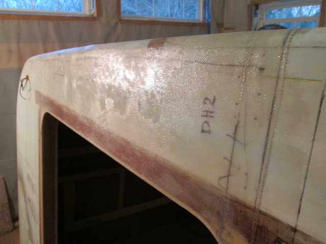

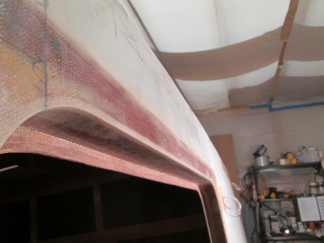

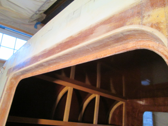

Second part of the routine: trim the bulk of the excess cured glass with the steak knife; scrape the standing edge with the scrapper; touch off the little strands with the small sanding block; sand the prickly bits off the perimeter so that the greenie pad doesn’t get hung up; wash amine with the greenie pad and paper towels; scuff the perimeter well to deglaze; and clean up sanding dust.
I did spend a little time with the block fairing the forward lap seam down a bit, down to the point where some fairing filler should be able to smooth out the rest.

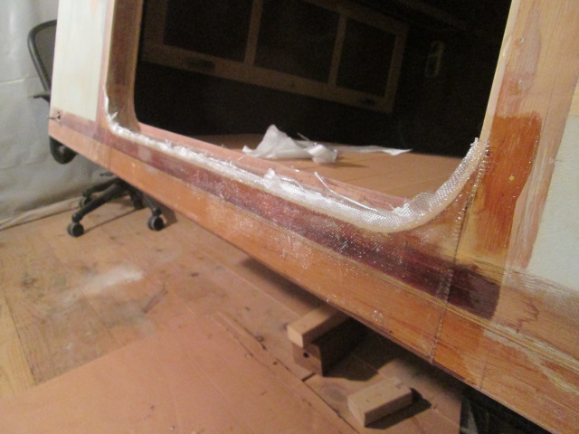

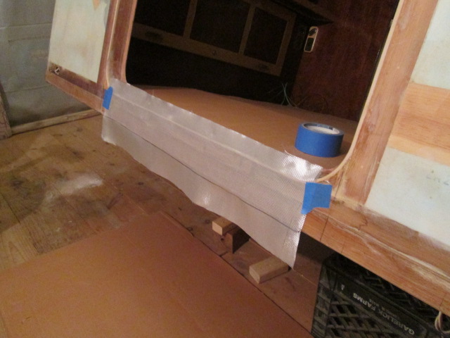

I wanted to get the sill laid up tonight, too, but I had dripped some water from the amine cleanup down onto the cedar sill and could feel that it was still damp. Hmm, let’s try drying that with the hair dryer. Worked a treat! Onward!
Draped the first ply of sill glass over the sill and taped it into position.
Used the cut down chip brush to press wet into the cloth, which went surprising well with few drips to start. Things changed a bit when I started to wrap the flap under. As the wet epoxy started to run down the brush, down my glove and started dripping onto the cardboard drop cloth… making it tricky to avoid laying in the drips or worse, getting it on me… I started to wonder why I had not done this smaller piece wet on wet using the PMPP technique. Next time.
I managed to get through it w/o too much drama and in the end I think this may have been my best layup to date.
