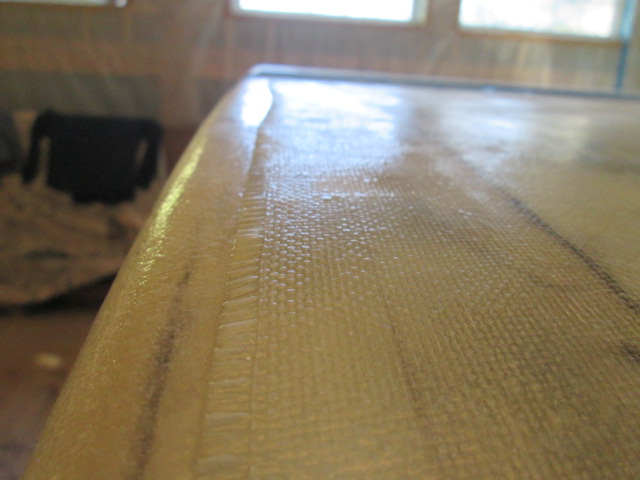

Here’s an example of what we’re dealing with, the somewhat rough edge of the top glass ply where it overlaps the plies that wrap up from the side wall; looks sort of like half a zipper.
Here’s the same area on the curb side after blending the riffle back down to the outer edge. Essentially tapering the area where the 2nd hatch ply became the 3rd overlapping ply.

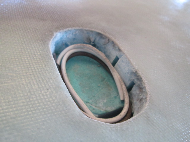

While I was at it I ran a little wad of sandpaper around the edges of the wire recesses for the clearance and tail lights, just to ease the edge and make sure that there wasn’t any thing sharp that could chafe the wires.

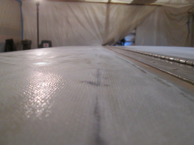

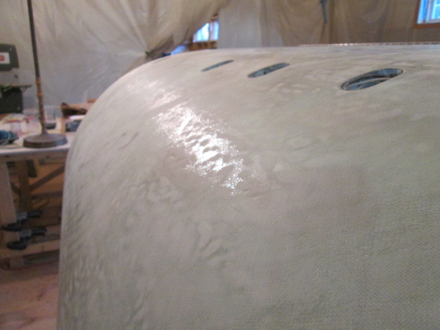

While I was at it I also scuffed most of the surface of the hatch to get a better feel for those ripples and whether they might sand down without burning too far through the top ply. I think I figured out what happened. As soon as I scuffed the area just below the bustle radius I could see the imprint of epoxy drips that had run down from above ahead of the squeegee action. Those drips must have started to gel before I advanced to that area with the wet out, creating slight bumps that didn’t lay down the same, despite it all seeming to be consistent at the time. I figure that the disc roller probably just pressed these slightly cured drips into the foam, which in turn just kept springing back. The good news is that they definitely aren’t air pockets, just resin rich areas, so I can sand them quite a bit before attempting to fair with compound or high build primer. Now that I scuffed them they might show up better in a pic, which I will attempt to take tomorrow.

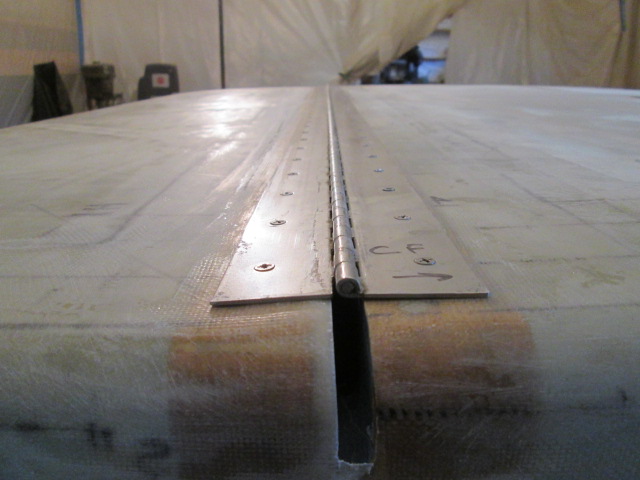

Running out of steam, I picked a little easier task to finish the evening; I peeled the masking tape off of the hinge.
It’s looking like the hinge should be pretty easy to flip. Also, you can see the area sanded along the top to the left of the hinge in this pic. Just a little left to do after the hinge comes off again and is out of the way.

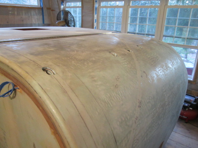

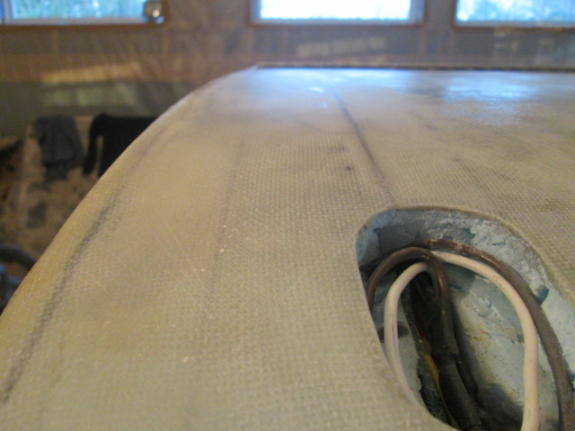

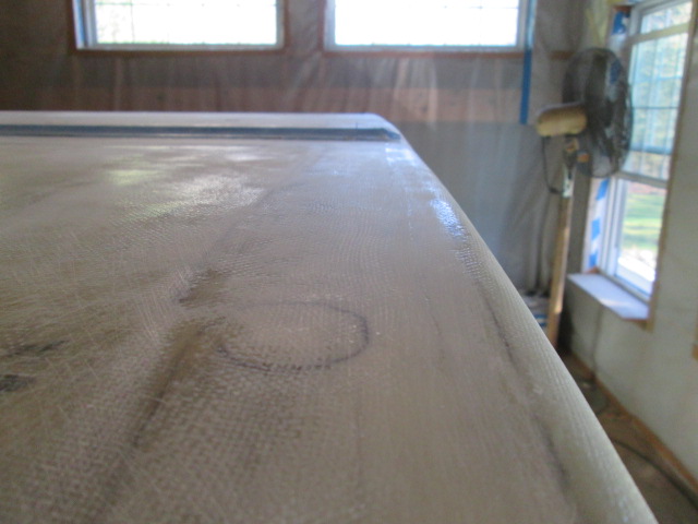

This evening I finished sanding the edge “zippers” on the hatch using the medium board with 36 grit followed up by the other medium board with 100 grit, all working with diagonal strokes keeping the board perpendicular to (aligned straight across) the profile.
Intermixed with this I hit all of those ripples, the bias diagonal seam and the small triangle at the top of the hatch pretty aggressively using the same ‘X’ pattern sanding.

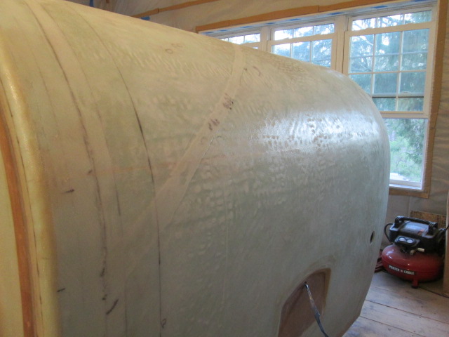

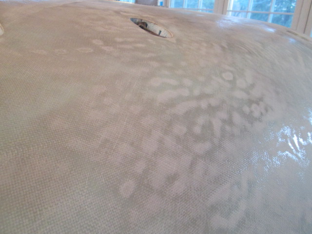

Until I saw this pic I thought the ripples only corresponded to the pattern I had worked to applying the various cups of epoxy, but to see this it almost appears that they correlate to the kerf pattern on the underside of the foam. Not sure how that could have come into play.
A slightly different view, followed by a close up.
Looking back.
The small triangle bulge in the bias ply at the top of the hatch.

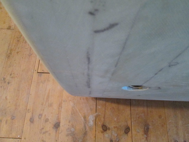

Here’s a shot of the street side, same perspective as last night, after removing the “zipper” edge.
And another one looking down the back of the street side toward the bumper.
