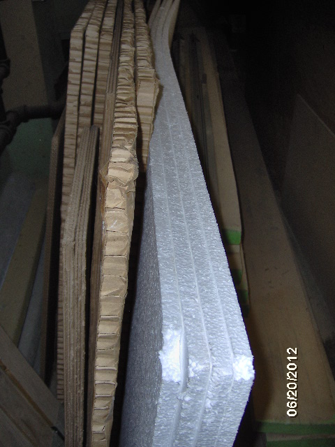

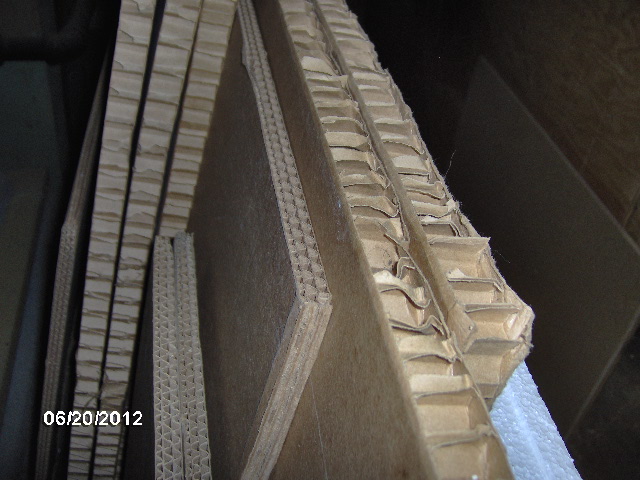

Here's a little something interesting. Bear with me, this is on Foamie/Cardboard topic. So a while back at work they ordered a modular office kit, complete with SIP walls (about 4 inches of EPS white bead foam laminated with some sort of smooth skinned paper board...or maybe gypsum...will take a closer look tomorrow), corrugated steel roof decking, glass windows and steel entry door. The whole thing arrived stacked on a big double size pallet and sat in a pile on the shop floor for a good long time. Well two days after I ordered my XPS foam they decided to install the office and started relocating the pieces. After everything was moved out the materials used to protect everything in transit were left behind. There were 4 pieces of 4x8 x 1/2 thk EPS; several smaller pieces of triple wall corrugated brown cardboard; this honey comb like 1 inch thk cardboard, maybe 1 at 4x8 and a couple at 2 or 4 x 4; and some 1/2 inch particle board. They wanted to keep the wood, but the rest was up for grabs. I had the scrap guy (low guy on the shop totem pole who does general cleanup and small odd jobs) stash it for me to pick up later.
Not sure what I'll do with it, but it gives me some options.

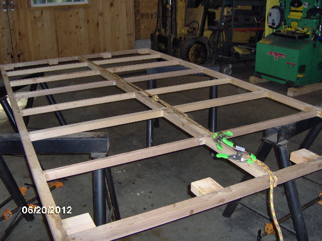

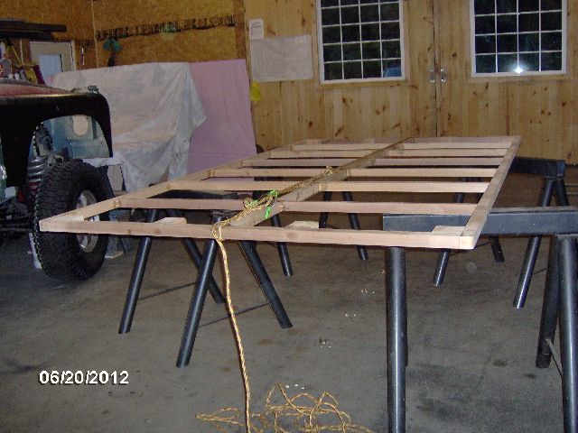

Out at Mecca Karl and I set the floor frame down on saw horses and I got set up to glue in the centerline blocking.
The rope is set up to be a tourniquet like clamp.

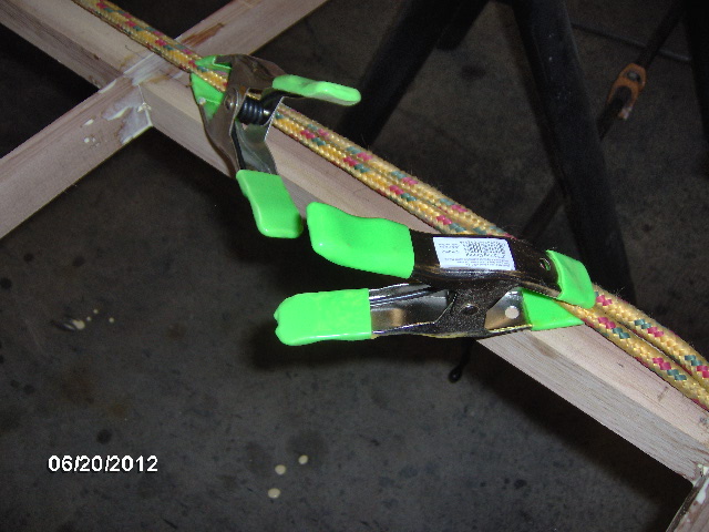

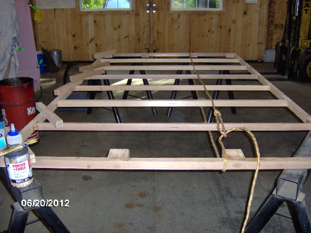

During the glue up we used pipe clamps at each segment alternating on each side of the centerline, but they could only be used minimally because they would try to twist the xmbrs, and they were heavy, putting a little sag in the frame. So once I got all of the blocks in place we cinched up the rope, pulled the pipe clamps off, and repositioned the sawhorses from the ends into the middle some to even out the weight balance and bring the frame back flat again. Used the green spring clamps to hold the rope back on itself. Worked just fine.
Here's a closeup shot of the clamped rope.
And one more of the frame.
