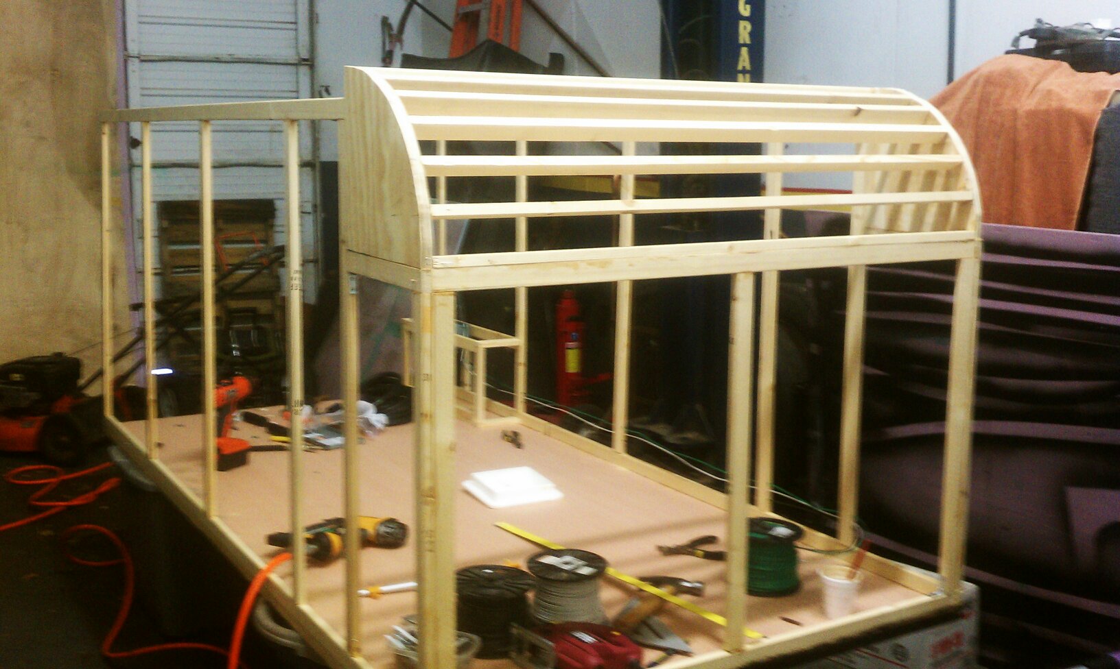

Yeah old days it was called luan but actually now the stores label it as underlayment. Yes lowes has it not quite as good as the home depot versions but I've used it in most of my campers so far and it has worked decently. I have some pics on my phone and I'll have to put them on here from tapatalk and see if they aren't too big to load. I'm only 3 days into it and have the inner walls already going on and side and front walls framed and up so it's going fast. Funny how easy it gets when you have a 4x8 which matches all the standard sizes and reduces cutting and framing down a lot.

Here are a couple from 2 days ago. I'll take some fresh ones today and post tonight.

Wow Steve, 3 days and you're that far along.... that's awesome. I guess it does help to work in that standard 4 x 8 format. I know from experience what a PITA it is to have to cut and measure every dimension since mine is all non-standard. But I suspect your building skills have a lot to do with that progress.
I really want to see the underlayment you're using. I'm using lauan underlayment for the inside skin of my road foamie. It's only 5 mm thick. You said yours come in .5 thickness (Am I right in assuming 1/2 inch?). I'm using 1/2 inch ply for my floor covered with the black goo underneath and GPW's waterproofing formula on top, but it's still wood and I'm still worried. I don't have any worries about wood for the inner skin or any other components of the trailer but that wood in the floor keeps me thinking. In my mind, the next evolutionary step in building these trailers is something other than wood in the floor structure. And although GPW is staying away from plywood, which is a good idea, he's still using wood. It didn't bother me so much as I started building, but as I realize what labor of love and time and materials this is, I'm thinking of some newer type material. Maybe fiberglass, maybe aluminum skin, maybe a plastic composite, maybe.... It's making me crazy. I'm pretty sure it would be a structural panel of some sort. Even at the stage I'm at right now, if someone said here's the newest and best floor, it is structurally strong, water and rot proof and it's reasonably priced, I think I'd be tempted to take my build back down to the frame and redo the floor. I'm haunted by the old saying about a foundation being the strength of any building project and yet the worst material in my trailer is the floor (the foundation). :? :x :shock: :cry: :thumbdown:
