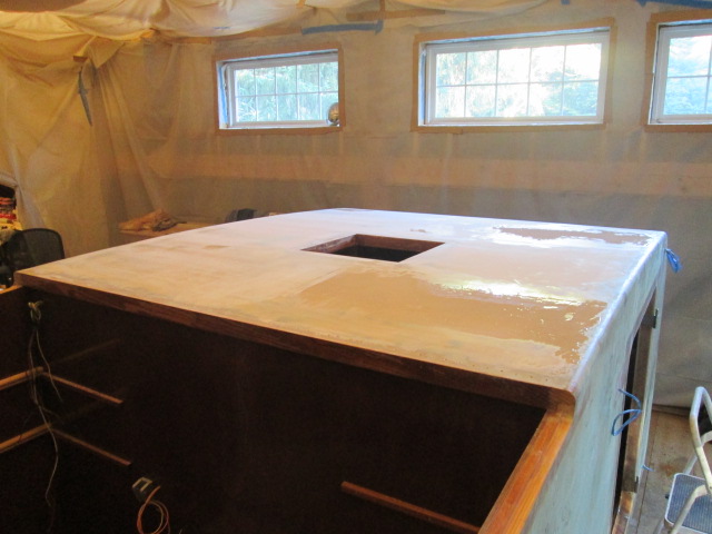

Pictures of incomplete bodywork are boring, too, and don’t really show anything well, but to prove that I have done something…

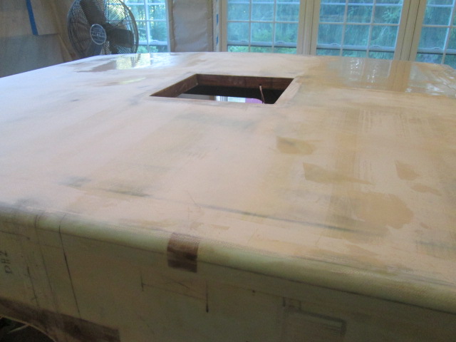

I did the spline drag thing on the curb side with another round of filler, but the middle portion of the roof next to the fan opening wasn’t too bad, so I just did the areas in front and behind.
Here’s something interesting for the record. We all know that foam expands and contracts with temperature changes, but I kind of half thought that the fiberglass would contain this somehow. When I did the spline skim coat on the street side of the roof it seemed like the foam was high and the spars took more filler. That was in 90 deg weather. Now that I washed the amine and blocked it down again in 70 deg weather, the opposite is true; the spars are high and the foam is low, as evident by the darker and lighter strips visible in this pic.

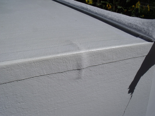

Foam definitely has a different qualities for sure. I think we just have to live with the issues though or it will drive us mad......
This is where two pieces of edge flashing come together. I even at one time cut back the flashing so it did not come in contact. Unfortunately, the only fix would be one continuous piece of flashing, but they only come in 10' lengths so this is what occurs during expansion and contraction. Sometimes it is unnoticeable and sometimes it is worse than what is pictured. I just have to "Let it go!" :roll:
