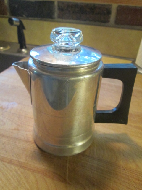

Then I spotted this cute little 2-cup version. It's about 3 or so inches in diameter and maybe 6 or 7 inches tall.
The ad said it was in good condition and looked so in the picture. Apparently I was the only bidder and won it at the opening bid price of $8.99 (…add $12.50 for shipping, ouch).
I figured if it happened to have the same size lid as the 9 cup it would be nice to have both a functioning 2 cup pot as well as a lid for the 9 cup pot. It didn’t work out that way, but that wasn’t a show stopper for me.

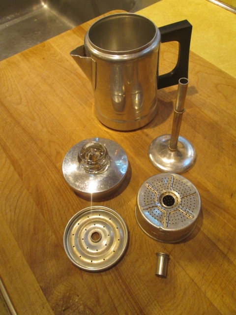

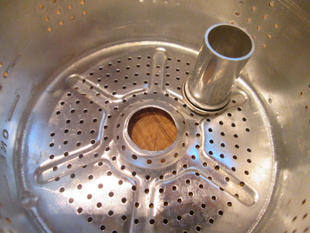

Well it arrived and is in very good condition, except after taking out the packing stuff that was crammed into it for shipping I found that the little stand pipe section that roll crimps into the center of the basket (kind of like a rivet is formed) had broken free.
It would probably make good coffee still, if the grinds don’t slip past this breach in the basket, but for the money it shouldn’t be broken. I have notified the seller and am waiting to hear back.

A little JB Weld ought to fix that right up. The fast setting stuff is good to 400 some degress F. The regular stuff is more like 450 F. Might improve the taste of my coffee. That little 2 cup would fit real nice on a 530 stove.

I wonder if I can anneal the aluminum, uncurl the pinch and reform it back onto the basket.
I could also just turn a new center post with a flange on the bottom and thread on the inside to take a SS jam nut.
But first I think I'll just try it with it loosely assembled and see if it holds the grounds; it may just work fine as is! ;)
Worst case would be some version of cowboy coffee with a few more grounds in the cup.

I'll second the JB Weld......I could go on and on about the things I have fixed with that stuff. :thumbsup: :thumbsup: :thumbsup:
