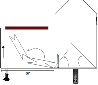

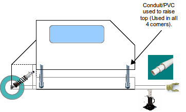

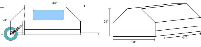

Postby theWolfTamer » Tue May 08, 2012 11:22 pm
So I consulted with my riding friend who's building his own single wheel trailer and took some of your suggestions. I decided I need to focus on something that's small with hard walls. :eyebrows2: Next I gave up on learning the CAD software in favor of something I know how to use: LibreDraw. So now I have :pictures: of sorts. Stick pictures anyway of what I have in mind so it's easier to express.
That's what I got so far. My friend understands what I mean so he'll build the chassis. Note: there should be more stands than pictured. I still need to work on the folding sides idea. :thinking:

Re: Thrifty Alternatives ... Building Foam TDs
Postby GPW » Fri May 11, 2012 5:29 am
WT, please forgive me , but I can’t seem to understand how that’s going to be stable ...being towed ... And it would seem there would be a good deal of stress on the attachment to the MC... I dunno’, maybe you could explain it ...
