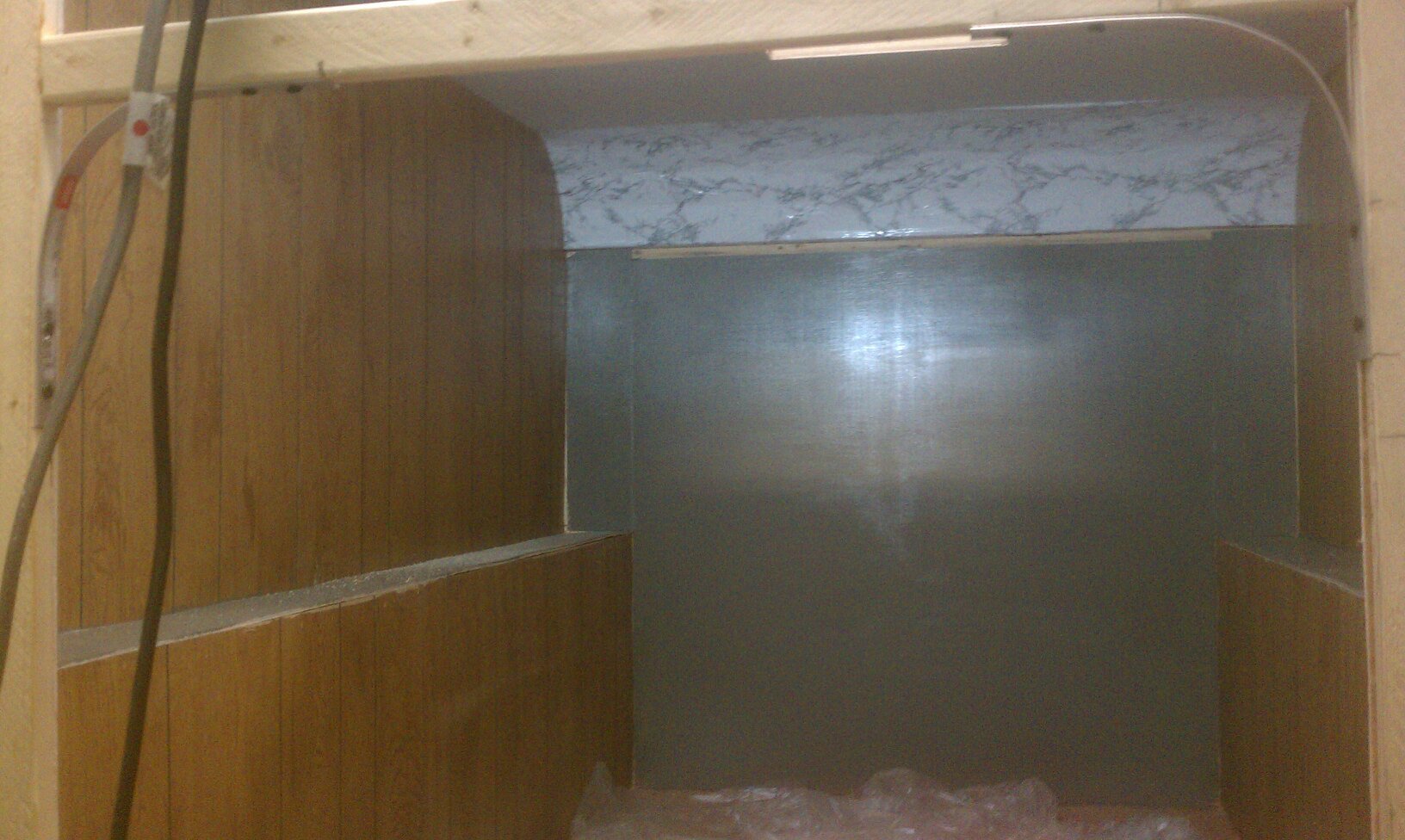

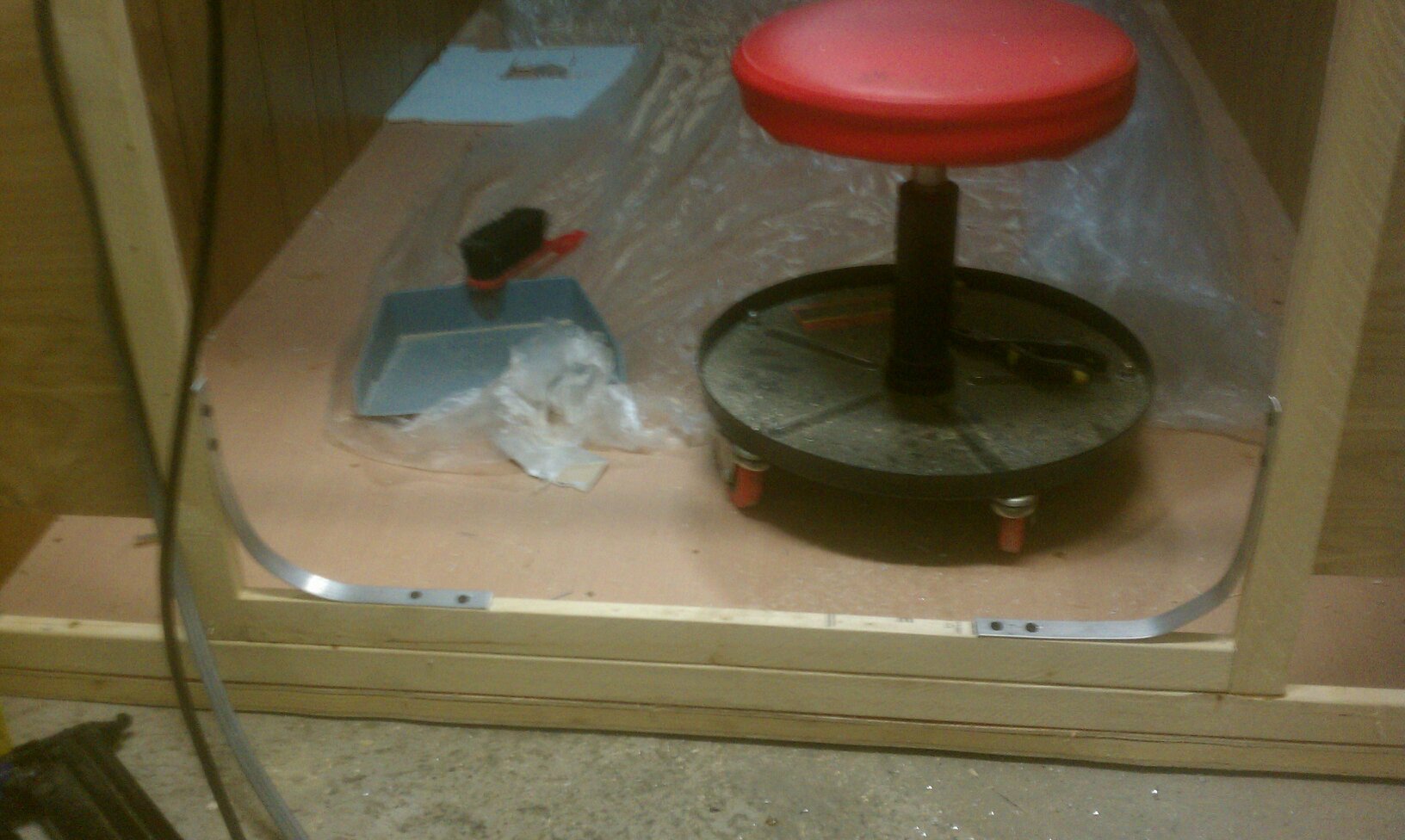

I'm putting this here and the build thread as an added nugget for anyone who would like to know how to easily install the little guy doors frank bear sells. Its taken several installs to get this to an easy quick painless framing and alignment. Get 1/16th aluminum flat stock in 4 ft length. I use 3/4" to match my walls and cut it into 12" pieces. The doors have 3 1/2" radius corners and you frame it 1/4" bigger than the door frame 22 1/4" x 32 1/4". Drill 2 holes on each end of the strip and countersink them and now I make lifer easy for you. Mark 6 3/4" in from corners and that is where you bend and align the aluminum to outline your radius. I cut foam and insert in the corners and cover with luan, aluminum, formica, or whatever I'm using and use trim bit and router the door opening around the frame and metal radius forms.
