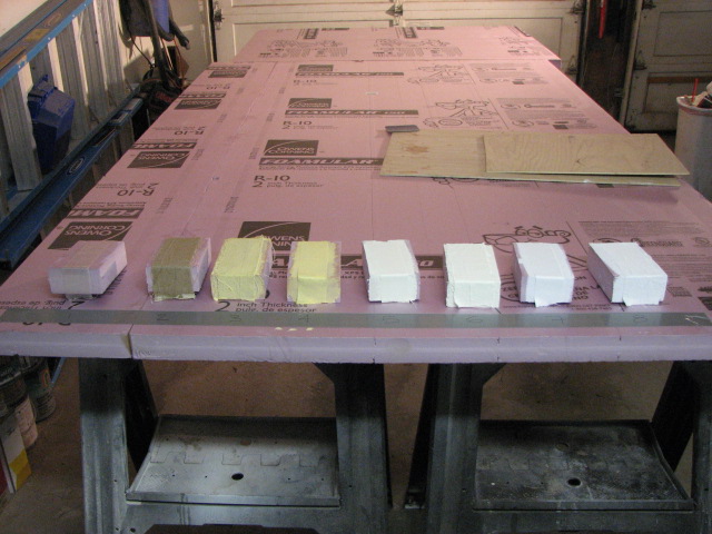

I'm trying to figure out what to cover the foam with, how to "glue" it and how to finish it. So I made up some samples
From left to right:
Fiberglass Cloth with Epoxy, Canvas with Epoxy, Canvas with TB2 (Titebond II), Fiberglass Cloth with TB2, Fiberglass Cloth with paint(Exterior Acrylic Latex Semi Gloss Enamel), canvas with paint, Fiberglass cloth with Kilz 2 and canvas with Kilz 2.
Both the fiberglass cloth and the canvas are heavier than I would actually use. fiberglass is 9 oz cloth, I'd use 2 oz cloth, canvas is 10 oz cloth, I'd use 6 oz cloth. This caused some "wet out" problems. I couldn't get the epoxy or glue to penetrate the canvas well enough so I coated the underside of the cloths before completing the wet out process. Ironically the canvas (which was sold as "drop cloth") was penetrated by the paint and kilz pretty easily. I couldn't get the TB2 to penetrate the fiberglass cloth too easily either so I undercoated that also. The fabric weight also caused some difficulties at the corners. It didn't go around the corner too smoothly and wouldn't stick too nicely. That will probably not be a problem with lighter weight fabrics and I'm going to round off the corners and edges anyway.
I'm looking for a couple of different things from these samples. Which provides the best adhesion for the buck and which of these samples will be easiest to make smooth and create a "gloss" finish.
I'm going to let these all cure for 3 days or so since I won't have much time before the weekend to do anything with them anyway. I'll post my findings at that time, but right now I think fiberglass under paint is looking good

Postby GPW » Thu Sep 15, 2011 6:52 am
Mel , great that you’re doing your own samples /testing !!! :thumbsup: Only way to find out what works best for you ... ;)
Now saying that , it was never our intention to wet out the fabric , but merely adhere it to the foam ... Then the paint/primer would “wetâ€
Postby eaglesdare » Thu Sep 15, 2011 11:12 am
yup what gpw said. hehehe
i used full tb2 generioulsy! i wasn't skimping on this part. then laid the canvas, pull tug. tape in place and let dry. did not even give wetting it a thought. after dried, i then used a roller with diluted tb2 and coated very well, that wetted it. i went over it a couple of times, to make sure i got every weave there was. you will see where you missed spots after it dries, then you can go back over it.
i loved this method because it was so simple and it works.

Postby atahoekid » Thu Sep 15, 2011 8:48 pm
Yeah, GPW, you're probably right about the amount of work. I guess it's a matter of if my desire for a smooth finish outweighs my patience to do the work. I had at one point hoped to get this done so I could do some fall camping in it, but with the late start I got, that won't happen so I now have a project I can work on all winter. I should have plenty of time to do weave filling and block sanding. We'll see if I have the patience to do it.
At some point I guess you also have to consider the cost of time and materials vs. just fiberglassing and epoxy to begin with. Right now the cost of epoxy is prohibitive but ...
Mel
