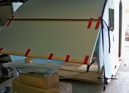

I never meant to show the earlier pics because it wasn't right. I went through all of the old ones looking for something that would show the tilt but none of them show it. Anyway, here is where I was before I took it apart.

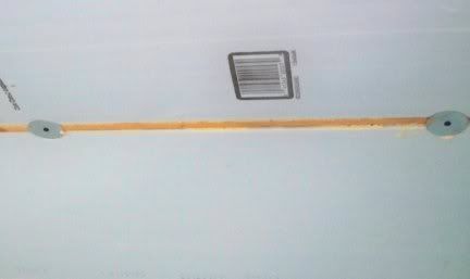

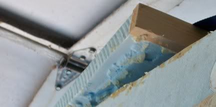

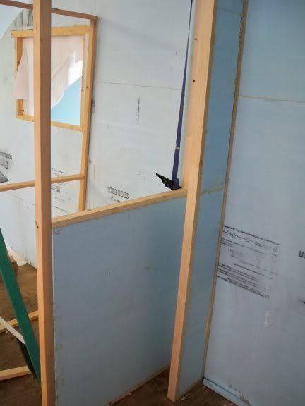

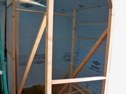

Here is a couple of the bracing that I added after I took the roof off to straightend and support the walls.

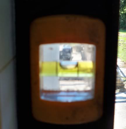

This is of the level on the passenger side wall now. Still a little off but not much. It was about 1 1/2 inch difference between the top and the bottom before I took it apart.
This is how we put the roof on. The wood is glued to one peice and then the next peice it fitted on. The screws and washers are on both the inside and outside to hold it and to keep the roof from bowing until the glue sets.

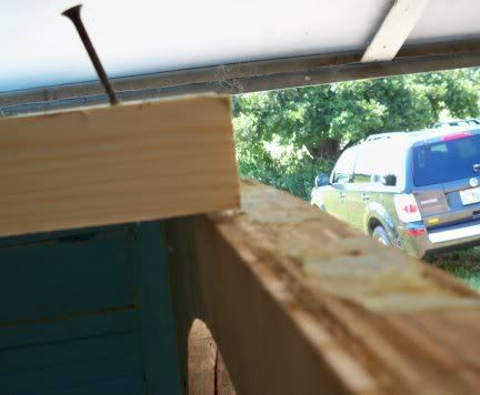

Here is the problem. Now remember these walls have been cut apart 3-4 times so they are getting pretty messy.
Driver Side
Passenger Side
Notice the screw. I used that to try to force the roof straight and attach it to the wood door. All that did was make my walls go wonky again. So I cut it apart one more time.

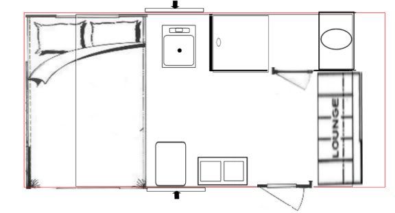

Postby Anita Rae » Tue Sep 13, 2011 2:07 pm
Here is the floor plan for now. But...I am WOMAN...it might change. It already has changed many, many times.
