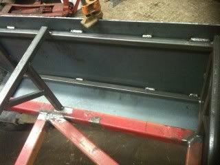

Did manage to get the sub floor framing tacked together:
and fully welded:
Out less than 1/16" over 8'! not bad for single handed with a couple of ratchet straps!

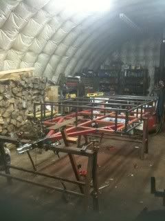

Got the temp coupler done up as well, and the axle mounted. Just need to mount some tires and put in some gussets and I can roll her out and clean the shop! :applause: Then it's time to actually start on the Foam!

Well, it's been almost a month, and I haven't gotten as much accomplished as I'd hoped, but at least the last couple of days have been productive!

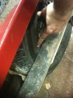

Got the skirt mostly mounted, and all the other pieces at least cut and fitted! Also got the tires/wheels mounted. These weren't plan A, but they ended up being free!
Oh, and since they weren't the original plan....
They don't fit! Oh, well new axle on it's way...so much for thrifty!
Something got messed with the ride height with that tire/wheel combo as well:

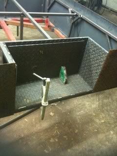

Some heavy metal:
and my "entry step" which is currently 27" off the ground!

Postby GPW » Fri Jul 22, 2011 6:56 am
Looking GOOD DJ !!! STOUT!!! :thumbsup: 27" does seem like a Big step ... :o You thinking about some fold out steps ???

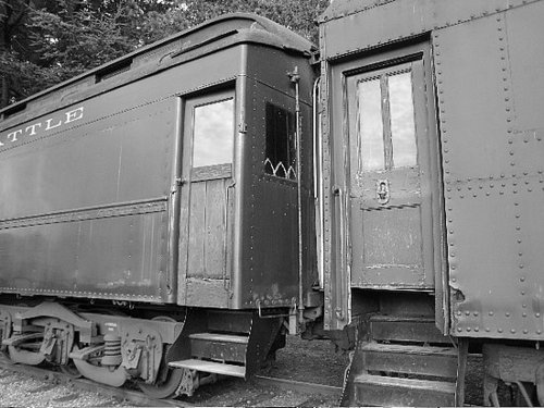

DJ , schmaybe' just weld something up ...??? How about a small fixed step ... or something that would flip down ... like the passenger trains use ??? :thinking: Image

When I was young, a neighbor had a pickup with a slide in camper. There was a flip down step bolted to the step section of the rear bumper. I really don't remember what it looked like, but when it was folded, the top surface of the step rested on the step of the bumper in such a way as to not obstruct the license plate.
