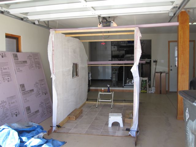

Yesterday we stood the walls up!
We're using some foam scraps to space the tops of the walls, pinned in place with bamboo skewers, while the ribs are glued in place. Today we'll finish the ribs and start the skin. But I have a meeting at noon, and I have to be at work at 3:45, so our time is limited. Gotta go!

There ya go!!!! Looking good. A few well placed blocks, a few pieces of foam and a couple of bamboo skewers and you're in business. :applause: :applause: :applause: It's almost camping season, so get to it... (don't you hate when life (work) gets in the way of good progress) :lol: :lol: :R :R

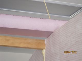

Here you can see our foam stringer and its bamboo skewer bracing the wall while the Gorilla Glue sets (and oozes).

Ps. a serrated kitchen knife will remove those GG drips in a flash ...
yes it does. also i found using parchment paper flattens it out and won't stick to it. i had to use that once when putting a couple pieces together, but did not want it to stick to the ground. anyway parchment was all i had at the moment, and it worked. but on a vertical wall or roof it probably won't do any good.

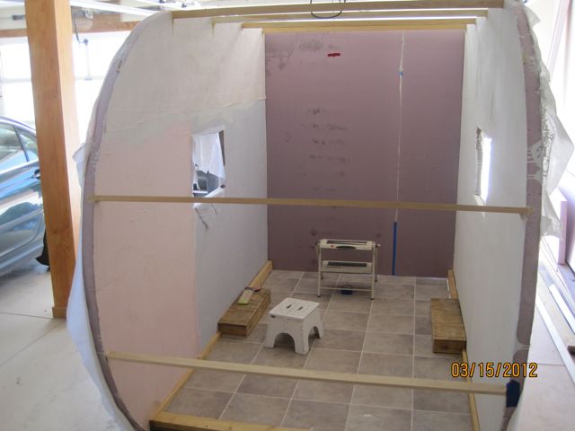

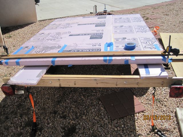

DSD Peter and I glued up the last pieces for the roof panel before he left for his appointments. Then I was alone for the day. My task is to cut out the back wall, and at least rough the door in.
I sat at the kitchen table for half an hour, checking my numbers, drawing little plans, checking my numbers again, and then I decided that if I didn't just start cutting I was going to waste the whole day! So I marched down to the driveway where I am working today, measured, cut, and stood the back wall up against the side walls. WOW! Of course, it needs a door, but WOW!
But the devil is in the details. The driver's side is 3/4" shorter than the curb side. How did that happen? :roll:
Since it is tough to cut a wedge tapering from 0 to 3/4" over a length of 64", I glued a 4" piece of scrap to the top of the wall, and I'll take a bit off both the top and the bottom to square things up again.

Re: It's Started Again! Update 3/5/12
Postby atahoekid » Thu Mar 15, 2012 2:56 pm
That's a good way to solve the problem. I know what you mean about "how did that happen"? I've done the same thing... I try to always remember. "Measure twice, cut once."

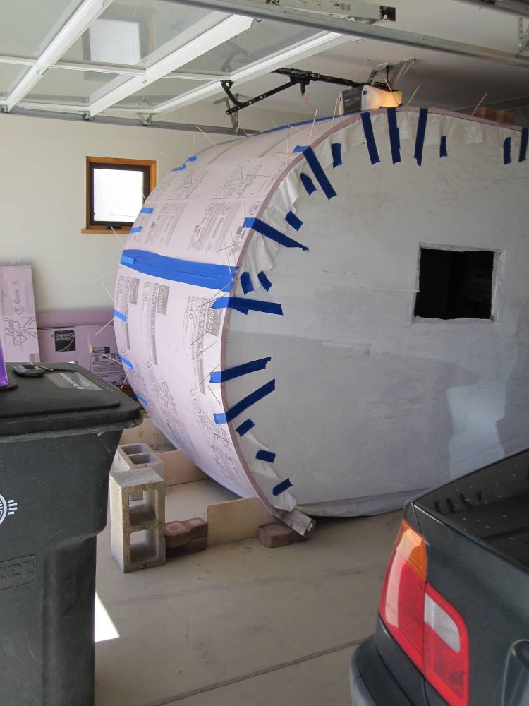

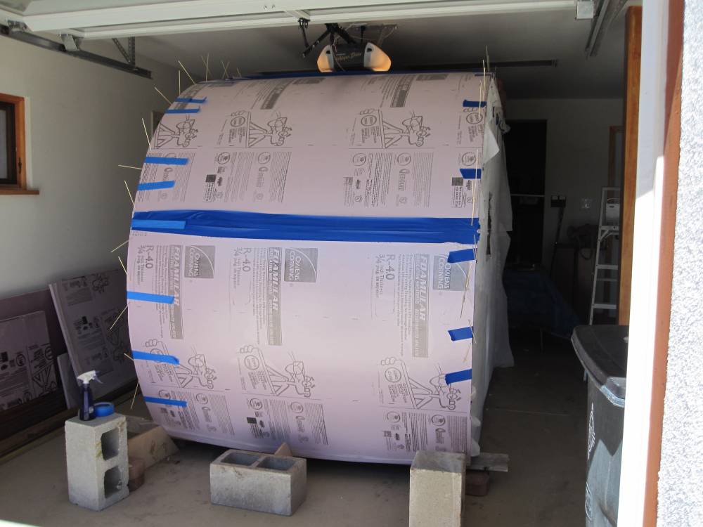

I can't believe how close we are getting! The roof is on!!! The wind was picking up by the time we had gathered glue, skewers, bricks, tape, etc, so Peter showed that he could open the garage door an extra 2 inches, just enough to move the cabin PLUS roof in and out of the shelter. We slid the whole thing back inside and got to work. We put the roof loosely in place, using 1x2s to hold it up off the side walls while we applied the GG. Then, starting at the bottom front, we started spraying both the walls and the roof with water and skewering and bracing it into place. Then we added tape where things seemed to be gapping a bit, and then bricks on the top where it's mostly flat. When we finished, I went back and gave another squirt of water at any place where we had a bit of gap. Peter just looked at it, no foaming yet, and declared that it wasn't working and we would have to start all over again, it was a failure. Actually he was great, not arguing with my build strategy until that moment when he didn't see any foaming, but it was lunch time and we were both a bit tired.
:cry:
It's okay, when we walked back around to the other side the glue was filling the little gaps, giving us (him) hope that it was going to work out!
His next worry is that the glue isn't strong enough. Not to worry, I explained, the canvas wraps over the edges from the walls to the roof, then the roof canvas wraps over from the roof to the walls, and the join is reinforced. We'll be getting proof of concept soon, as a big storm is blowing in on Sunday, and he wants the camper out of the garage so he can protect his second car.
Okay, I was surprised he let me keep it in the garage at all after he got back from his trip. I got an extra week!
