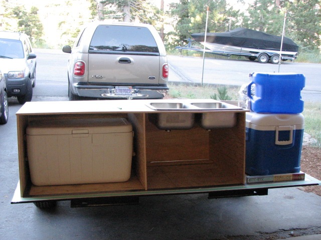

Here's what I managed to get done over the last couple of weekends. I got the floor in, the wheel well pieces cut and the rear counter laid out and cut.
Here's the pics:
Here's the counter from the rear. It's kinda hard to tell but the green painters tape outlines the foam walls. White cooler will be on a slide out, under the sink for now, we're planning on a catch bucket for the sink drains and an area to store the stove. On the right hand side you can see the "beverage" center. The cube cooler, which will become a jockey box and the keg of homebrewed beer (hiding behind the cube and the water container) will be in a cabinet mounted on a slide. There will be an access door on the right hand side. The water container will be housed in the same cabinet but be mounted on a slide which opens toward the sinks. I may still go with a water system with a pump but for now we'll design in the water container. Mostly a $$ thing $> $> If I do, that space becomes a cabinet for storage. Unfortunately, I have to make that decision pretty quick. Once I get the bed platform in, there is no getting to that space without disassembling the platform or cutting an access hatch
Here's the front view. The wheel wells are the support for the bed platform. That platform will extend almost the entire length of the "Road Foamie" stopping at the front bulkhead. The area between the platform and the floor gives me lots of storage space and water tank space. We'll see.
For right now, everything is just leaning on everything else. Only the side of the wheel wells are attached to the floor. Getting everything assembled and attached will be my project during the week, but since I will be on a business trip for part of the week, we'll see how much I get done. :thinking: :crazy:

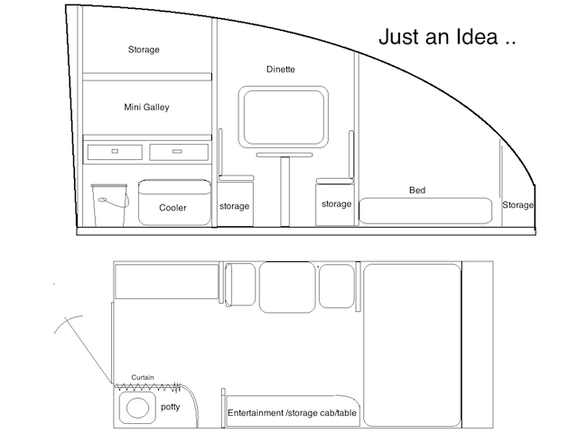

Postby GPW » Thu Sep 01, 2011 9:19 am
Rat , all joking aside , I Do like the shape of your TD ... I guess it tows easily (aerodynamic) ?? Makes sense really !!! Triangular -ish' just gotta' be STRONG !! Would make a Nice Big Foamie huh ? ... :thinking:

OK, running with that idea ... Image :o
