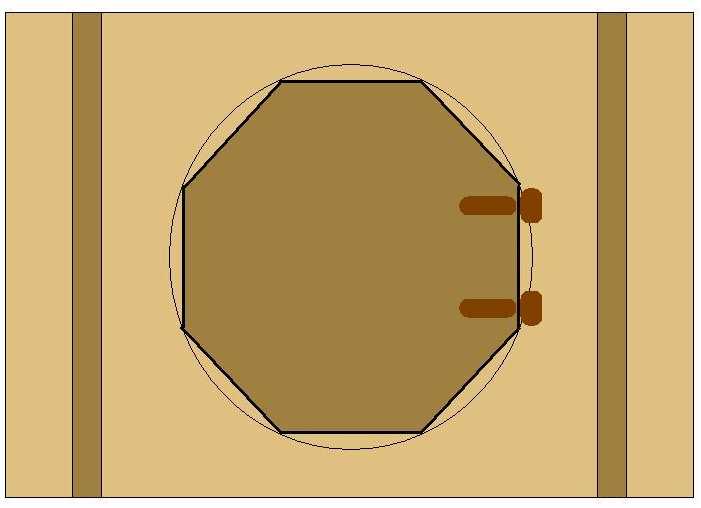

plan "D", the Octagonal hobbit door. that way you have both the edge (hinged side) and the bottom flat... (for your more progressive hobbit types.)
(yah kno, you give us a chance and we'll evolve that thing clear into the next century. ;-)

There ya’ go !!! That’ll work !! :thumbsup:

Carrying PcHistorian's octagonal suggestion, just a bit further - you could
frame the opening and the door octagonally but still have a circular outer
skin for the door, by making that large enough to obscure the framing.
That'd give you the round exterior look and a somewhat easier door framing
experience. That, or GPW's arch door style suggestion with a round overlay
to show as 'the door,' with the bottom portion painted to blend in with the
body and not look like part of the door, would probably be the easiest ways
to the round hobbit door look and build.

with foam, you are only limited by your imagination.
you could paint it round, just square the hinge and the bottom, make the other edges round.
you know come to think of it, you could extend the round door slightly below floor level, but have that not show unless the door is open. then you'd still have your flat climb-in point. I don't know of any advantage to doing that, unless you wanted to store something under the rear of the floor, like thin water tank (grey water, easy to reach), pull out table storage, step-up, skid pan, ground foot. You could recess the ground foot for the center back, with a slight overhang to hide it, then have the door come down a bit. Just reach up under to drop your ground foot.
(you'd still be back to the square at the hinge. you can do the hinge edge square and paint it round.) I'll get a picture up here after a bit. (easter going on around here somewhere...)
We still haven't gone to an oval door yet, or like a race track, round top and bottom, bit of straight to the sides... (hinge, latch)...
