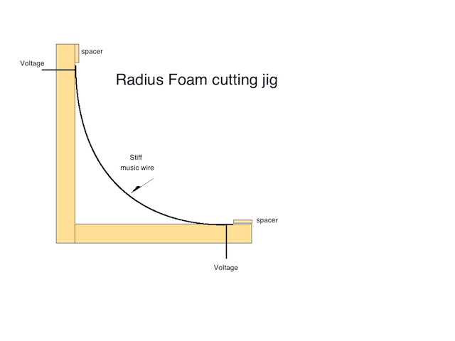

Postby mikeschn » Sun Jan 29, 2012 8:10 am
Do you have any examples of wire cutters that can cut a roundover?
Mike....
Postby Larry C » Sun Jan 29, 2012 10:25 am
mikeschn wrote:Do you have any examples of wire cutters that can cut a roundover?
Mike....
I would like to see that also. It seems the only way it would work is with a piece of thin stiff flat material. It would keep it's curved shape, and wouldn't bend like round wire especially on a large radius.
We have these at work (see link). I think this would be stiff enough for a roundover cut, but I don't know how much current would be required to heat it enough. These are 1/4" wide, but it looks like there is also a .177" width. They are very thin, and would cut like a knife .015" thick.
It could be formed to shape similar to the Ohms Symbol, but with the legs further apart formed to the desired radius.

Postby allan1 » Sun Jan 29, 2012 6:53 pm
Mike....
This should do the trick simply (found on internet).
allan1

Postby mikeschn » Sun Jan 29, 2012 9:14 pm
Mike....
That looks good. Tell me where I can get that wire... and of course, please tell me what kind of wire that is...
MIke...

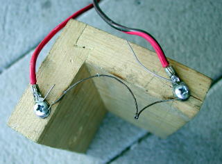

Postby GPW » Mon Jan 30, 2012 6:59 am
Postby GPW » Mon Jan 30, 2012 7:16 am
Here’s another take on a quickie HW foam cutter ... http://www.rcgroups.com/forums/showthread.php?t=1244763

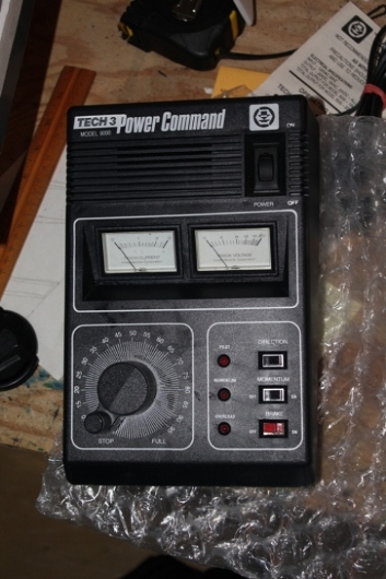

Postby allan1 » Tue Jan 31, 2012 12:40 pm
GPW thanks for the link. Bought a power supply on ebay and it's on its way! Found my beginners website - uncomplicated info about power supplies, tool plans, wires, good video links, etc. Time to start building a table and tools.
http://hotwirefoamcutterinfo.com/Hot_Wi ... ction.html

Postby allan1 » Fri Feb 03, 2012 2:33 pm
just came in the mail ... TEC 3 Power Command 9000. Output is 20Vdc, 19VAC, 20VDC - all no load ratings. I'll have to find out what that all means. And it's got dials, switches and meters .... ohhhhhhh

Postby GPW » Fri Feb 03, 2012 3:19 pm
Looks Cool ... dial in the Heat ... :thumbsup:
