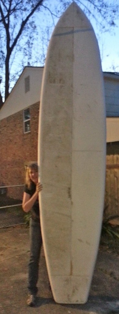

Wendy just sent me a pic of the second board they got shaped after I left yesterday evening ... looks like some surface sanding to clean it up a bit and it’s ready for covering ... :thumbsup:
Between you and me , this is really pretty EASY !!!! :roll:

Postby eaglesdare » Thu Dec 13, 2012 12:14 pm
wow, that thing is huge! but way cool! :thumbsup: :wine:
