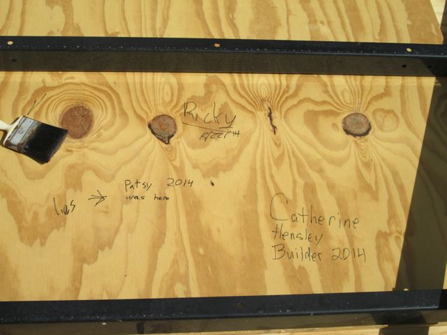

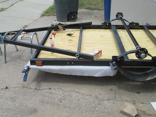

Okay, the kids and I flipped the trailer to apply the wrap to the under-side. While it was upside down, Patsy declared that we needed to sign our work.
:woohoo:
Here is the wrap, it will go up about 4 inches on the outside of the foam walls. I glued it with TBII, but the foam gets glued down to the deck with the standard GG.
Back right-side-up, here's the floor waiting for the cabin to be installed.

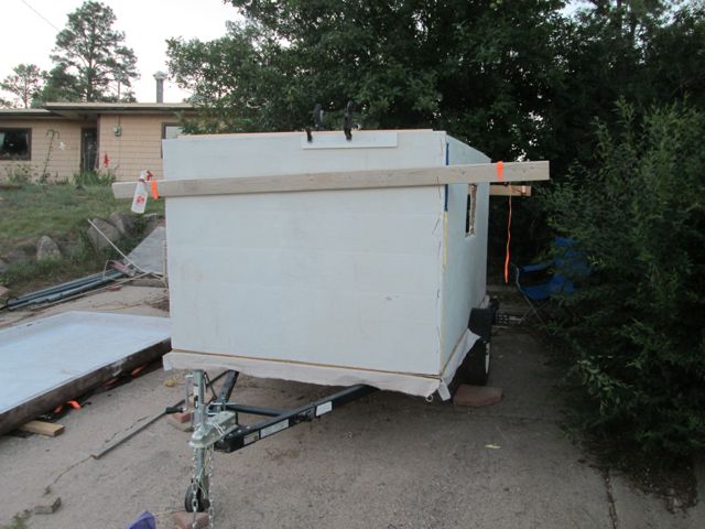

Oh, yeah, there it is! :lol:
:phew:

That's a neat idea, gluing the canvas onto the bottom first! Takes care of the problem of accessing the underside, gets it done while it's easy-before the walls are in place. 8)
