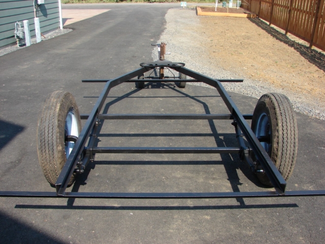

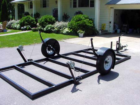

I am sorry to say this but the complete and utter rebuilding of a HF frame to make an open floored standee is just way off base.
You would be far better to invest in a frame design that utilized single independent shaft axles
http://www.northerntool.com/shop/tools/ ... sion-units
and avoid the single axle running across the floor. As to the tongue let the side rails blend together and join to become the tongue and coupler ( see pic below)
This all could be done with rather light weight structural square tube. With a little thinking you could deepen the sides on the frame and have the upper body slip over the lower making a hi - low design that would help towing drag and storage constraints.

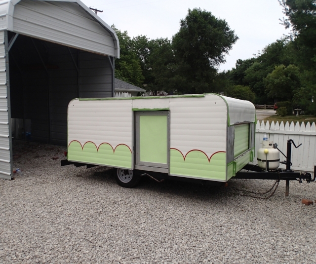

Here is a vintage hi - lo trailer

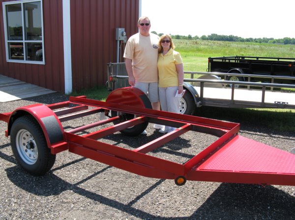

Here is a much more practical frame design.............
see how the main side rails blend to form the tongue. This one still has a cross axle but it has a nice drop to help step down the floor.
All of the floor support is also under slung beneath the main side rails and really could be dropped even a bit further.
This is more of what you are looking for in my opinion !

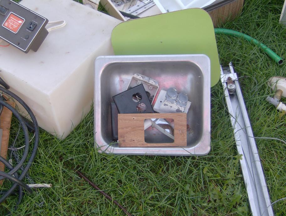

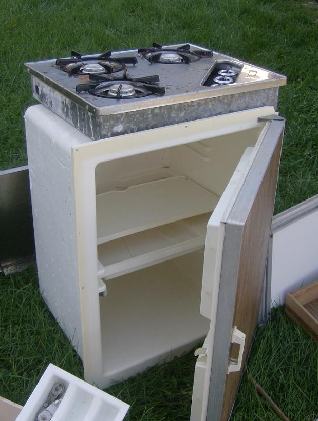

I have been able to pick up abandoned and un loved little canned ham style trailers for under $200.00 on 4 or 5 occasions. I just stopped and asked !
here is a $50.00 one
My 8x20 caboose frame was a tow it away (please just tow it away)
So do some road work and look for a likely candidate. Crawl under and check out your new frame. Often you can get other great stuff like stoves , sinks , electrical goodies, heaters , and on and on.......Image
