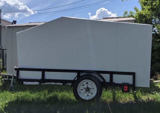

Started the build today. Took advices from most so far. Slight slope at the front and another one towards the back. Hopefully it will help for the drag etc. Will round edges as well.
Using what is available from the local store. No TBII in sight. So ran some tests with Elmer's Probond Max which is waterproof. Stick well to EPS.
I will try to take pics as I go. Tried to upload a picture but that ain't working for me. Will have to study the How-to's on photo uploading.

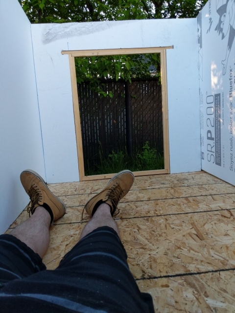

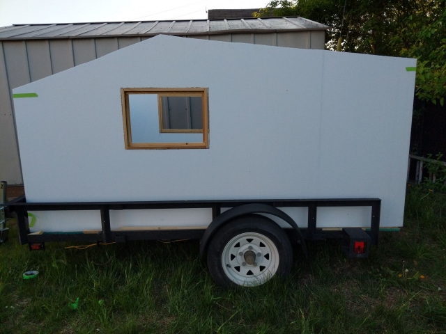

Eh second day working on the small foamie. Did cut a few more panels, made openings for windows and doors. Built the door frame and window frames.
I realized that I may have went a bit heavy on the "mix". OSB edges thickened quite a bit.
Pictures below. Walls are not glued to each other. I was just a bit curious to see how it would look.
Tomorrow I will cut 2 pieces for the roof and will glue window frames and door frame to the foam.
