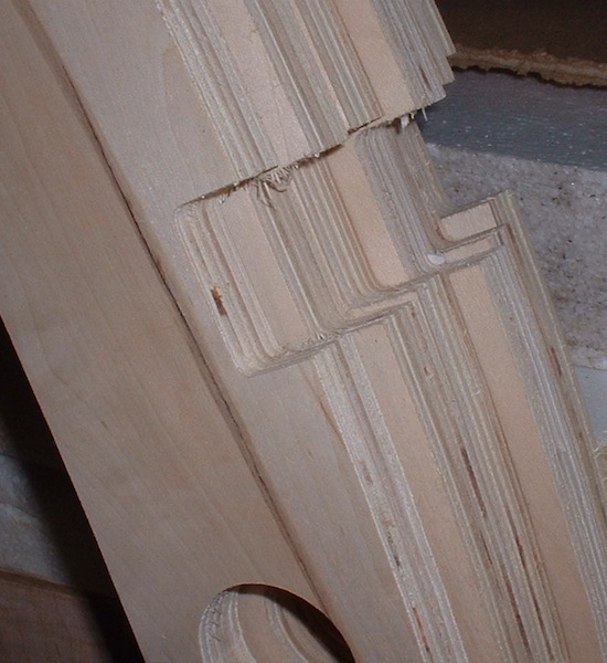

Back to this project ... we keep having trouble finding the stringers ... Everybody has 1X2 furring strips in 8 ft. lengths ... Nobody has 10 ft. :o the local lumberyard has offered to rip some 10’ 1X4s and make me some , but unless their cut is Exact they won’t fit the rib notches without some “modification” . grrrrrr!!!! The notches were machined out to exactly fit the common “1X2 furring strip” , which would be perfect if I was building an 8’ trailer . :oops:
The question now becomes do I butt join the stringers on the last 2’ section and just stagger the joints , or do I join the strips with something more exotic like a half lap joint, metal mending plates, center hardwood spine insert ... ??? :thinking:
The 3.5” thick foam goes over all of that and the skin over everything ... Should be strong enough eh ? Got 10 stringers plus the 1X4 top rail (full length), 6 ribs ... Schmaybe’ I’m “overbuilding “ ... :roll:
Re: FoamStream...
Postby KCStudly » Mon Apr 22, 2013 3:11 pm
Half lap and stagger them end for end sounds good to me. :thumbsup:
Re: FoamStream...
Postby GPW » Mon Apr 22, 2013 4:16 pm
OK, I can do that ... Thanks !!! :thumbsup:

Here’s my “thinking points" ... the stock 1X2s fit exact into the CNC cut notches ...(see pic) The slight radius left by the cutter at the bottom of the notch fits exactly the standard (rounded edge) 1X2 ... If I cut some full length ones , I’ll have to either round the edges to match (bottom side only ) , or worse cut the notch edges square :frightened: Not really a problem , just more work ... Got 11 of em ... and they HAVE to be cut Exact width to fit ...
Not that half lapping (or scarfing ) some shorter ones together isn’t a lot of work ... The half laps would coincide with a rib notch ... ;)
The most strength would be with the full length ones , but I don’t think it’s THAT critical ... Just the frame/skeleton alone should be pretty Strong , add the 3.5” foam , a skin ... and the strength of the tube shape , and it should be a lifetime (my lifetime) proposition.. barring Bears and frozen turkeys , of course ... :o
So you see my dilemma ... :thinking:

Just get the spars ripped from a better quality 10ft 2x10 or such
and where they coincide with the ribs just use a hand wood file-rasp
to round over that location at the rib to fit. There is no need to round
over the whole length - just fast sand the edges enough to knock off
the sharp corner so it doesn't hurt to handle them - one or two fast
passes with a foam block sander for that. Of course if you have a
router with a round-over bit that'd make it easier too. From my
experience, finding a "good" 1x2 or 2x2 is very rare. Cutting down
the larger dimension plank is not guaranteed either but if you pay
attention to the grain/growth rings it can work very well. No need
to do scarfs or half laps and the time it'd take to do them.
Just one way to look at it...
