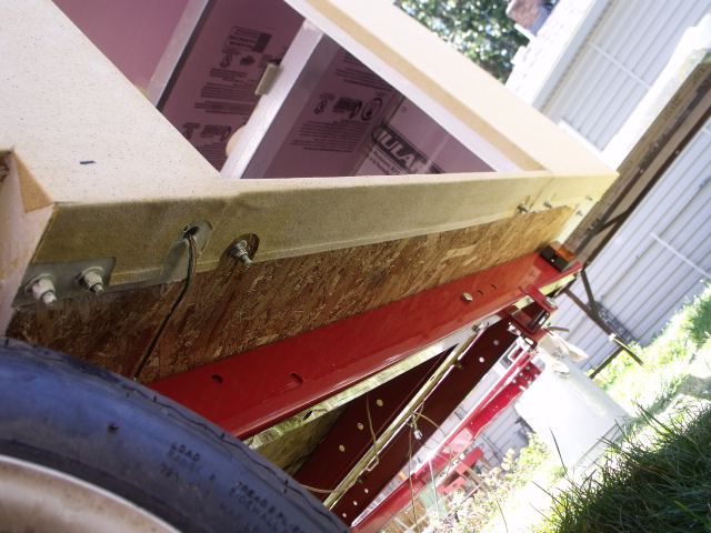

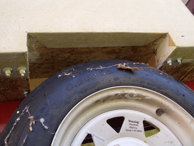

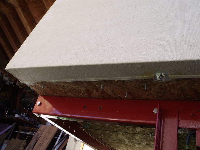

Postby ghcoe » Sat Sep 26, 2015 7:29 pm
Then of course the worst part, the bottom.
Bottom
Bottom #2
Bottom #3
George.

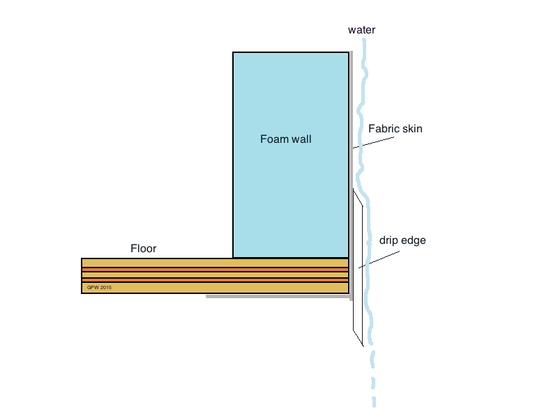

Postby GPW » Sun Sep 27, 2015 6:41 am
Just a thought about protecting those Neat edges .... the floor to wall join and under is an area that seems to see and collect a lot of water (around here anyway) ... and the canvas under the floor MUST be completely and thoroughly saturated and waterproofed... as well as the “reinforcing strip" underneath it (or on top) ... Current thinking is we would be better off with some kind of really simple drip edge that would channel any water down and away from the bottom of the floor ...
Any ideas about that ??? :thinking:

Re: #1
Postby GPW » Sun Sep 27, 2015 8:17 am
I’m just trying to think of something Simple ... :thinking:

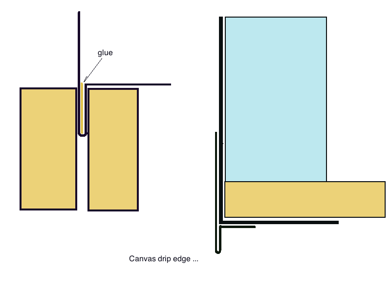

Postby GPW » Mon Sep 28, 2015 8:09 am
Thanks Guys , you inspired me to re-visit this idea .... a Canvas drip edge :o ... I can either glue or sew a fold onto a piece of canvas, and just glue it over the other skin ... Simple , but It would seem necessary to completely WATERPROOF the completed assemblage .. Cheap, flexible , and easy to replace ... Not difficult to make , perhaps gluing between two wooden blocks as depicted. :thinking:

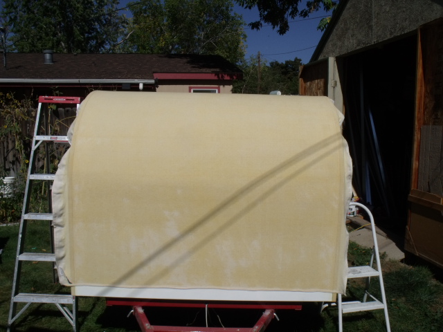

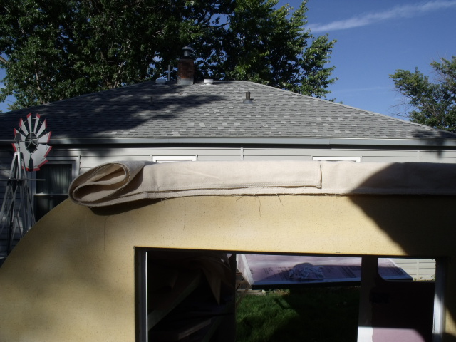

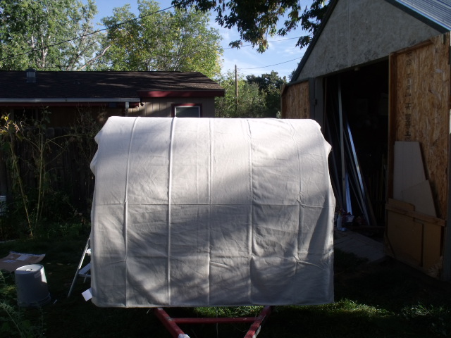

Postby ghcoe » Mon Sep 28, 2015 9:29 pm
Did not get time to update last night.
I got the canvas draped over the top and allowed for shrinkage of about 6".
Draped
Then I folded the canvas up in about 10'" folds so I could unfold as a went.
Folded
Worked fairly well except once I got to the curve in the roof I realized that 6" allowance at the bottom was not enough :roll: . Too late now, so I finished it out. Should have allowed for 12"
A little short
George.
