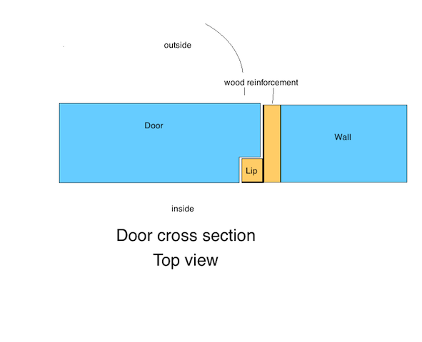

Postby GPW » Tue Mar 01, 2011 12:53 pm
Eagle , I used a piano hinge from the hdwe. store on my Big TD build , my Tiny CT has em too ... they seem to work fine .... Curious to hear others hinging preferences...
Also thinking to recess the door with a lip inside , so it seals better (rainy here) ...sorta' like an ice chest lid does ... just a thought ... would only take a tiny bit of extra wood 3/4"X 3/4" to do it all around ... Need a picture ???

Postby GPW » Tue Mar 01, 2011 1:07 pm
OK.. see if this helps ??? Image
