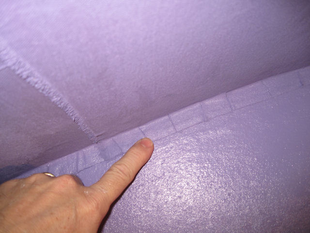

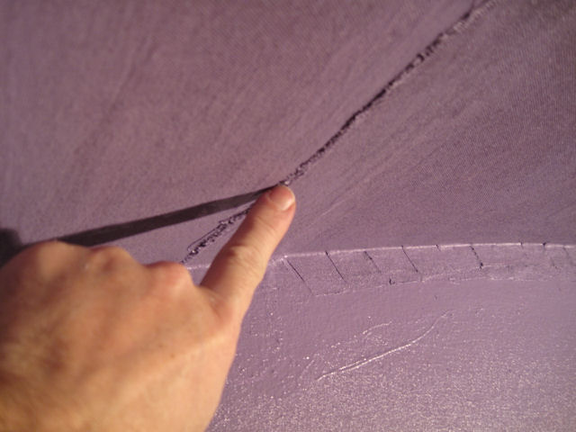

Tell me how you did it. Chell tried to hang a piece of canvas this morning, and gave up in frustration, ripping the canvas down and throwing it away.
So I tried. I quickly realized that the latex enamel paint wasn't going to hold the canvas up without some help. So I dug up some stick pins. Relief! Using stick pins every 12 inches or so helped me keep the canvas in place until the paint dried sufficiently to hold the canvas in place!!! The stick pins became even more important, the more overhead we were.
Nearing the home stretch. This morning I thought I could crank this out in a few hours or so. The reality. It took all day, many beers, dinner out... But I gotta tell you, once the paint dried, the canvas was definitely stuck to the foam. There was no pulling it down!
It was a royal pain in the a$$. I really had to get in there and work the paint. Here's the proof!!!
