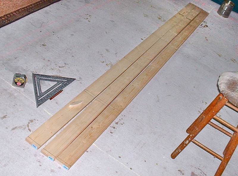

Postby GPW » Wed May 08, 2013 9:11 am
Progress this morning ... Got the cross members all marked , measured exact and ready to cut to length and bolt down ... Hey ,it’s a start ...

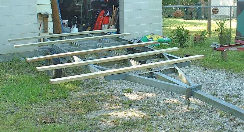

Found out we have 13” rims (4 hole) and that clears the floor by ~2” , probably with a 12” rim I could use regular trailer fenders , and not have to build wheel wells inside the cabin... :thinking:

Postby GPW » Wed May 08, 2013 10:50 am
Top plate and two bottom plates measured and marked ... remarkably everything fits like it’s supposed to .. 8) 24” on center ... Falling together now ...

Quick question in this pic:
Are you going to have more crossmembers to support the rounded nose section or just fur up the frame ?

Re: FoamStream...
Postby mezmo » Wed May 08, 2013 11:56 pm
Hi GPW,
If you put the 2x4s on edge, not laid flat as shown, will that give you enough clearance ?
They'd be stronger that way too - important as you are cantilevering the floor off the
main frame. [I'm also assuming they have not yet been cut to the width's length yet,
correct ?]

W2, Thanks , I’ll need to add another short crossmember where the nose attaches ... and a few spacer blocks ... Putting the ribs together should be fairly easy ... if I can get some help to just hold things while I nail and glue it together ... I did borrow a pneumatic brad gun to help , that should make it much quicker ... :thumbsup:
Norm , laying the X-members flat works best for me , makes floor attachment much more secure (easier) even though it’s T&G edges . ...I’m using “clear and dry” treated Pine cross members which seems very strong , and there will be enough of them to provide enough strength for the light cabin structure ... The overhang is 11.5” on each side (3.5” of that will be foam ) , and will be further reinforced by attaching the OSB floor , so I’m not worried about the strength ... and yes , I need to get out the chop saw to cut them to length ..

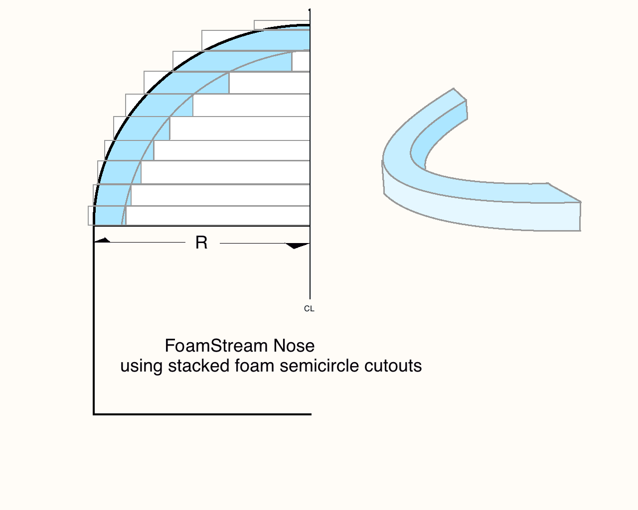

Postby GPW » Thu May 09, 2013 9:19 am
Figured out a way to make the rounded nose cone using stacked foam semicircles , then just sand out the terraced surfaces. The Semi circles would gradually get a smaller and smaller radius as you get to the top . All measurable off the initial 36” Radius (on mine ) , and allowing for an inner thickness too ... Easier and probably more accurate than just carving a big solid block ... that takes a little skill to get perfect :roll: stacked rings , even Grandma' could do that ... :thumbsup:

Postby bonnie » Thu May 09, 2013 1:00 pm
GPW wrote:Figured out a way to make the rounded nose cone using stacked foam semicircles , then just sand out the terraced surfaces. The Semi circles would gradually get a smaller and smaller radius as you get to the top . All measurable off the initial 36” Radius (on mine ) , and allowing for an inner thickness too ... Easier and probably more accurate than just carving a big solid block ... that takes a little skill to get perfect :roll: stacked rings , even Grandma' could do that ... :thumbsup:
I really like that idea. Had a similar one for mounting my round door. Very cool idea. :thumbsup:

Postby GPW » Thu May 09, 2013 1:51 pm
Thanks Bonnie , it was the easiest way I could think of coming up with that rounded shape ... The original idea of just carving a big ole’ block of foam seemed too difficult for most people , and extremely messy ... :frightened: This way i can just draw the half circles on the foam sheets , and cut them out roughly with the hot wire .... should end up pretty close to a smooth round nose ... depending on that as the trailer will sit some 8’ off the ground :o ... the round nose in the oncoming air behind the pickup truck ... Should tow OK ... :thinking:

Postby KCStudly » Thu May 09, 2013 3:17 pm
That method looks good.
I would definitely glue them all to each other first, just dry fit to the camper frame, or leaving a long edge to trim to fit later (before gluing it in place) so that you can flip it over to carve (hot wire?) out the steps on the inside on the bench, rather than having to do that step standing on your head.
