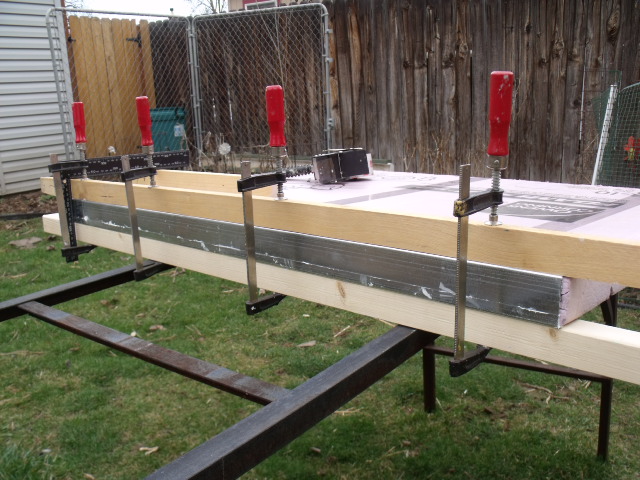

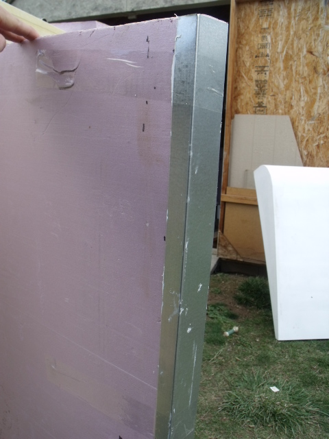

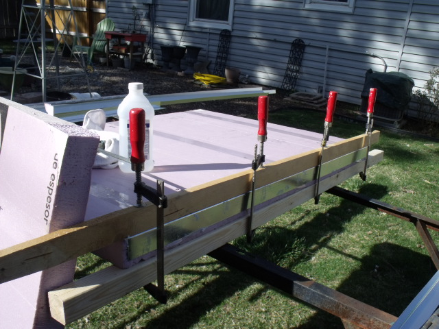

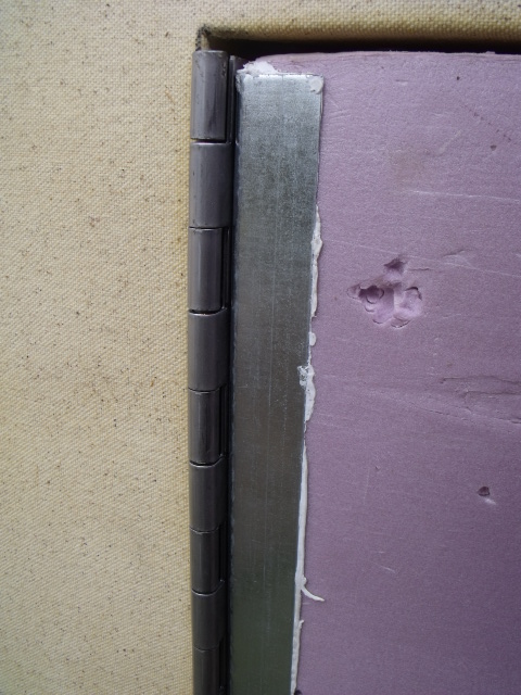

Well I had to rethink how I was going to frame the door. My earlier attempt did not allow for any adjustments if needed. So I rethought the approach and figured I would attach the hinge side first. That way I can attach the hinge and then make adjustment cuts to the other 3 sides if needed. So now I am attaching two pieces of 1"x1" flashing, one to each side of the hinge side of the door. This allows the flashing to overlap, but not bind on each other. This was another problem I had with the first attempt with 1"x2" flashing. Usually it is not a problem, with the door though, it made the edges too thick to fit in the door opening properly. This caused the door to protrude out farther than I liked.
Gluing the hinge support #1
First piece glued
Gluing the second piece
George.

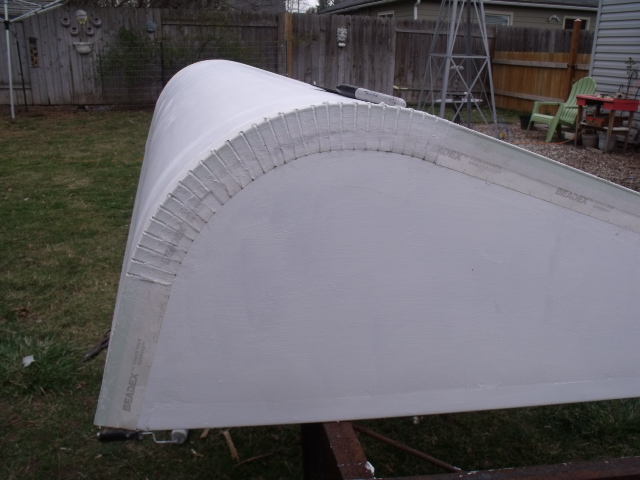

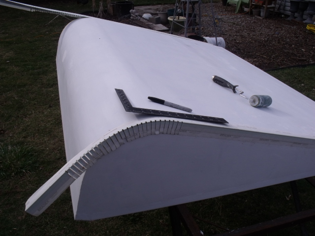

Started to fair the hatch. Got nearly done when I realized I had not installed the last of the hard edges. This is what happens when you go long periods without working on your foamie. So stopped to install hard edges. Only had one made so I had to make the other one. Luckily I did have beading on hand so I must have known I needed it at some point.
Installing the hatch hard edge
Fully glued
Have to wait for the caulking to dry and then I need to finish up the fairing and then it should be ready to install.

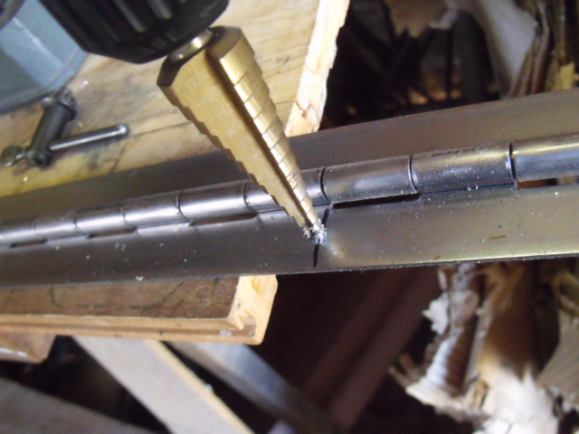

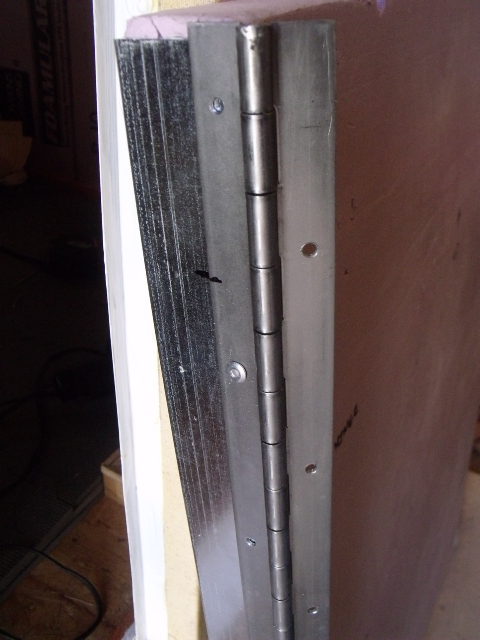

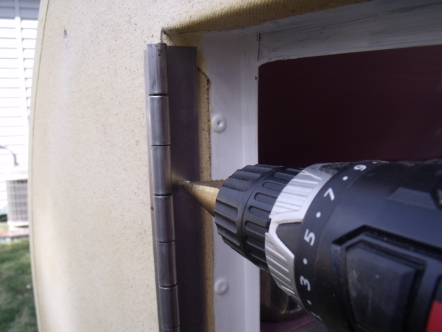

Had to cut the hinges to fit and drill holes for the pop rivets.
Drilling the holes
Had to temporarily pop rivet the hinge to the door and then drill out rivets so I could pop rivet the hinge to the door frame.
Drilling door frame for rivets
Both attached
This allowed me to get the door hung properly the first time.
George.
ghcoe
Posts: 1982
Location: SW Idaho
Re: #1

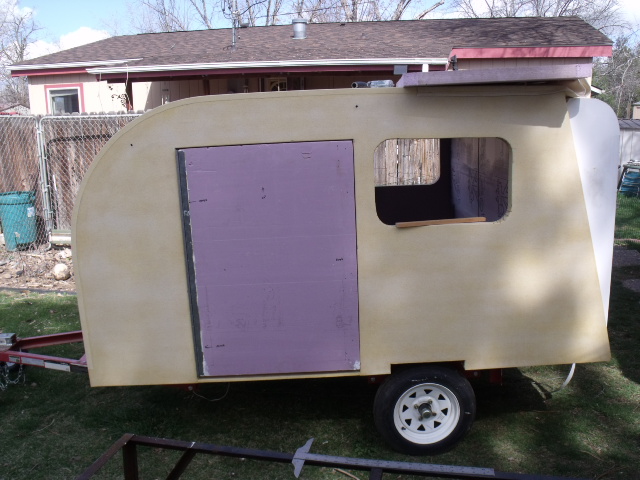

Postby ghcoe » Thu Mar 24, 2016 9:49 am

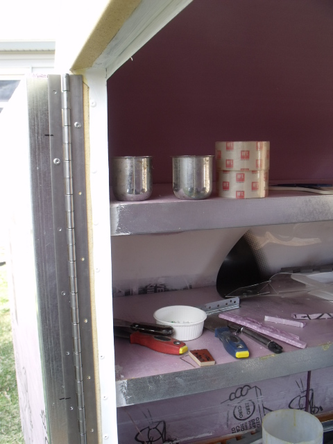

Once I was able to get the door installed I was able to check for fit. Top and bottom of door was fine but the latch side was a bit tight at the bottom.
Door installed
A couple more shots of the hinge with door open and closed.
Door open
Door closed
George.

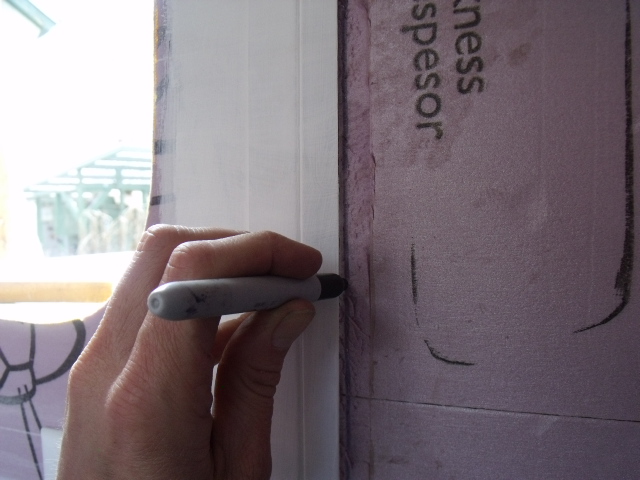

So now that the door was installed I marked on the inside the door frame contact area. This allowed me to measure out for a cut line for the latch side edge. Drilling out the rivets again I removed the door and cut the latch side edge back even.
Marking the inside door frame
Once I made the cut now I installed the latch side hard edge and reinstalled door.
Latch side hard point
George.

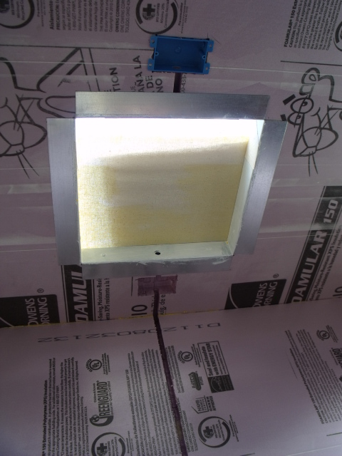

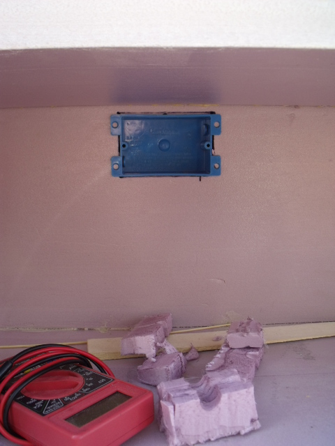

Postby ghcoe » Thu Mar 24, 2016 10:01 am

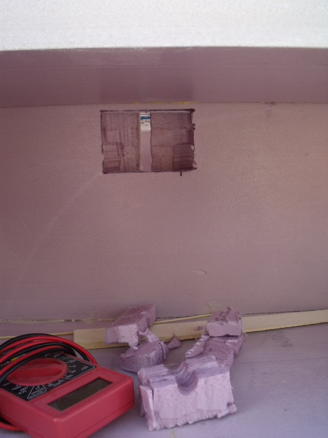

Also worked on some of the wiring prep. Made cutouts for outlets and wire paths.
Cut marks
Cutout
Outlet installed
George.
