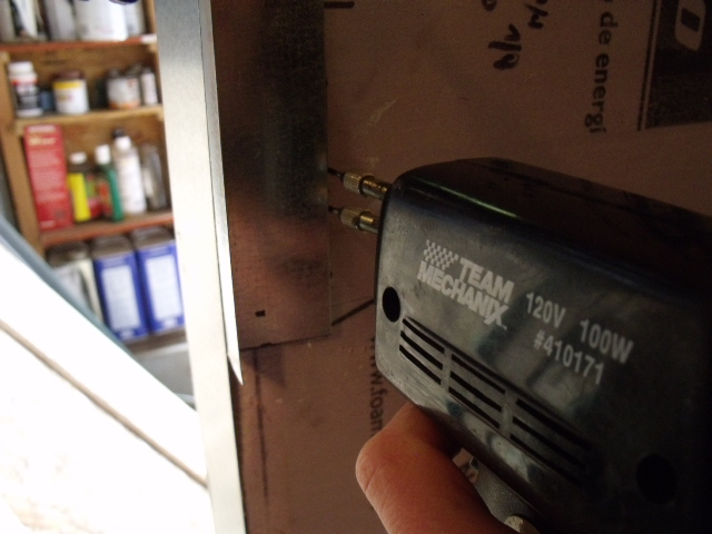

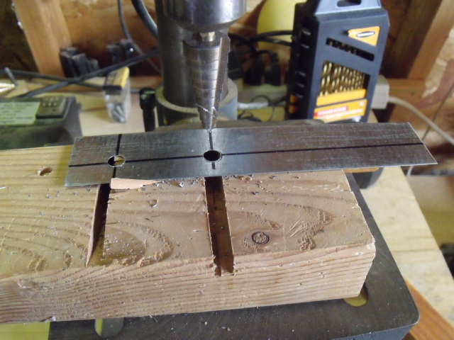

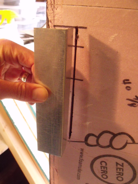

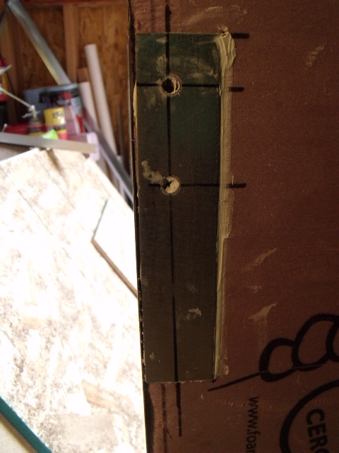

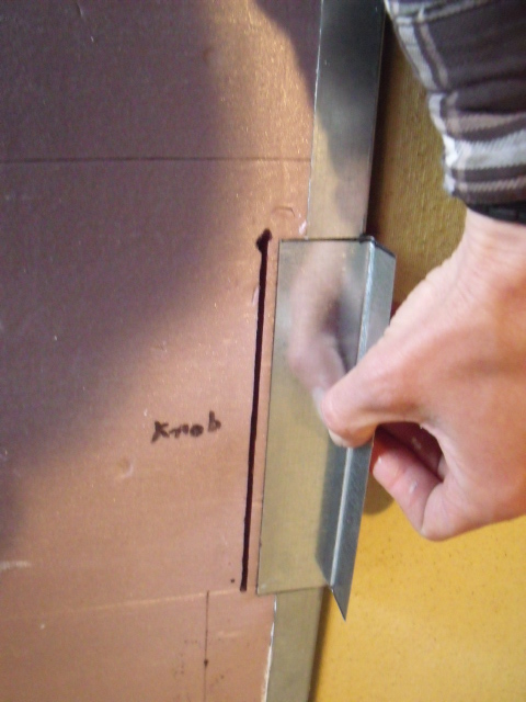

One project yesterday was installing the door latching system. I am using storm door handles for this build. I am using my foam reinforcement technique for this process. First I cut out a reinforcement plate, in this case a piece of 1"x2" flashing. Then I take the soldering iron and make a slot using the flashing edge as a guide. Now I am able to glue and install the reinforcing plate. This makes for a good hard point for installing the interior latch. Before I glued the plate in I did predrill the holes for the latch.
Grooving for reinforcement plate
Reinforcement plate interior
Drilling holes for latch

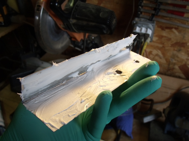

Some shots of the gluing process.
Gluing with cualking
Glued
George.

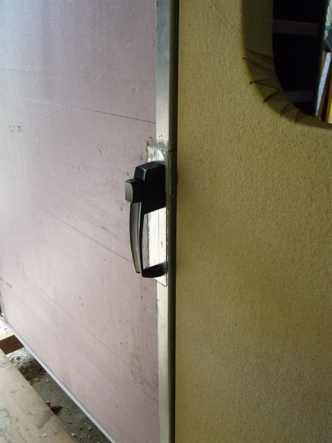

Postby ghcoe » Fri Mar 25, 2016 9:23 am
Same procedure for the outside.
Outside reinforcement plate

Yup. I purchased longer bolts for the handle so they can reach through the extra door thickness on the foamie. With the handles on both sides of the door it will create a clamping action on the foam. The flashing is so it will spread the pressure across the foam surface and keep the handles from compressing the foam. Also keep the foam from breaking or bolt holes from enlarging with use. The only wood in this build so far is in the floor. All hard edges and hardware attachment points are flashing and or drywall beading.

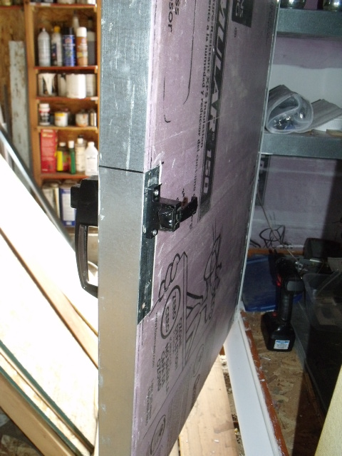

Last day of break. Manage a few things. The door handle is now mocked up, just need to make the striker plate to take up the slack in latch to threshold.
Door handle
Inside and outside handle
Inside handle
George.

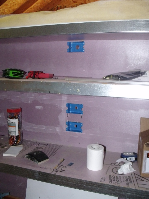

Installed flashing to the shelving to give shelves a bit more support than just one piece of flashing. Installed electrical boxes where needed. Getting closer.....

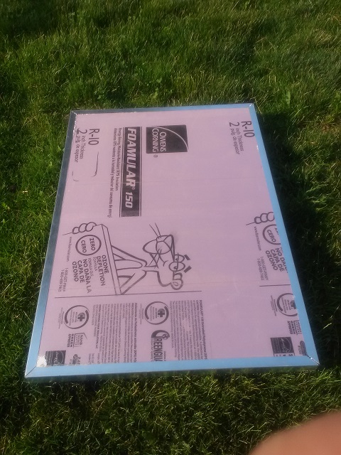

Any thoughts on bending/folding that flashing and using Pop rivets to make rudimentary FRAMES for the foam pieces ( or entire cabins ) ... throw in a couple anti compression PVC tubes like Roamer said ... and Bob’s your ... :thinking: No wood , no worries , and you could cover over all that with an outer skin , perhaps that FRP product like Ken W used, or even canvas , or chipboard ... :o ... Interesting !!!
Re: #1
Postby ghcoe » Mon Mar 28, 2016 8:27 pm
GPW wrote:Any thoughts on bending/folding that flashing and using Pop rivets to make rudimentary FRAMES for the foam pieces.
Not sure if I understand what you are getting at. I did make frames to fit around the doors on my first attempt and installing hard edges. It actually worked real good and looked good too.
Door framed
I found that you would have to have your measurements and bends perfect for a good fit. I worked with it a bit, but went with this new way to make assembly a bit easier.
