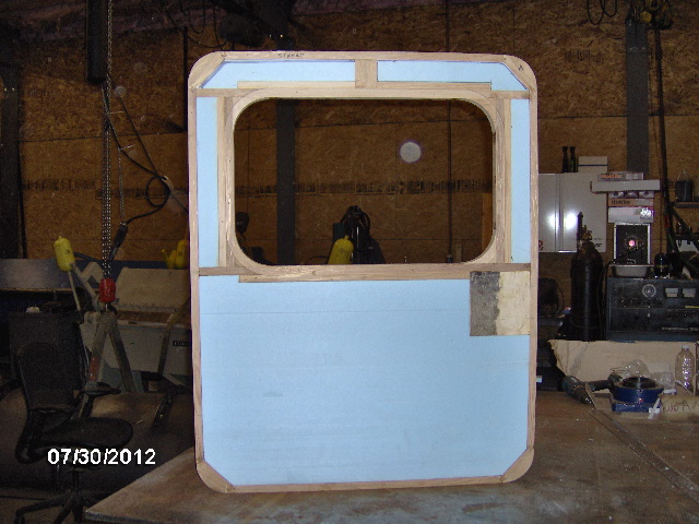

Got the second door recessed for the window. Pays to check and recheck everything. The original pencil tracings I made of the window outline had been sanded down a bit when I cleaned up the window frame additions, so I decided to retrace the window. Since the first door had been fit to the first window, I decided that I had better use the other window for this door. You never know, they might not be the same. After pushing the window against the sill and centering it side to side I traced it out. But the trace marks didn't look even. Found that one of the rubber pads that holds the window up off of the sill was missing from the second window (suppose it might have come off while I was handling them, but I didn't find it). Glad I measured. I'll see about getting another one. Was able to adjust for it and retrace. Turns out that the glass is a little lower, more even on this frame, but the upper and lower sections are a little off from side to side. The edges of the glass don't lineup perfectly.
Did I mention that I love me some biscuits. Remember those pneumatic staples that I used to add the extra window frame blocks on while gluing? I only hit two of them with the router when rabbeting. Sounded like the Doppler effect when a cat's tail gets stepped on; whirrrrrrrrr, eeeerrrrrrrrr. :frightened: Carbide bit seems none the wiser and the exposed pins were either punched down or pried out with pliers. One more spot that needs a little filler putty.

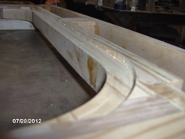

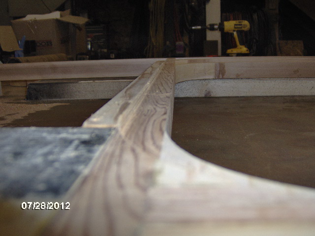

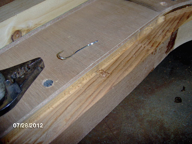

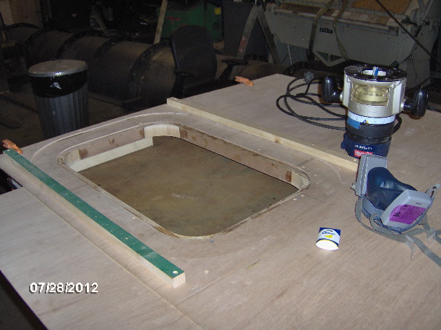

Here are a few pics to go with my description from Saturday's work.

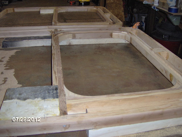

Got the window recessing template attached to the second door and all ready to route.

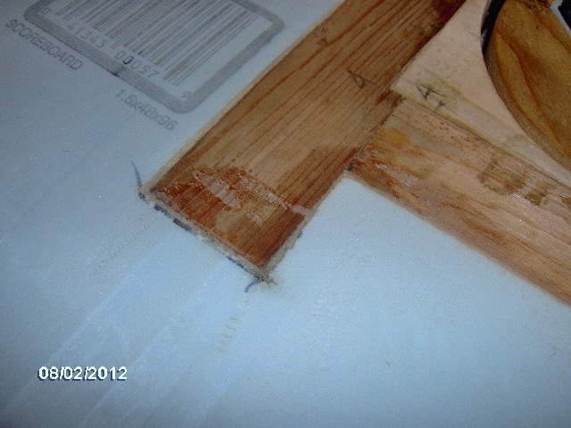

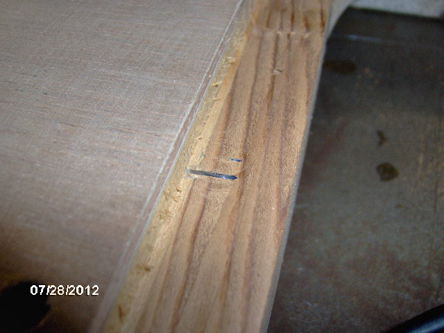

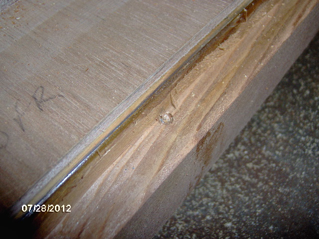

Here's where I ran over the first staple and punched it down with a center punch.
Will have to put a dab of putty there.
Hit the second staple quite a bit harder.
Yanked it.
Another spot for some putty.
Here is the finished recess.

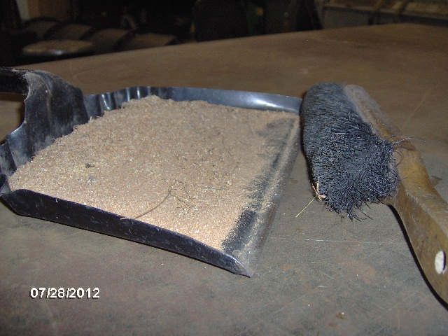

A dust pan of sawdust every day is the camper builder's way!

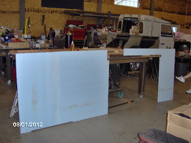

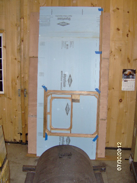

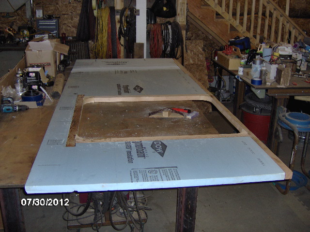

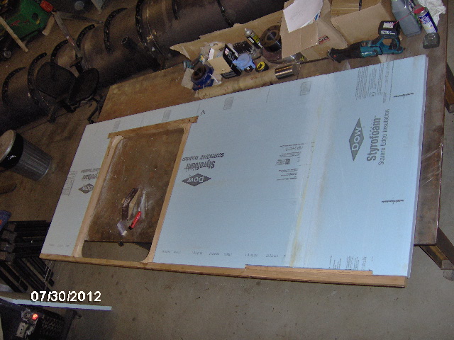

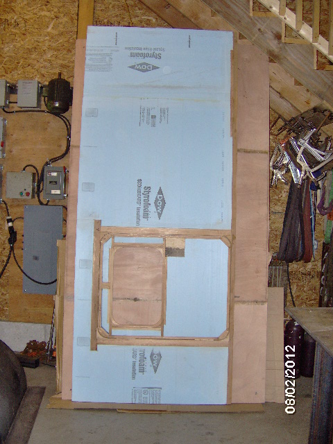

Cut and test fit the street side wall foam to the wall sub frame.
Used the razor knife to make the cuts and the course sanding block to tune things up a little.
Then I fit the foam to the street side door, just dry fit for now.
I just used a little painter's tape to hold the wall foam to the wood frame and it was a snap to pick it up and walk it over to lean against the floor and other wall foam. Here it is with the door sitting in the door opening.

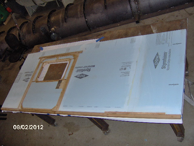

Okay, I'm making progress on the street side wall.

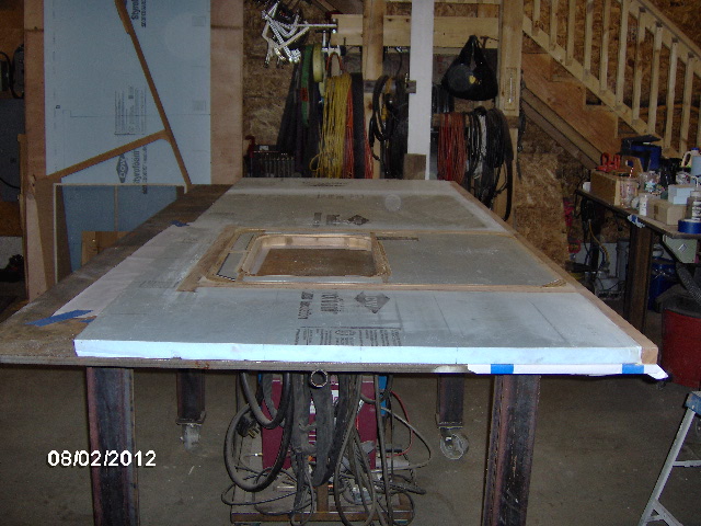

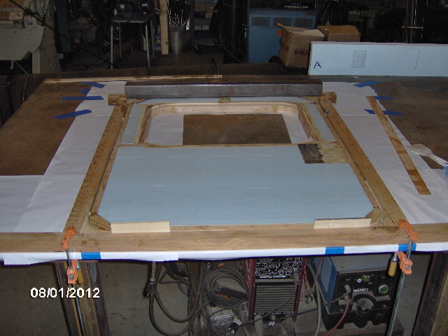

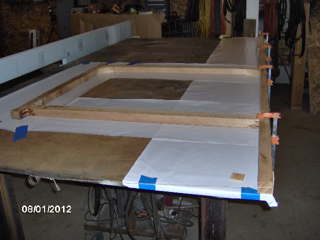

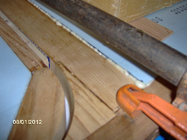

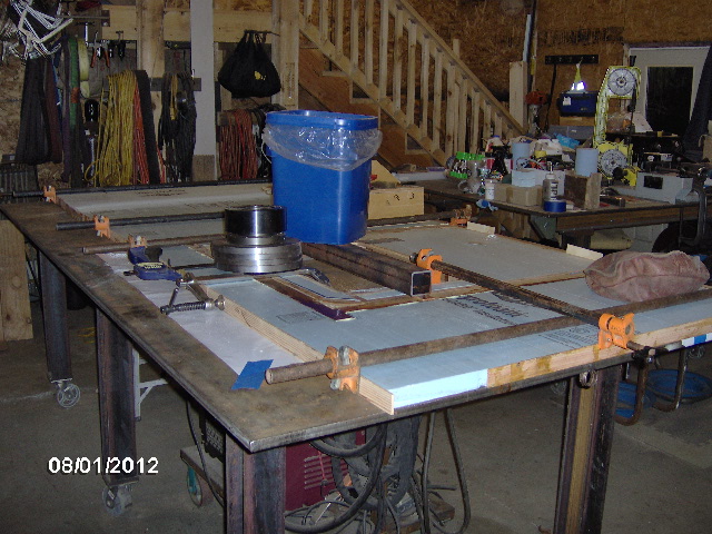

Wednesday I started getting ready to glue wall foam to wall frame by clearing off the bench and taping some freezer paper down.

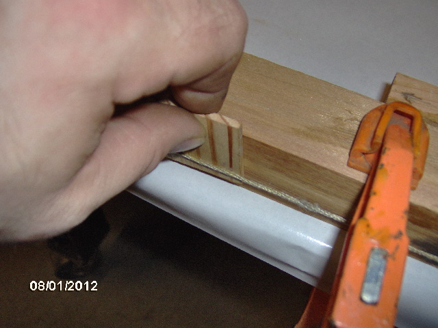

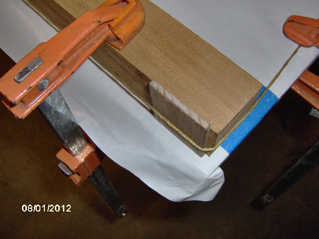

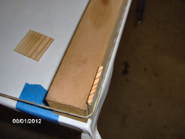

The bottom sill of the wall had a little flex to it so in order to have the base of the wall come out straight I strung a string line along the bottom. Rather than just running the string on the sill, and perhaps giving a false reading, I spaced it out equally at each end with a shim.
Then I used a third shim to check the gap along the string, pushing or pulling the sill while placing clamps along the edge of the table.
Straight as a string!

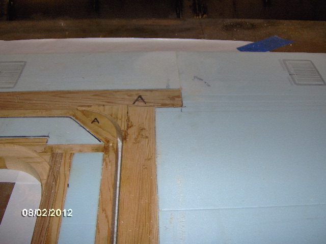

In handling the wall foam once the door surround was cut out I was concerned about breaking it where it was thinner over the door. I also thought that it would be easier to get the foam to fit the frame a little better, and easier to apply and clamp the glue if the foam was in two pieces. So I cut it just at the rear of the door header.
The door surround also could be shifted around at the top some, so rather than letting the foam and gorilla glue push the door surround around I laid the door in the opening and shimmed it in evenly good and tight. The foam in the door itself has not been glued, but fits good and tight so it's not going anywhere. (The steel tube at the top is an attempt to hold the top of the door surround down against the table so that the glue would not expand underneath and lift the wall off of the table.)

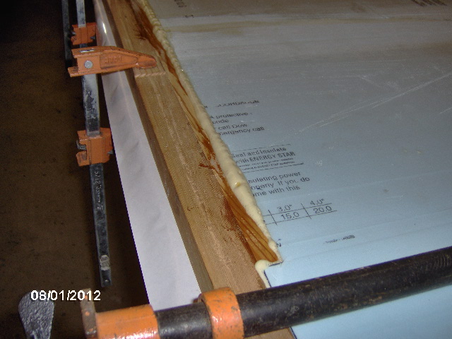

Prepositioned bar clamps and wood shims (to spread the clamp load and protect the edges of the foam) and glued it up; first the rear section and then the front. I was grateful that Karl had come out to the shop and lent a hand. Added some more weight when it looked like the header was lifting. The round pillow looking thing in the right front is a shot bag (leather filled with lead shot) used for hammer forming sheet metal.
Some closeups of the GG in action.
Add 3 hrs labor.

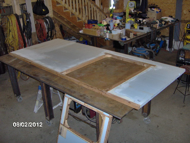

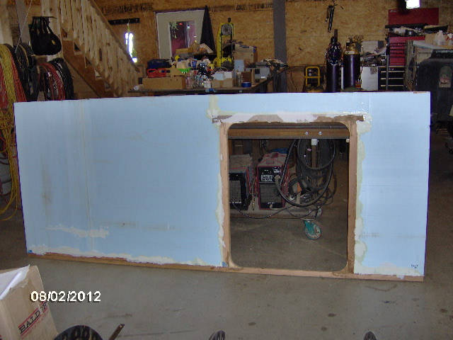

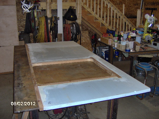

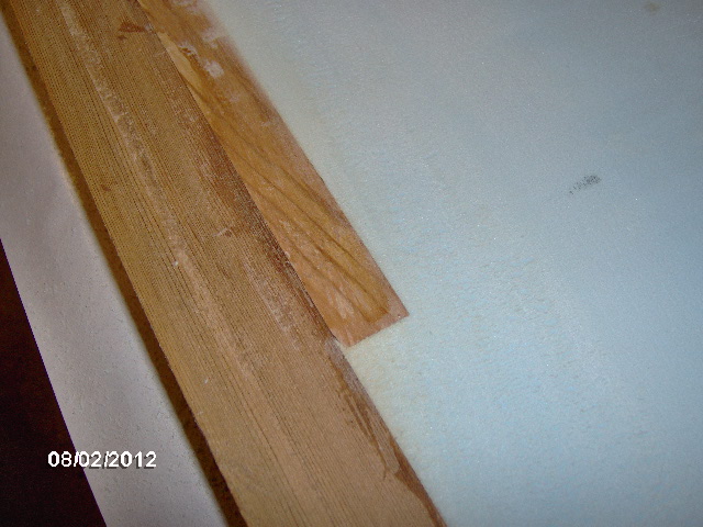

This evening (Thursday) I put another 3 hrs in unclamping the wall and cleaning up the excess glue. On the top (outside face) I used the cheap extending razor knife to trim off some of the squeeze out. Then a combination of the mini Surform and sanding blocks.
There are some issues that don't show in the photos; a few digs, and lack of fairness with the wood, but those issues will be addressed later.
Next I pulled the tape holding the freezer paper down to the table (as best I could) and lifted the whole thing up enough to get the tape holding the paper to the table around the door area. After peeling the bulk of the paper away there were large areas where the GG had squeezed under and the freezer paper didn't release well.
Being the inner side I didn't have to worry as much about small dents and gouges, but it needs to be fair to get a strong bond with the inner wall skins (5 mm marine ply). Used a small scrapper to get the excess off of the wood fairly easily. However, it was much harder to deal with on the foam. Some shaving with the razor knife; some peeling by hand; coarse sanding block scrubbing fairly hard to break the paper/plastic film, then a bit more to open the cells on the GG (being careful not to gouge out the adjacent blue foam); the mini Surform could then cut the GG down; then 100 grit on the small oak block.
I'm going to try GPW's iron trick to see about removing some of the small dents, then light weight spackle to fill and fair anything that is left, but that will come later just before skinning.
And now to bed.
