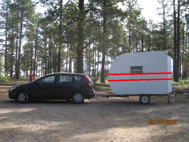

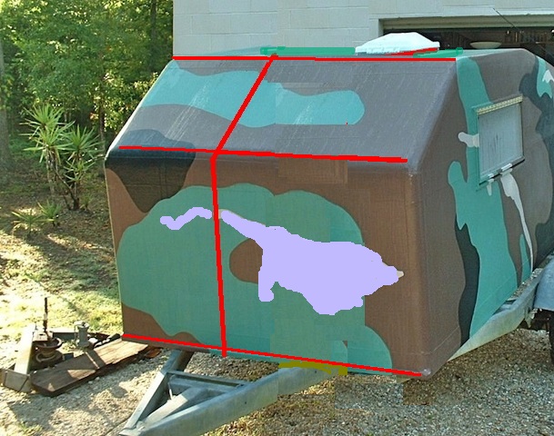

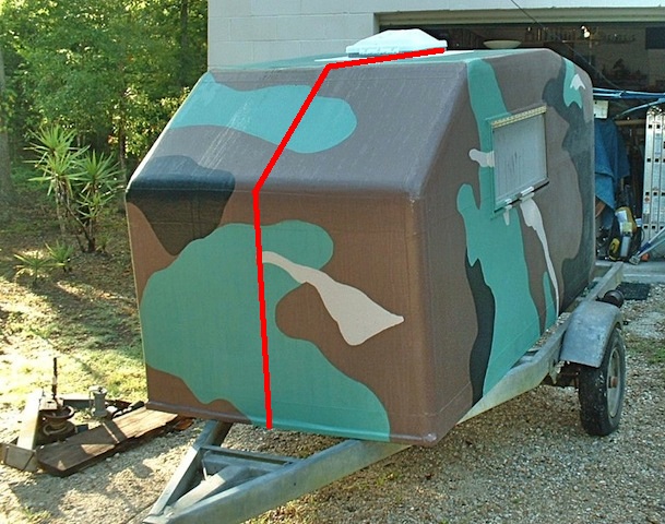

Do we need a new thread for modifying existing Foamies’ ? Not only bigger , wider (or smaller ) , but adding slide outs , bathtubs, crystal chandeliers :roll:
Or just , how the “chop” a Foamie ... :o Being an old hot rodder/vanner with some chopping and channeling experience , we positively know , modifying a Foamie would be real EASY !!! .. with Kitchen tools ... ;) Don’t throw that old Foamie away (or destroy it :o ) Chop it ... 8) :thumbsup: :beer:
Re: Thrifty Alternatives ... Building Foam TDs
Postby GPW » Fri Jan 04, 2013 8:58 am
for example ...

Just to mention again , it’s so EASY to add or subtract from a Foamie ... Making any shape or form possible ... I’ve been eyeing my little foamie , thinking if I split it down the middle (floor too ), widened the floor , and added a new center section , it would be Much nicer , more practical for my needs ... :thinking: Instant LowWider ... :o 68” wide inside 8)
Alas, a project for after the FoamStream .... :oops:
