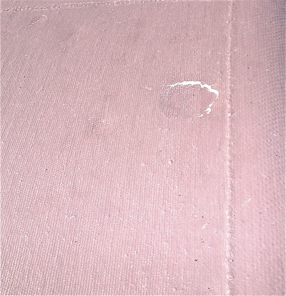

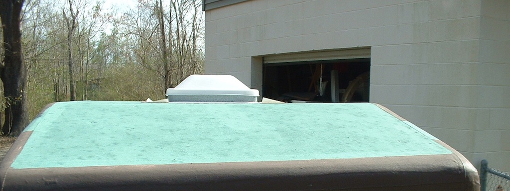

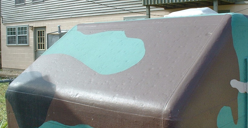

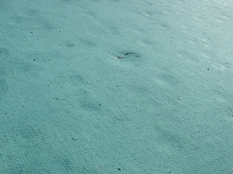

For those interested , here’s the Hail vs. Foamie pics Have noticed the little spherical indentations have already begun to fill back in being exposed to the sun’s heat . Couple places got tore around the edges of the craters ( or "craterettes” in this case ) , not bad , a quick fix/patch , and that was with my Thin (thrifty) canvas ... Imagine if I’d have used a good heavyweight canvas , there would have been no impressions, as the fiberglass taped edges on mine show no hail effect ... The hail ranged from tiny bits to 50 cent diameter sized pieces... Yet more “testing “ ... :roll: :o :thinking:
Re: Thrifty Alternatives ... Building Foam TDs
Postby GPW » Thu Feb 28, 2013 11:07 am
Front roof crater...

GPW - Those 'dimples' will just make it more aerodynamic
for you - like a golf ball ! ! ! Ha ! Simple repair now too -
just some touch-up paint.

Norm , maybe (golfers would approve ) ??? Hail damage: The only good thing is there’s nothing to soak in water , the canvas is encapsulated , nothing to Rot ... and like you say a simple repair (paint) , and I think once the sun gets to shine on it for a while the foam will expand and fill in the dimples ... Probably too cold now for that to work ... I could pour boiling water over the top , that would do it ...

Just a thought foe dent removal. If you laid a wet towel over the dents and then heated the towel with a heat gun would it steam enough? Would that steam raise the dimples? Just thinking out loud...

On those dimples I think I would just wait till a good sunny day and see what happens. The Sun will heat the foam evenly and will get some good penetration. I think with heat guns, water and such you will quickly heat the surface, but not get any heat at the core.
