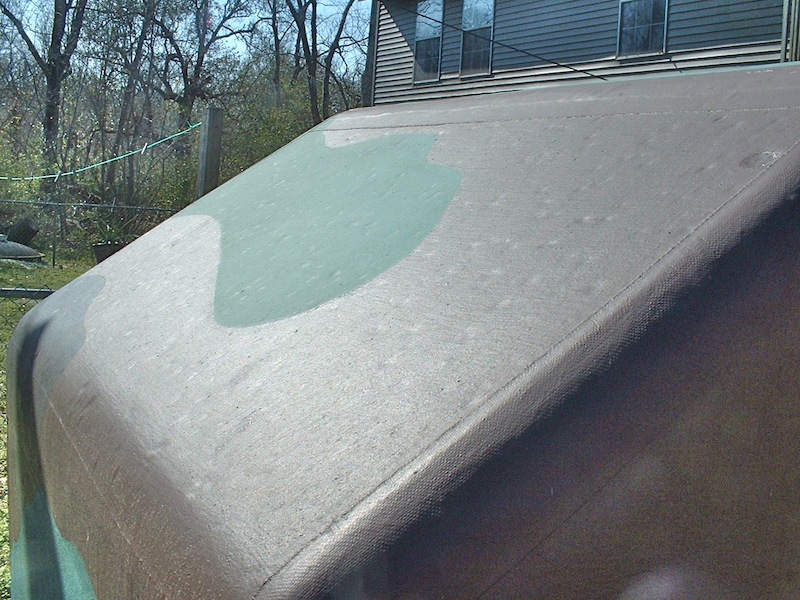

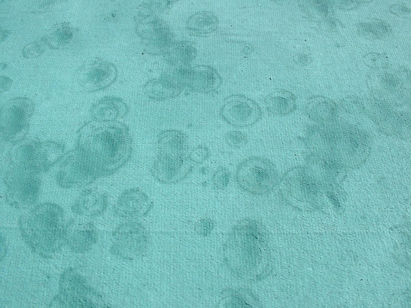

As the days go by in the Sun , the dimples are gradually disappearing :o ... almost gone now , only leaving the semicircular white marks where the primer was exposed ... Going to be an EASY fix , just a tiny paint touch up ..... Glad I saved some of those colors ... ;)
Self healing trailers , whooda’ thunk it ??? 8)

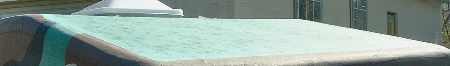

Latest pics of "The self-Healing” in progress ... :pictures: Notice the strange patterns formed by the expansion of the foam , sorta’ looks like the surface of the Moon , made of green cheese ... :o :lol:
Not even summer temps yet when the foam will get up to ~ 140F (darkly painted areas.)... by then it’ll surely be drum tight again ... :thinking:

Postby ghcoe » Sat Mar 02, 2013 11:23 am
I figured the sun would make them pop. Another selling point for hail prone areas...... :lol:
George.

Postby GPW » Sun Mar 03, 2013 8:49 am
As you can see by the pics , the cheap Wal Mart Exterior paint has lost it’s gloss , but still seals the canvas .... actually the primer is sealing the canvas and the paint on top is merely “decorative” ... Looks like it’s time for a quick paint job on the roof ... the sides are still fine ... May just re-paint the whole thing ... Perhaps a mural this time ... something like the original model ... :thinking: This Foamie has been living outside in the weather extremes here for what , two years now ? Still “dry as toast” on the inside ... Worst part is that PINK HF frame ... Just doesn’t go with Camo ... :o :lol: :lol: :lol:

atahoekid wrote:Just a thought foe dent removal. If you laid a wet towel over the dents and then heated the towel with a heat gun would it steam enough? Would that steam raise the dimples? Just thinking out loud...
Steaming like that is for wood which will react with the moisture in the steam and expand. The foam won't react to the moisture.

Postby KCStudly » Tue Mar 05, 2013 3:55 pm
Bogo, I believe the moisture is just there to spread and control the heat. The water in the towel will last a long while at the boiling point, which is generally at or below the point where the foam melts, so the water acts like a buffer to protect the foam from overheating.
The closed cells in the foam will expand when heated; it just has to be done gently.
