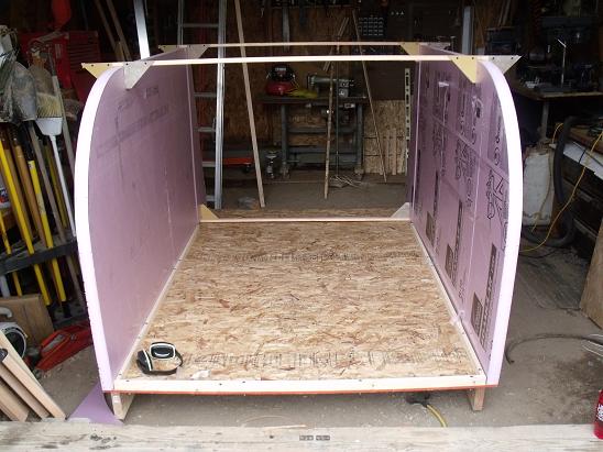

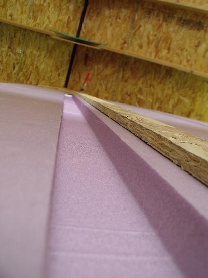

GPW wrote:Now , having blabbed’ on about that :roll: , one idea I really like is using plywood inside the trailer part way up the wall as a wainscoting. that and a bottom moulding , to me, better attaches the foam wall to the trailer floor , and protects the inner walls in the foot/kick area, where it gets bumped into most ... looks nice too ... cheap ply would be fine since it’s inside the encapsulation. :thinking:
That is one of the reasons I put my frame rails on the inside/top side of the floor. I was thinking that it would make everything stronger for supporting the foam and also a good attachment point for the wainscoting. I will not be doing it on my current build because I am trying to see how economical/light I can make a build and be a good functional design. My intent on when/if I do a wainscoting in the future is to hot wire a channel at the correct height on the wall and then glue in a 1x2 in the foam. It would make a great attachment point and also increase the structural integrity of the wall.
Groove for wainscoting support.

Inner frame rails running along walls
DSCF1753 small.jpg (79.95 KiB) Viewed 941 times

Looking GOOD G’ !!!  :thumbsup:
