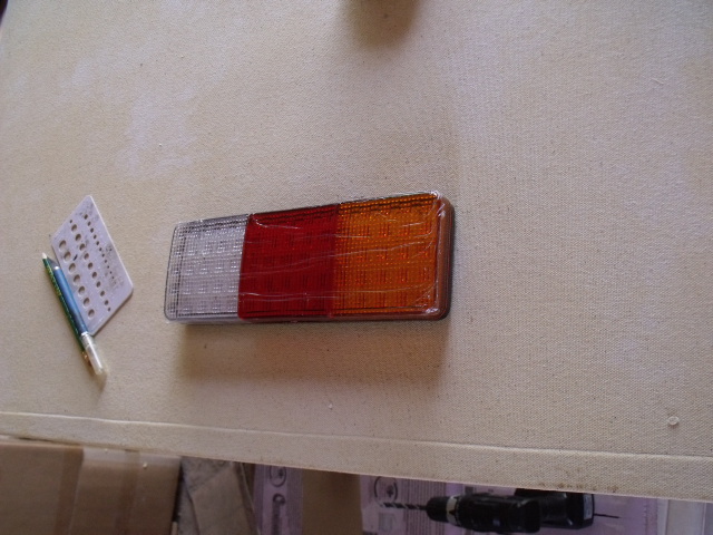

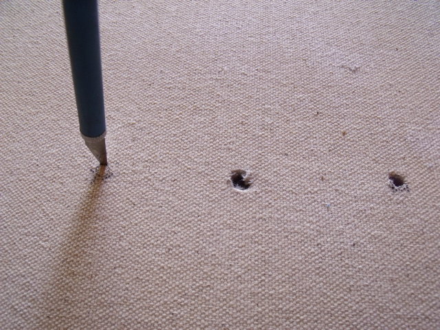

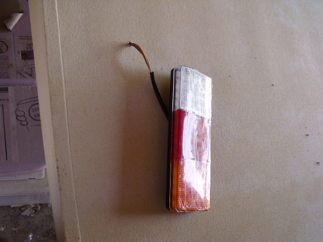

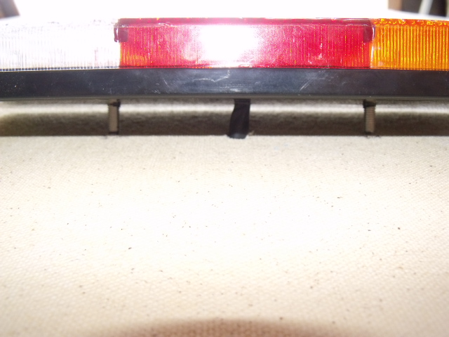

Now I need to mark where the tail light studs will go. I do not plan on using nuts on the back side, but I do need to allow room for the studs since they are not removable.
Marking the holes
Now I use a exacto knife to cut the holes in the canvas and deep enough into the foam for the studs. Then I can pick the foam out.
Cutting the holes
George.

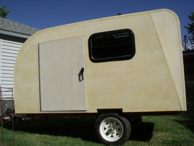

Now for the final test fit.
Installed
A couple of shots of the progress...... :twisted:
Nearly done
Nearly done 2
Hope for some more trailer time next weekend. :thumbsup:

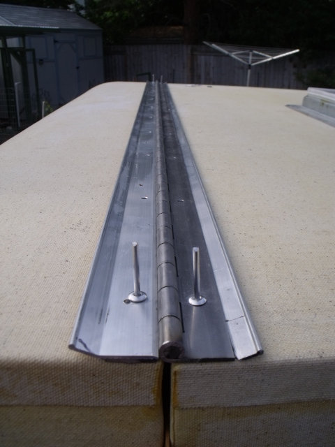

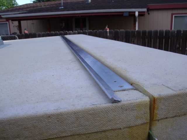

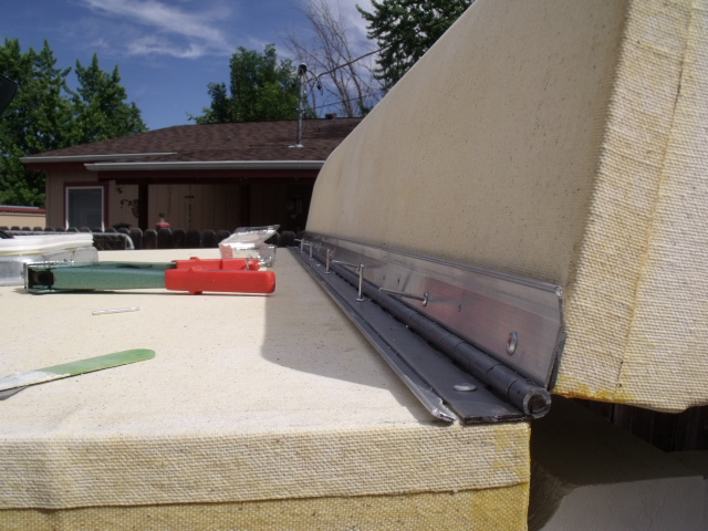

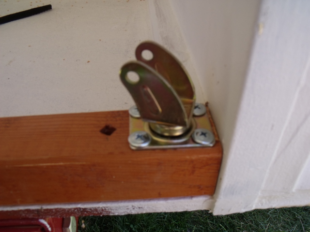

More progress on the trailer this weekend. I concentrated mostly on getting the hinge installed on the hatch. I found that with the hatch in position that it sat slightly higher than the roof of the trailer. I was already going to use a transition piece as a water diverter and as it turned out it was just the right thickness. I just had to install it under the hinge on one side rather than on top as intended.
Shim

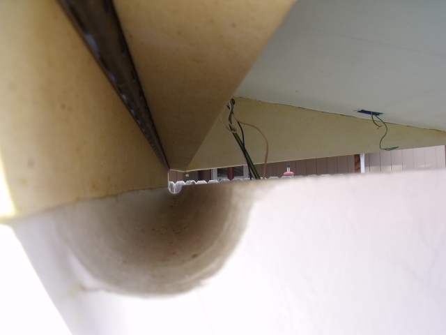

The hinges that I purchased did not have any holes predrilled so I was able to space the holes where I wanted them to be. After drilling the hinge I was able to use the hinge as a guide for the aluminum transition pieces. The transition pieces are intended to act as a water diverter to keep water from freely running into the hinge area. What water hits the hinge area should be easily taken care of by the sub roof gutter.
Gutters
Gutters also keep light rain out of the sub roof gutter when the hatch is up. I am not sure if I will cover the hinge area with rubber or not. I guess I will see how this works first.
Hinge working

Here is a shot of the sub roof gutter with the hatch up.
Sub roof gutter

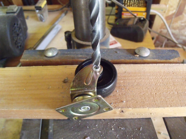

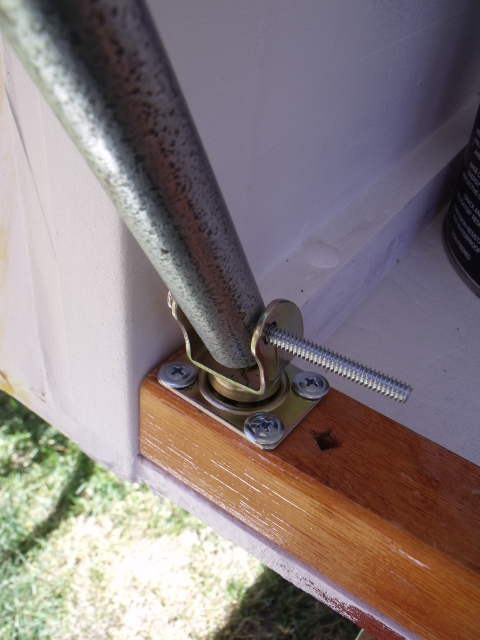

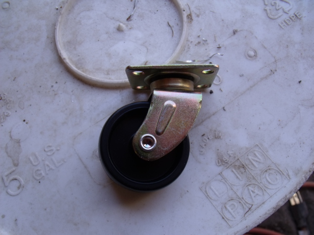

Next it was time to come up with a prop rod method. I went down a purchased two small casters rated at 50lbs. I think that should be enough capacity..... :R
Caster
Then I drilled out the axle pin.
Drilling

Once I got the axle drilled out I had this........
Caster disassembled
But, all I needed was this. :thumbsup:
Ex-caster mounted

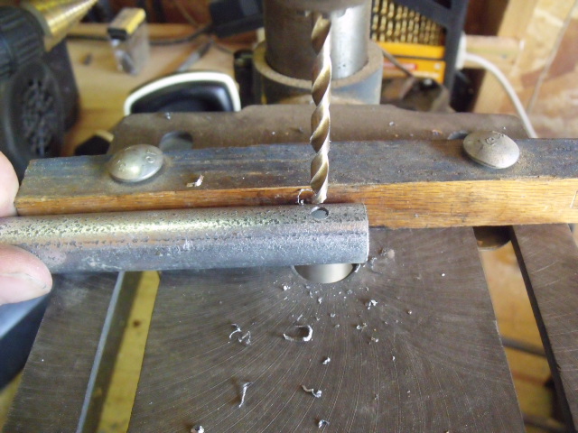

Next, some conduit for prop rods. Turns out that one 10' piece was just the right length for two prop rods. How lucky is that :R
Drilling the prop rod
George.

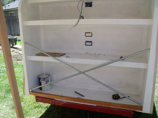

But, of course no bolts the right length.... :roll: Not going to let that stop me now.
Prop rod installed with caster

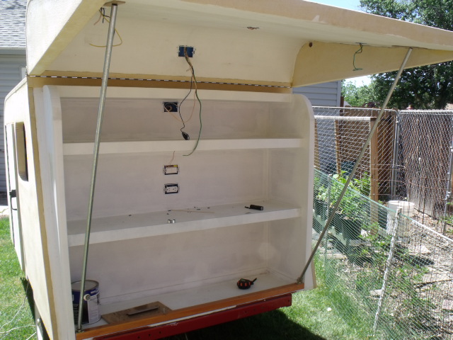

Then the test. Hatch deployed..... ;)
Prop rods in use
And of course they have to be stowed for travel.
Prop rods stowed
Still have to make a lock in device on the hatch for the prop rods. That will have to wait till next week. If all goes well. :NC
