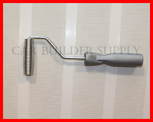

Just thought I’d mention this . For smoothing out fabric, old T-shirts, paper, etc. a ”fiberglass layup roller" works very well !!! It’s like a regular roller , but seemingly made into little disks strung together , so it won’t stick to the fabric/glue and pull it up as a flat roller would . The plastic ones are Cheap and using it as we do , lasts a long time ... It forces the air bubbles out and flattens the material for better adhesion, and a smoother finished surface.
You Ladies who are doing that brown paper bag style floor ... This would be Ideal for getting everything perfectly flat , no bubbles ... For Fiberglass hand layup work it’s almost mandatory ... The fiberglass guys know eh !!! :thumbsup:
Re: Thrifty Alternatives ... Building Foam TDs
Postby Wobbly Wheels » Fri Apr 05, 2013 8:26 am
Hehe...yup...
Just to add - you can get them with different length and diameter rollers on them. For that I'd suggest a big one (1"dia) to make quicker work of big flat panels. Little ones like the pic are great for getting into tight corners.
Oh, and be diligent about cleaning them: when those groves get plugged up they're useless and almost impossible to clean out.

GPW wrote:Just thought I’d mention this . For smoothing out fabric, old T-shirts, paper, etc. a ”fiberglass layup roller" works very well !!! It’s like a regular roller , but seemingly made into little disks strung together , so it won’t stick to the fabric/glue and pull it up as a flat roller would . The plastic ones are Cheap and using it as we do , lasts a long time ... It forces the air bubbles out and flattens the material for better adhesion, and a smoother finished surface.
The disk structure is so it forces the fiberglass matting down through the resin, but doesn't push the resin away. This makes it easier to get the fiberglass fully wetted. It would do the same for any fabric/glue or fabric/paint composite.

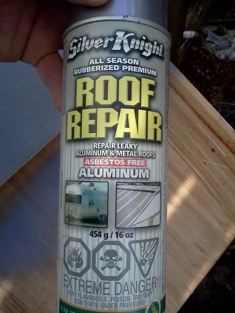

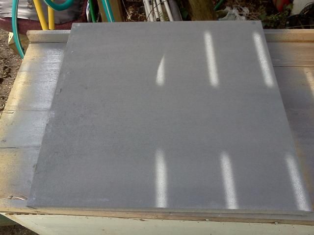

Just figured I'd post this up since I don't think it's been tried yet...
I had some drop cloth left over from another project, so I banged up a frame for it and stapled it on.
Then I hit it with an old spray can of RV roof paint that was also a leftover.
First coat
I just got back from doing the second coat before the propellant gave out. When that dries I'll post the finish.
Because the roof paint soaks into the weave but is too thick to actually saturate the cloth, it seems like it might be effective to pre-paint the outside of the canvas with it, then paint the canvas onto the foam. I'll post a pic when it's dry, but the back side of the canvas is still dry so the Gripper or TB3 will still have plenty of bite on the cloth. If the dried paint is flexible enough, it might be easier to roll the paint onto bulk cloth (or precut pieces) from a roller tray and then apply the impregnated cloth over the foam after it dries.
If this piece works, I figure I'll stretch it over a couple laminated cedar bows and use it as a removable awning over the door. It may also be an economical alternative to big pieces of awning fabric (which ain't cheap !)
And BTW, it looks like TB3 isn't a solution to prevent polyester resins from eating the foam :(
Pics will be in my build thread in a bit.

My concern with the roof spray is , is it porous enough to allow the adhesive under it to dry ... ? Would make a great awning though ...theoretically .... needs “testing” ...

As far as the adhesive drying under the roof paint, I figure that if Gripper will set up between a couple styrofoam meat trays, the paint has GOT to be more porous than that.
