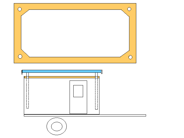

Not being one to spoil the Party , here's an idea to unify the top of the trailer and allow a pop up roof .. a sheet of plywood incorporated into the top of the sides that would allow tubes (aluminum, PVC, ? ) to pass through the holes in the ply and support the roof ...Once it's extended a peg in a hole drilled in each tube would act as a stop ... EASY !!! Plausible ... Just an idea !! Image
Postby droid_ca » Fri Mar 11, 2011 6:20 pm
looks like that should work I'd ad another set of legs in the middle to add a bit more rigidity but that would definitely work

Droid , trying to keep it SIMPLE ... Figuring the roof will be "covered" (fabric ) so it'll be stiff , and the required end/side caps , somewhat indicated would keep the rain out in the down position ... That should add some serious stiffness too ...

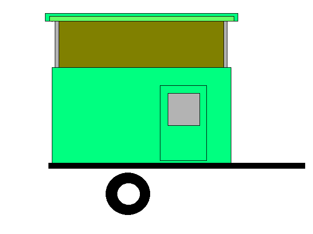

Now if I'm understanding this all right, I think there will be some tent material connecting the top and sides , like a "bellows" , Image

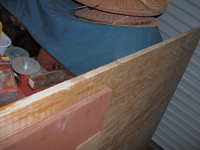

Postby GPW » Sat Mar 12, 2011 11:26 am
Here's a pic of the ply edge voids/irregularities filled in with wood filler ... pretty boring , but you did want pictures ... :roll: Image
