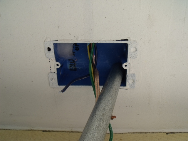

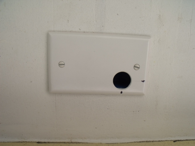

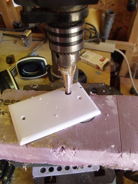

Was able make some more good progress this weekend.
I went down to Lowe's to take a look around and found patio door locks that looked promising as prop rod locks. Came home to take a look at where I wanted the prop rods to fit into the foam. As it turned out the electrical boxes were in the perfect spot.
Box

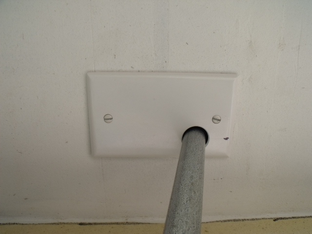

So rather than install another hard point I decided to dual use the boxes. I was just going to use a cover plate on the boxes so I decided to drill a hole in the corners of each cover.
Drilling
And when done it looks like this.
Hole
George.

Postby ghcoe » Sun Jun 19, 2016 6:16 pm
A picture with the rod in place.
Prop rod and hole

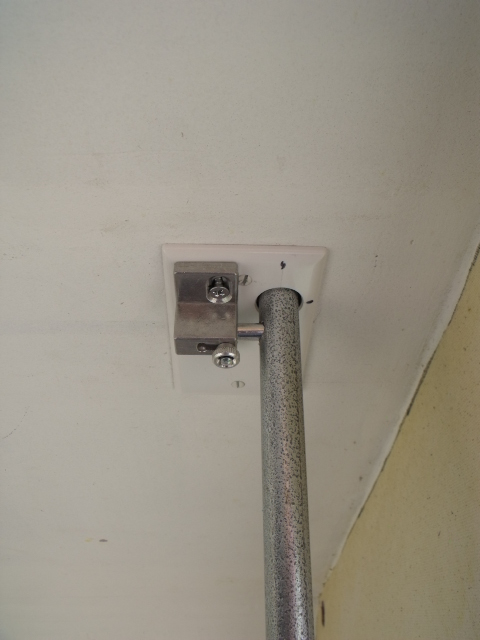

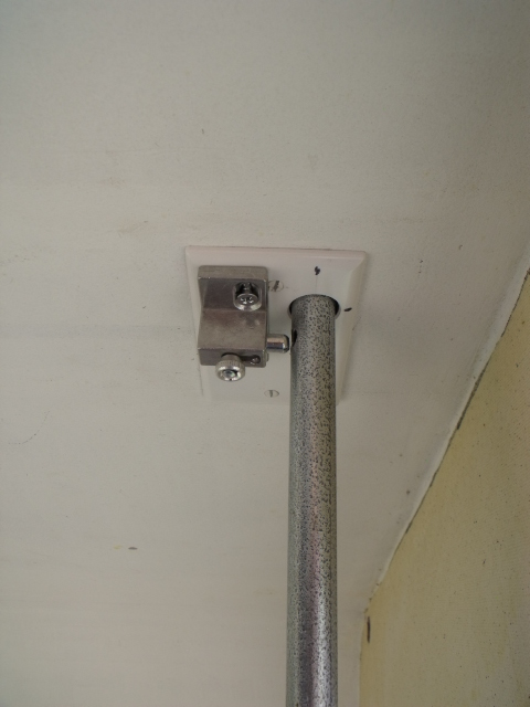

Then it was time to add the patio door lock. I attached the lock to the box cover and drilled a hole in the proper position in the prop rod.
Patio lock
And now I can lock the prop rods in place.
Prop rod locked
George.

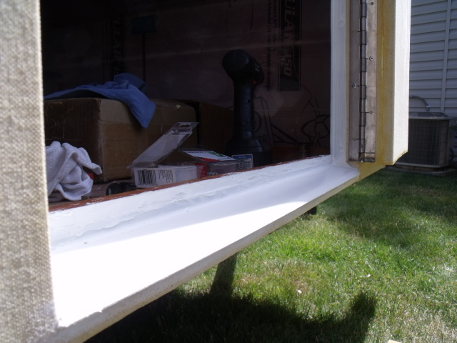

Postby ghcoe » Sun Jun 19, 2016 6:21 pm
I also got the curb side door faired out and covered.....
Door
and threshold installed.
Threshold
That was the last of the outside canvasing. (root beer) :beer:

Postby KCStudly » Mon Jun 20, 2016 6:40 am
How do you plan to keep the wires in the box from being pinched by the end of the prop rod? Did you partition the box off?
Re: #1
Postby ghcoe » Tue Jun 21, 2016 4:50 pm
KCStudly wrote:How do you plan to keep the wires in the box from being pinched by the end of the prop rod? Did you partition the box off?
Yes I do plan on separating the prop rod area from the electrical components. I will do that once I start to finalize the wiring.
George.
ghcoe
Posts: 1982
Location: SW Idaho
Re: #1
Postby KCStudly » Tue Jun 21, 2016 8:28 pm
Unconventional, but should be safe enough, I guess. :thinking:
Re: #1
Postby ghcoe » Tue Jun 21, 2016 9:01 pm
Since when is anything conventional in a foamie? :thumbsup: I though it over before I decided to go with it. Plenty of room in there for the wiring. I will probably partition it with a piece of PVC pipe glued into place. 8)
