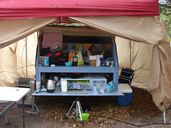

Postby eaglesdare » Sun Apr 21, 2013 5:46 pm
105185

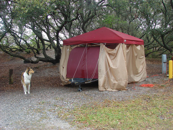

Postby eaglesdare » Sun Apr 21, 2013 5:52 pm
The first pic I had to tie the ex-up to the frame, we were expecting winds.
