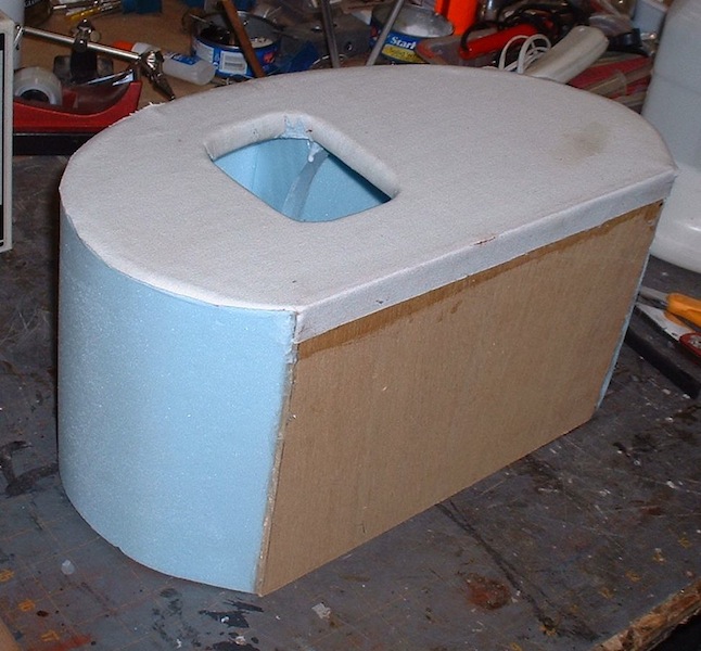

foam dust
don't laugh, it really wasn't finished yet as far as the shape went. that weird part that is sticking up is gone.
that is me, trying to get both pieces to match. i did a lot of sanding on it also.

Eagle , That looks Wonderful !!! :thumbsup: 8)
I see you got the large bottle of Gorilla Glue . me too ... You ever use it before ??? There are a few tricks to using it !!! Let me know if you already know them ...
Yes, foam in the wind is really difficult to manage , even more so than ply ...like a sail !!! :o

You need to apply LESS glue than you think you'd need ... it expands (foams ) like crazy , and if you put too much it will ooze out all over the place .... On a 2" surface like that , I'd just run a
bead down the center and spread it out thin and thoroughly with a stick ... then LIGHTLY spray the other surface with water and join them ... I use packing tape to hold everything till the glue activates... (couple hours) and on a seam you can even run the tape outside the seam to help control the foam ooze... You may want to test all this on a piece of scrap foam ... just for a bit of practice ... :thumbsup:
