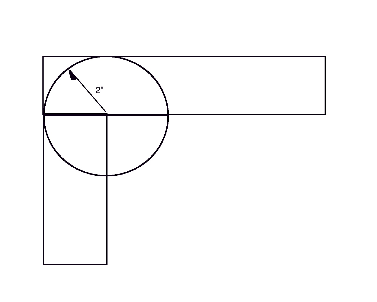

GPW, you have rounded the corners on yours- I don't recall what problems, if any, you had with wrinkles, and if so, how did you deal with it? (don't really want to read through 380 pgs again to find out!) I would like to have rounded corners, but worry about the potential for wrinkles

Postby GPW » Mon Jun 03, 2013 6:27 am
Sam , with a stretchable fabric , like canvas, there are no wrinkles ... I slightly dampen the canvas and stretch it over the rounded areas... even compound curves can be covered pretty easy , with no darts ... ;) It has it’s limits naturally , so covering has to be planned ... :thinking:

Postby GPW » Mon Jun 03, 2013 9:48 am
A safe radius would be the thickness of the foam .... Viz. 2" thick foam could easily have a two inch radius ...
A Nice neat covering is an “unhurried “ job !!! It’s where you have to do your Best work because that’s what Everybody sees first ... :frightened:
Foam radius.jpg (55.64 KiB) Viewed 435 times
