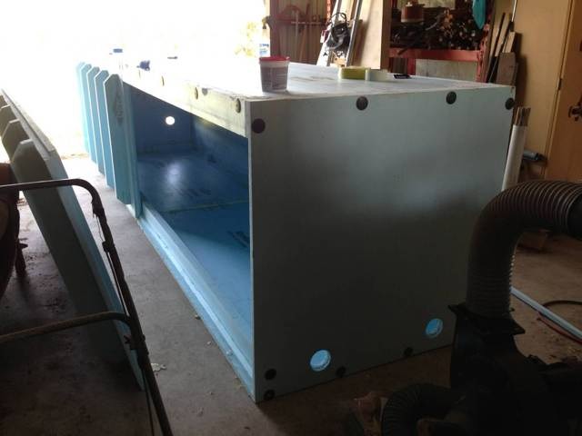

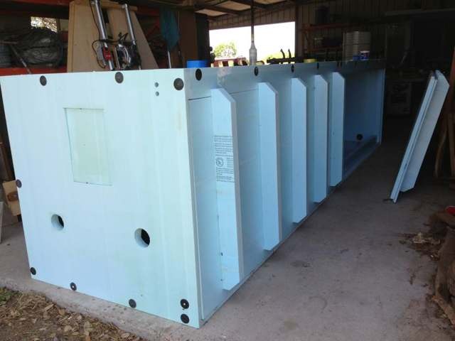

Re: Thrifty Alternatives ... Building Foam TDs
Postby tonyj » Sat Jun 29, 2013 1:29 pm
Here is the box--upside down for bottom work:
tony
tonyj
Posts: 2468
Images: 160
