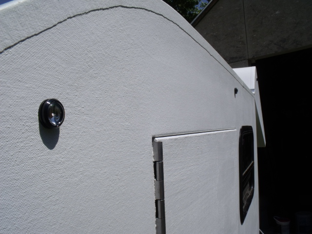

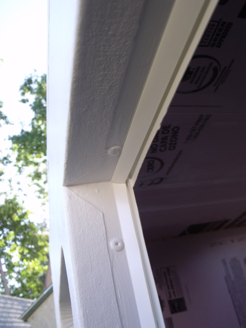

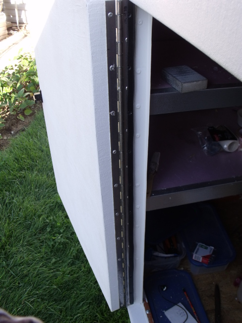

I am off this weeks so some progress with the build when I get the chance. First it was reinstalling the doors, this time with weather stripping and door latch hardware.
Hinge
Weather striping
Rain guard
George.

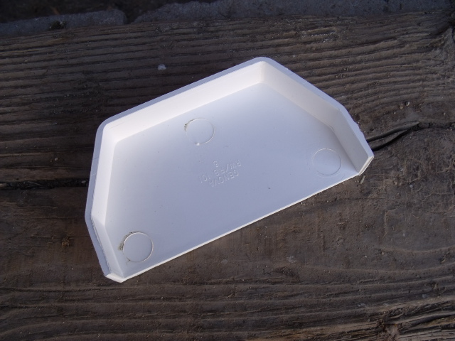

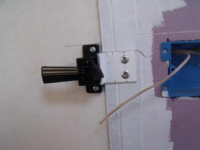

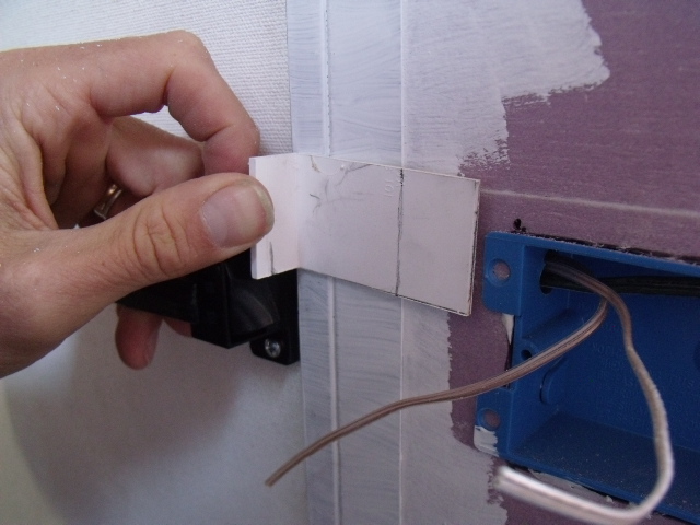

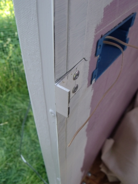

I used storm door latches in this build. They work great except that the latch is a bit too far in to be able to latch properly. So I had to come up with a solution take up the slack. I purchased a gutter end cap and cut it up to make what I needed.
Gutter end cap
Gutter cut
Latch
George.

Re: #1
Postby ghcoe » Wed Aug 03, 2016 10:18 pm
Worked perfect.... :thumbsup:
Installed
Latched

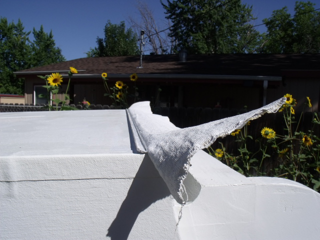

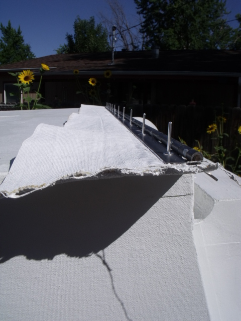

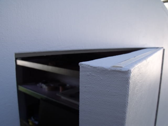

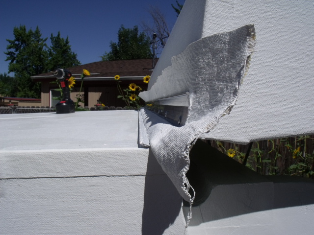

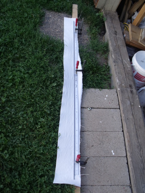

Next it was onto the hatch. At first I was just going to leave the hinge exposed, but then I decided to try to cover it. I prepped up some canvas with TBII and paint. Then I cut a straight edge on one side and sandwiched the canvas between the threshold spacer and hinge. I used a thick coat of paint between each part to make a water tight seal. Then I folded it over and sandwiched it again between the hinge, which is the lower of the two this time, and the threshold to make a canvas cover of the hinge area. Still have to trim the canvas.
Canvas prep
Straight edge
Sandwiched
George.
ghcoe
Posts: 1982
Location: SW Idaho
Re: #1
Postby ghcoe » Wed Aug 03, 2016 10:30 pm
Should help slow the water some.
Flap flapped over
Hatch reattached

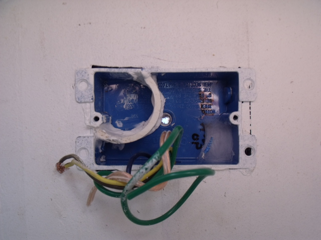

Also got the electrical boxes divided to keep the electrical safe from the prop rod.
Separated

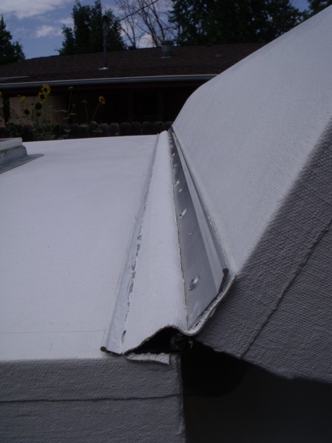

I got the hinge cover trimmed. Still have to paint it, but you can see how it turned out. This is kind of a living hinge on top of a hinge......
Hinge cover

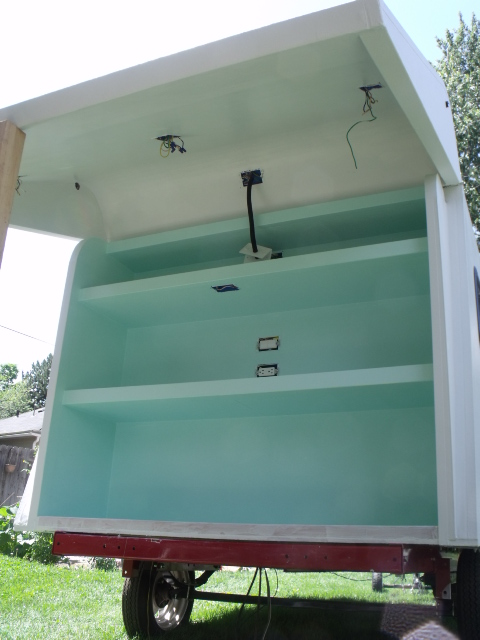

And a coat of paint in the galley/hatch. Light blue in the galley and body color on the hatch interior. :thumbsup:
Galley paint
