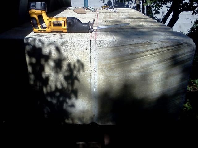

I got a bunch of 24"X48" dock billet (55lb foam) - 18 lineal feet of it...144 cu ft...about 8K lbs of bouyancy and about $2k MSRP...also free :shock:
Whatever I do with it, I still have to rip the foam into 2'X2' billets to store it. At this point the as-yet-undetermined craft will probably start out as a 16'X20' floating platform for a wall tent that will eventually sport a small cabin. Because we have such steep rocky shorelines here (think: fjords), floating cabins have been popular since the turn of the century. The places I like to fish have so few people that there are all kinds of floating 'squatters', but even to lease a Crown water lot it's only 500-1500/yr.
I made up a hotwire cutter using materials at hand but, after burning through a few of my wife's guitar strings, went with a sawzall with a 12" demo blade. If I keep the feed pressure low, it cuts great. If I lean on it, the blade heats up and the foam sticks in the valleys between the teeth. Still, cutting that 8' block in half lengthwise took three fully charged, (new in April) batteries...

W2, I thought it was COOL to find that axle , but that’s a real Foam find...Whoa !!! :thumbsup: 8) 8) 8) .. and most certainly is THRIFTY ... :dancing
We’ve had great luck using solid stainless steel fishing leader material for the hot wire .. tried everything else , but this seems to work ... all the foam for the FS was cut with one piece if the SS leader, and is still ready for more ... I believe it was around the 150# size ... not that big really , much like a G string (guitar :roll: ) maybe a little thicker .. :thinking:
