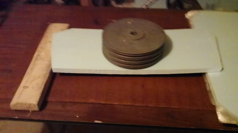

I don't have the time to go through almost 400 replies on a single post (has to be a record) but this IS related.....A foam Kayak built back in 2011....check out the epoxy and glass cloth weight test..that is 40 lbs...
http://www.texaskayakfisherman.com/foru ... 1&t=158180
But here is the thing like the administrator over on that forum said.... How deep is the epoxy-(glue) penetrating the foam.. Only the surface, and delamination was a concern in kayak building and they don't get the vibration like a trailer does...just something to consider!
