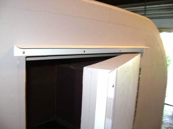

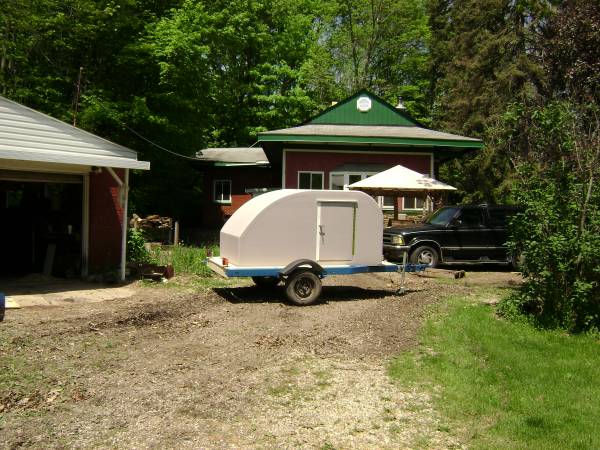

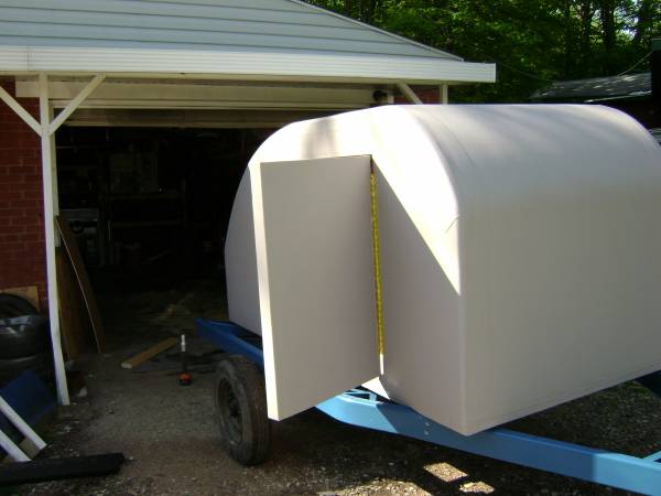

Postby pat g » Fri May 20, 2011 10:17 pm
Latest news. I wedded the cabin to the trailer today. Hung the door and trimmed it out.
SYOTR
Pat
pat g
Posts: 155
Images: 122
Joined: Thu Feb 17, 2011 8:28 pm
Location: Medina, Oh
Postby pat g » Fri May 20, 2011 10:22 pm
The extra space around the cabin will be decked in wood plank to be used as a shelf while camping. I also plan to add some planking on the tongue to carry a cooler or a box for wet paddling gear. I also have an idea for a fold up canopy. The wood planking would be a great place to attach the poles for the canopy. An added bonus of having the cabin inboard of the trailer frame is that the foam body is protected. :thumbsup:

Postby mikeschn » Sat May 21, 2011 1:22 pm
Pat,
That looks really good.

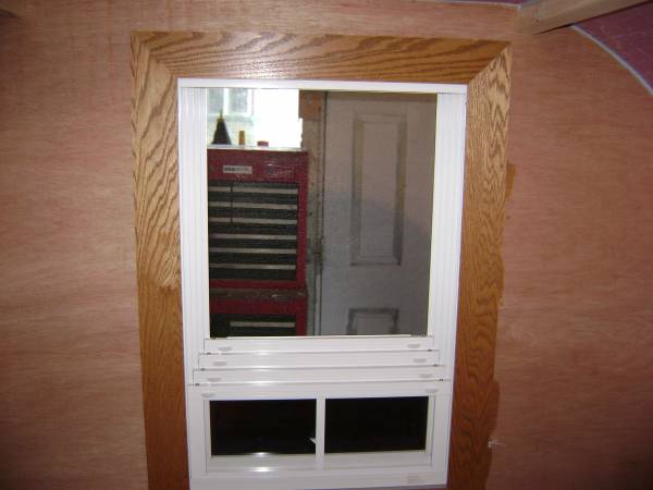

Did you use any wood reinforcement above the door?
Postby pat g » Sat May 21, 2011 11:28 pm
Thanks Mike,
There is an oak frame around the door opening then canvassed over. The oak frame was glued in.
Pat

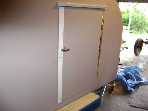

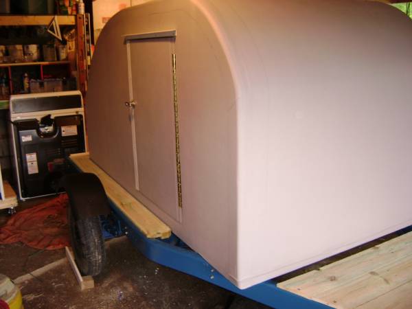

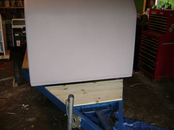

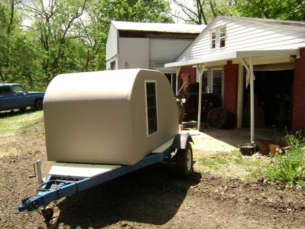

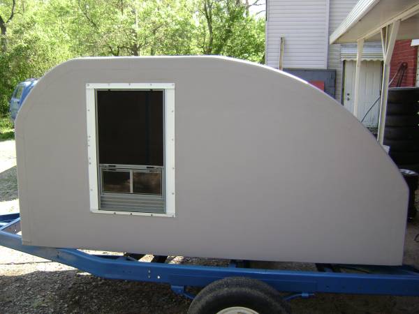

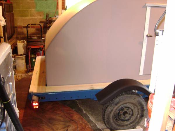

Postby pat g » Sat May 21, 2011 11:39 pm
Hey All,
I worked on decking out the extra width of the trailer frame and tongue. I figure the tongue will be a good place to put my cooler. The tongue platform can also serve as a place to cook.
I added the door handle. A garage door handle worked pretty well. I have to finish re-installing the lights. I did not like their original position so I made some new brackets tonight and will re-position them tomorrow.
Here are a few pics.
New tires next week then hope to get it out for a maiden voyage. I plan to camp in it this Summer, with the interior unfinished, then decide just what I want inside so progress will slow down for a while.
Pat G

Postby GPW » Sun May 22, 2011 5:48 am
Love those running boards ... :thumbsup: 8)

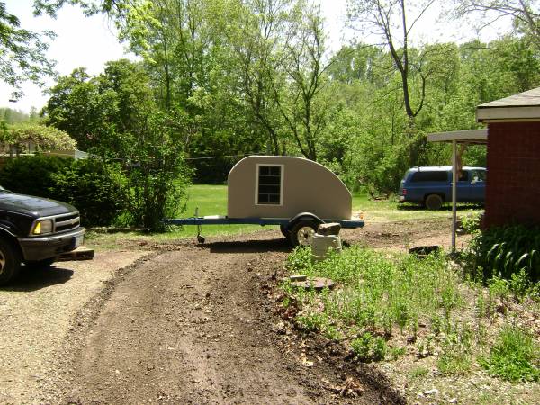

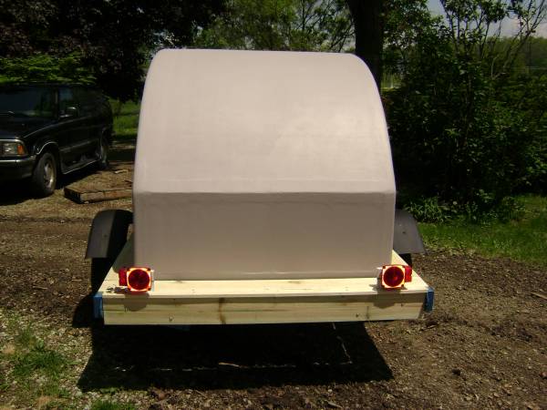

Postby pat g » Sun May 22, 2011 7:20 pm
Latest pics with lights wired. Ready for tires and grease the bearings. Should be road ready then.
Pat G
