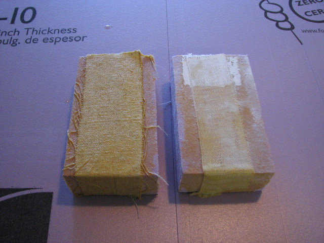

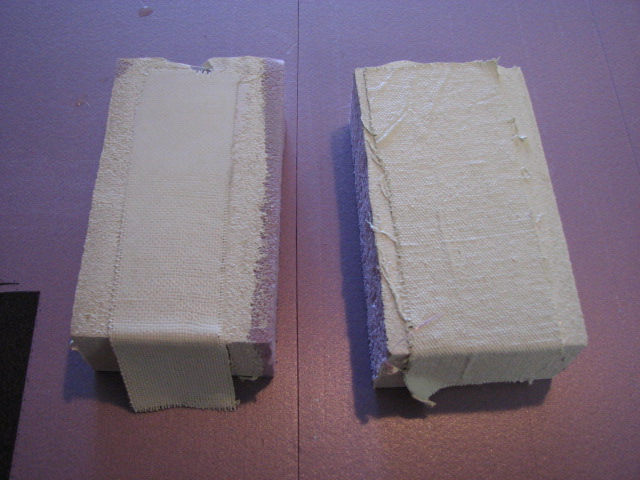

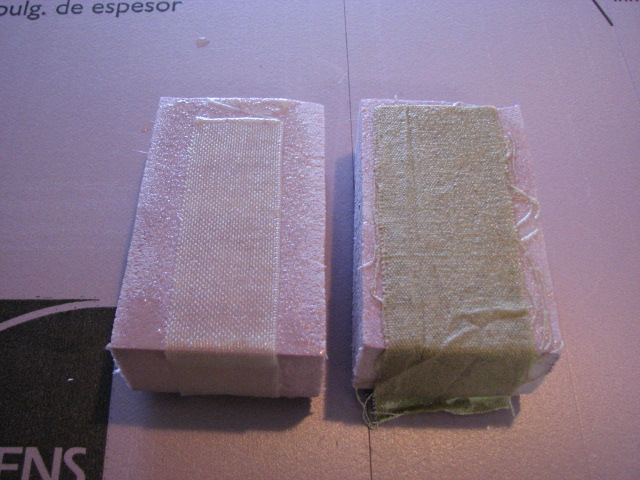

A while back, I made some samples using fiberglass cloth vs. canvas and used different "adhesives". I promised to share the results so here goes:
Here are the samples using epoxy as the "adhesive".
TB2 adhesive
Exterior Latex Enamel House Paint
Kilz 2 samples
I thought all the samples adhered to the foam reasonably well. I've tried picking at the edges of the fabric but did not succeed in pulling up any of them. I could pull the fabric off all the samples using a loose edge as a handle but since there won't be loose edges on the Road Foamie, I don't consider that a real world test.
I then looked at which one would be the easiest to finish. I tried smoothing on some Flex-All to fill in the weave. I'm not sure it makes that big a difference. I then painted on some Kilz 2 to fill in the weave and I could barely tell a difference between the two methods
I'm not totally sold on any one method but it seems like exterior latex or Kilz 2 over the fiberglass cloth does the best job. I'll rerun the sample when I get my 2 oz. fiberglass in. (This was done with 6 oz cloth).
