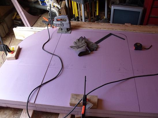

Very nicely done. You are obviously a much better craftsman than I am. When I clamped and cut my two sheets of foam, I had a rough time getting the cuts to be plumb. The jig saw blade kept deflecting. So my sides are not identical despite my efforts. I didn't bother with the shop vac and I'm still finding pink foam pellets everywhere in my garage. Looking good! :thumbsup:

I have a old saber saw, probably from the 50's, that has a large base. I did a sample piece with the blade I had and it cut great so I thought I would give it a shot. I think if I was using a jig saw with a narrow base I would attach a wider plate to the bottom. Really the only problem I had was that the blade came loose and started to wander some. I even thought before I made the cut I should check the bolt, but then forgot. :roll: Luckily it did not wander too bad, but if it was any looser I could have had a bit of a problem to fix.

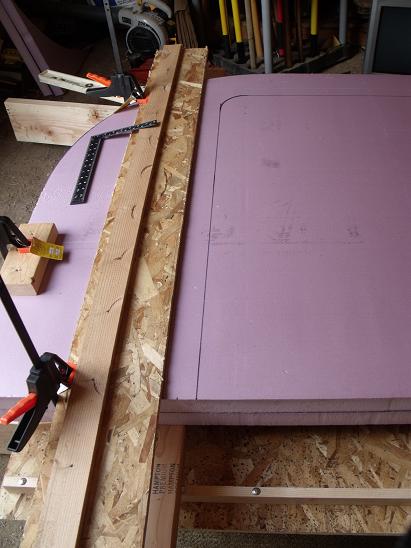

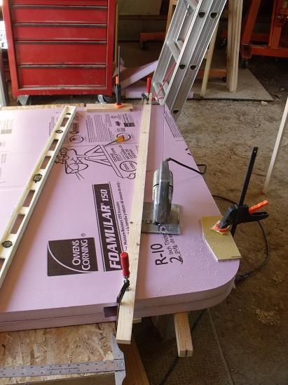

Today was door day. I was planning on making a hot knife jig for this, but after the success of the outer radius cuts with the sabre saw I thought what the heck.
I made sure the blade was nice and tight and added a lock washer to make sure it would not work loose again. I set up a straight edge and began to cut. As I cut I would add some packing tape to help hold the door to the body. I did not want the foam to break and do not plan on taking the doors out until after I glue the walls to the floor. I only have 6" of foam over the door so I know it is weak. Also there is a potential of some flex at the top which could allow you to glue the door frame to far or too close together on the floor. With the door in place it will make it easy to see if all is well.....

Setting up the straight edge.

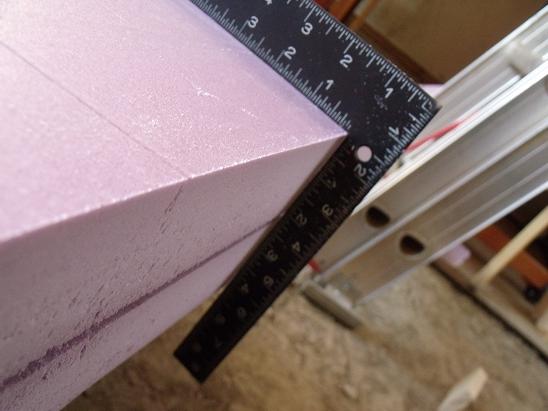

My old sabre saw. Making the top door cut...
Cutting the door.
DSCF1706 small.jpg (67.08 KiB) Viewed 9309 times

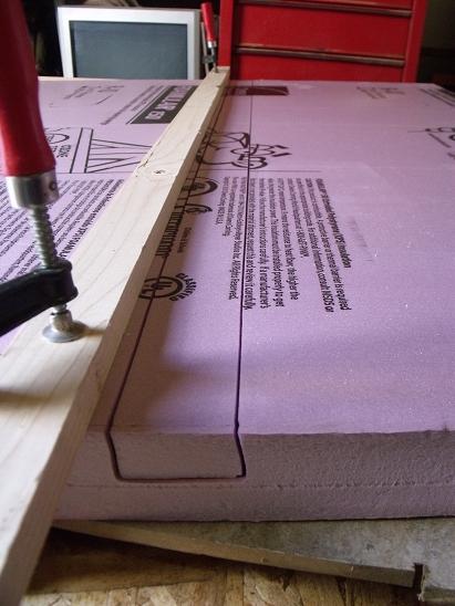

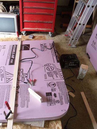

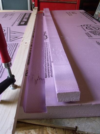

So I still wanted to play with the hot wire idea.
In my build I am planning to dado joint the bulk head and the shelves to the side walls. I made a simple hot wire jig. The wire is welding wire and the power supply is a battery charger for a car.
Ready for the hot wire cut.
DSCF1708 small.jpg (79.47 KiB) Viewed 9307 times
The cut.
DSCF1709 small.jpg (66 KiB) Viewed 9307 times
Dado....
DSCF1710 small.jpg (63.05 KiB) Viewed 9307 times
It worked pretty nice. :thumbsup:

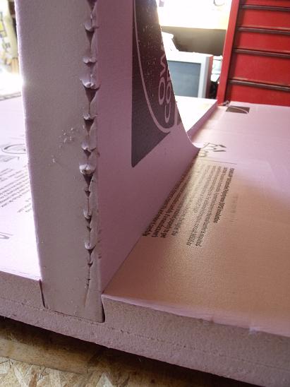

I tested the fit with a peice of scrap I had laying around. Fit was good.
Test fit.
DSCF1712 small.jpg (59.15 KiB) Viewed 9305 times

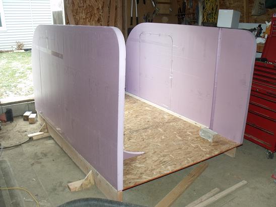

No foam yet for the bulk head, but I did set up the sides to get a idea of how it will look. When I looked at the foam when it was laying on the floor I thought to my self, this is going to be too small. Once I got the sides up I thought, wow this may be too big. :?

Sides up.
DSCF1717 small.jpg (68.04 KiB) Viewed 9305 times
