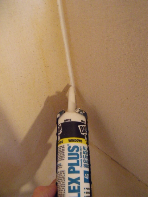

Postby ghcoe » Thu Oct 13, 2016 8:44 pm
I use DAP Alex Plus caulk. Here is a picture of me applying it exactly as you want, on the inside corners.
Caulk

ghcoe wrote:I use DAP Alex Plus caulk. Here is a picture of me applying it exactly as you want, on the inside corners.
Thanks! You posted this a little after i had already bought the caulking i went with but thats good info to have.
