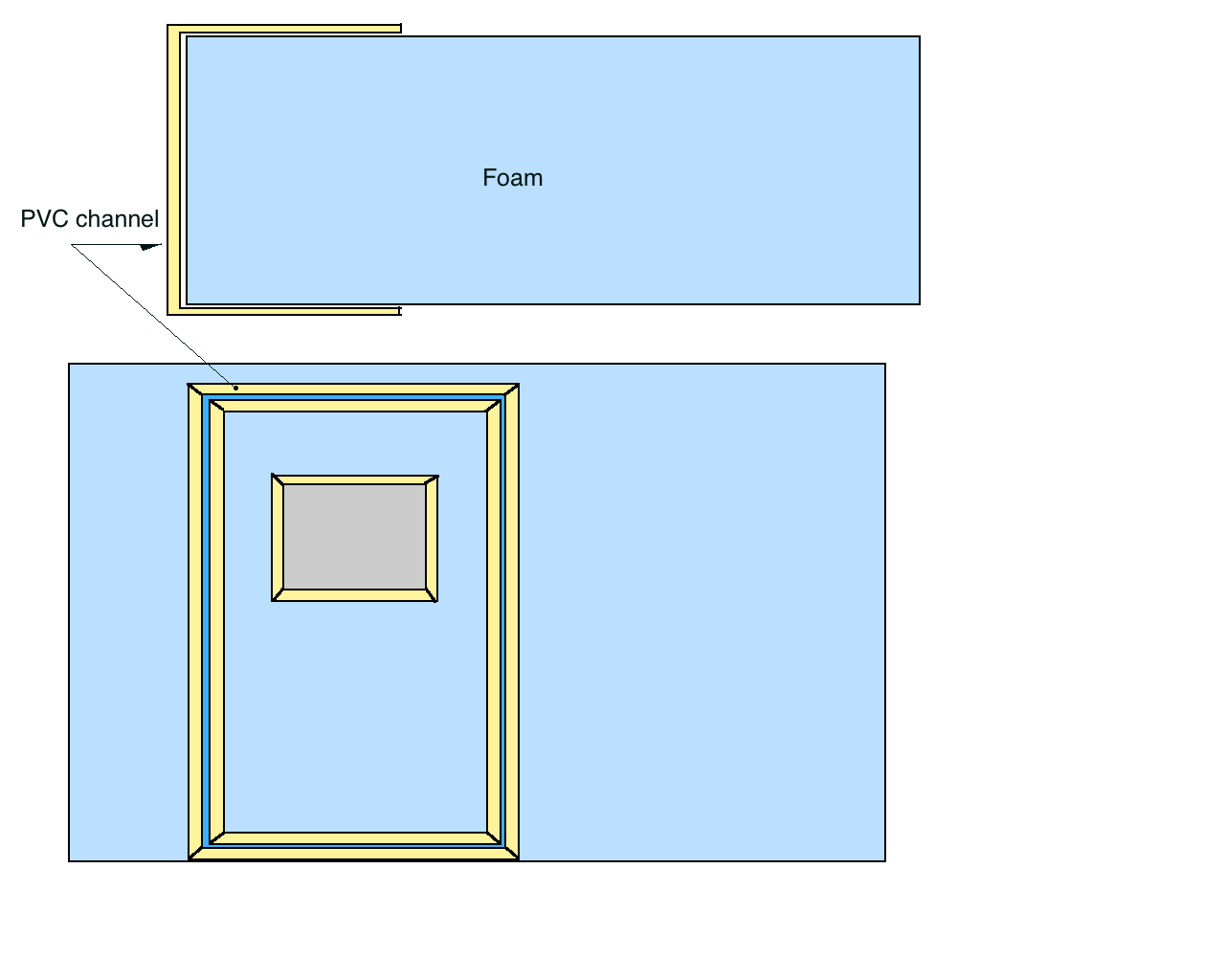

We’ve been looking around for a 2” X 2” (or similar) PVC square tubing that may replace any wood framing members on a Foamie ... Less wood , less chance of problems ... :thinking: But then we saw PVC Channel ... which if we could get the right size , the 2” foam would easily slip inside allowing that to become part of the structure rather than being merely glued on... And you could easily mitre it to form door frames and reversed , door casings ... :o Windows too ... It all seems pretty simple , depending on if we can find the right size channel ... Still looking ....
Re: Thrifty Alternatives ... Building Foam TDs
Postby GPW » Mon Mar 31, 2014 7:43 am
Like this :

Postby Hardryder56 » Mon Mar 31, 2014 7:48 am
I wonder if PVC fence pieces would be of the correct size? Also check out the TrailTop thread that Jeff has going, he has designed and made proof of concept fiberglass pieces that can be used to build any number of shapes and he also has a rear hatch rib set up that makes building a Tear Drop hatch a breeze. Molded fiberglass part plus foam would be the best of all worlds. :)
Hope this link works: viewtopic.php?f=2&t=58690

Postby GPW » Mon Mar 31, 2014 8:11 am
Moulded fiberglass parts would be really Terrific for Foamies , just door and window frames is all that’s needed really :thinking: Maybe just a length of correct fitting fiberglass moulding that could be cut to fit and glued into place ... That would be Nice too ... :thinking: Many possibilities eh ? ... 8)
Har’, all the PVC fence posts are 4” X4” and larger... but they do make a 2” X 6" , that could be made into an end channel by sawing off one of the edges... :thinking:

Postby bonnie » Mon Mar 31, 2014 11:59 am
I'm experimenting with a PVC brick ledge piece. It would make a nice window casing.

Postby cpinetree » Mon Mar 31, 2014 3:45 pm
GPW wrote:Moulded fiberglass parts would be really Terrific for Foamies , just door and window frames is all that’s needed really :thinking: Maybe just a length of correct fitting fiberglass moulding that could be cut to fit and glued into place ... That would be Nice too ... :thinking: Many possibilities eh ? ... 8)
http://www.lowes.com/pd_87348-73428-730 ... facetInfo=
Looks like if you cut that right you could get a square tube and 2 Channels, out of each piece. Now that would be super thrifty!
google searching for pvc channel & pvc square tubing brings up alot of other things but none nearly as inexpensive as the Lowes 3 channel 2x6.

Postby GPW » Mon Mar 31, 2014 3:55 pm
I have to get my hands on one of those , just for some testing ... ;)

Postby Hardryder56 » Mon Mar 31, 2014 5:29 pm
Wonder how hard it would be to mold a piece of PVC pipe, cut it along the length and then heat and mold it over a 2" form. Mmmmmm maybe I have a project tomorrow.

Postby Jack B. » Tue Apr 01, 2014 6:19 pm
I don't know what they do on the inside for structural strength, but the PVC plastic "planks" they make for the flooring on porches, decks and steps might could maybe be ripped lengthwise on a table saw with a vinyl blade. They come in a couple different widths I believe so you could end up with a pair of suitable size channels to work with. Might have to cut out some inside ribbing to make it a true channel but that wouldn't be that much trouble.
Also, not real thrifty but, there is aluminum channel in various sizes and thicknesses that could be used. Around windows and doors, anything straight would be a piece of cake. The amount needed would be well within budgets for most and it would last a l-o-n-g time. Wouldn't work around curves like teardrop rear hatches but cutting plywood arches for each side of those isn't that big a deal now is it?
