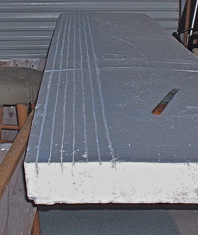

Went back with a thick coarse flat rasp and a quick pass down the kerf slots widened them to three times their size , but we quickly found out on a straight slot cut like this , you have to go in and widen the Whole slot , not just at the top ... after a quick vacuum of the slots , the foam is bending much further now ... ;)

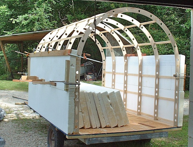

Yeah Ned , it’s that deep :o (3.5” thick foam ) , but I wish the saw cut was wider , I even re-set the teeth on a jig saw blade to get wider .... it helped a little , bit I still had to go back with the rasp .... and vacuum ...Got the second panel done ... these will be the two side panels that sit above the ones previously installed ... This is where the foam goes from straight (sides) to curved (top) ... Hence the partially kerfed panels ...
The plan is to glue the bottoms of these panels to the top of the other panels already installed , let that dry , and then glue it to the stringers and ribs , with a 10’ board and clamps at the top to hold in the slight curve till the glue dries ... After that we have to start some serious kerfing ...
I realize this is the Grandma method :oops: ... so easy , and safe even Grandma could do it ... A router would make quicker work of this ... circular saw too ... :NC
Ps. If I had a spot welder , I could just weld a couple jigsaw blades side by said , save for the mount ...Then I could get a nice wide cut (1/4”) , no going back with a rasp ... May try that as yet ... :thinking:

Well. GPW, I hope you like the granny method. That's what I ended up doing to two panels and yup it's a mess. Pretty time consuming, very untidy but it works. One thing I did discover is that doing my cuts freehand I could make pretty wide cuts by twisting the circular saw ever so slightly sideways while cutting. It essentially made the blade wider. Don't know how to make your saw do it consistently, but if the width of the cut is important there's gotta be a way to set a jig to fix the angle of the blade from dead ahead to slightly askew.

To make a circular saw easier to cut at a bit of an angle screw the base of the saw to an auxiliary base made of plywood, at an angle to the edge of the plywood. Then you can run the edge of the plywood along a straight edge that is clamped to the work. Be careful as the blade guard probably will not be working but you sure could get a wider cut, and some what v shaped.

A circular saw at a slight angle would leave a rounded bottom hole with a slight taper. Pretty sure about the taper. I would think a rounded bottom would cause less stress riser than a square bottom grove. At least in metal, not as sure in foam. I think I would at least try a test piece.

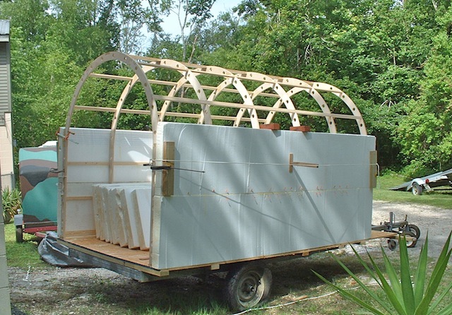

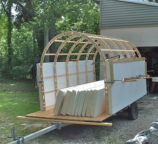

You know Wolf, that may not be a bad idea huh ! I could shim the back of the saw’s bottom plate a little so the blade would present itself at an angle to the cut when using a “guide”/fence... The wider the shim (angle ) the wider the kerf ... Hmmm??? :thinking: This deserves a test .... Outside ... The foam will be flying !!! :frightened:
Getting ready to go outside and attach the next panels ...Pics will surely follow ...
Re: FoamStream...
Postby GPW » Sun May 26, 2013 10:09 am
OK , that step done , except for not having enough BIG clamps ... had to improvise ... :thinking:
