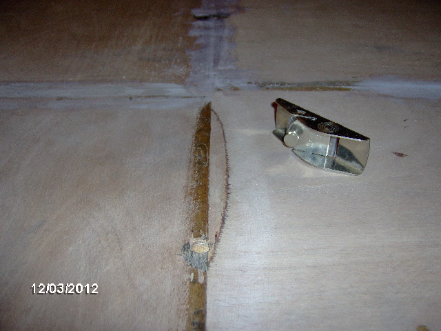

One of the panels had a slight raised edge that was quickly and deftly faired using the tiny hand plane; shaving the outer ply back by about an inch over about a foot of length. Sweet. Nice clean fair. Same species inner plys. Good factory glue bond with no spauling of the feathered edge. Nice.

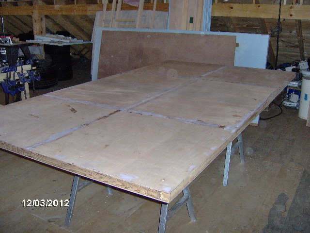

I know that I said that I was not going to spend anymore time fairing or filling the bottom of the floor (at least I think I said...), ... but, well, but... it only seems logical to make sure that all of the small edges and breaks in the outer ply from the staples and panel edges are well faired and sealed before applying diluted TB2, then black stuff. Can't be too careful sealing the under side (...your climate and opinion may vary... my climate is mostly wet).
Took about 3 walnut sized batches. They took a little more effort to blend than the batches that I had done last summer, but the working time was nice and long and I was therefore able to use most all of it before it started to kick. Then I sat and admired my work for a while... and a bit more... and gummed up some sand paper... and waited a bit more, then just kissed it a bit with the small sureform and it was perfect.

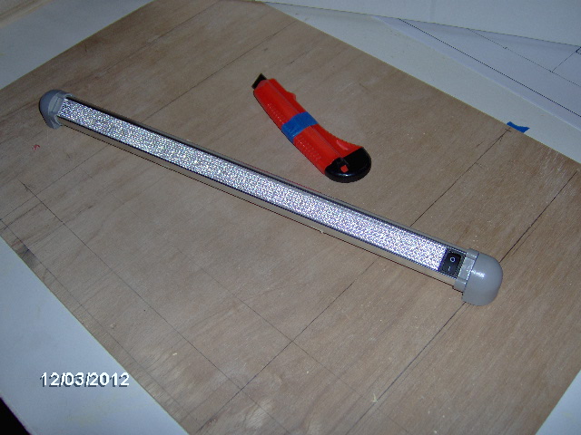

The galley light bar came in. Not as bright as I would like, but in the deep dark back woods of Poet Creek, probably sufficient. Difficult to tell just touching the leads to an 18v drill battery momentarily in the dark. Might get another and run two. Still considering puck lights under the shelves as well. Need to get further along and test.

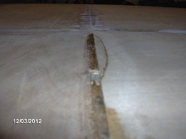

Underside of floor all filled and faired.

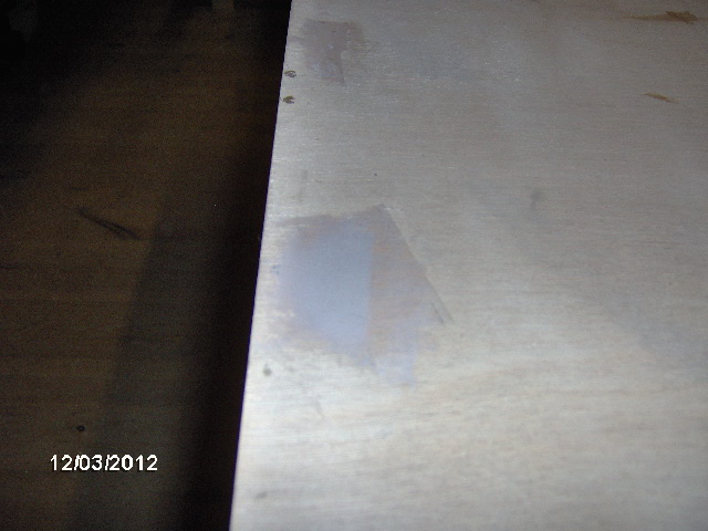

Filled a bunch of staple indents.
And shaved a small step between panels. Look closely. You can see the ring around the area on the right where the top ply has been totally shaved down, as well as the lighter area around that showing the extent of the fairing on the rear panel (right side in pic). The darker area on the left is where the glue squeezed out onto the middle panel (left in pic) during the original glue up.
This was caused by the slight variations in thickness in the foam sheets. That last corner of the galley was the start of a second sheet that was a bit thicker than the first, and I did not figure out that it needed to be fairer before gluing up the skins.

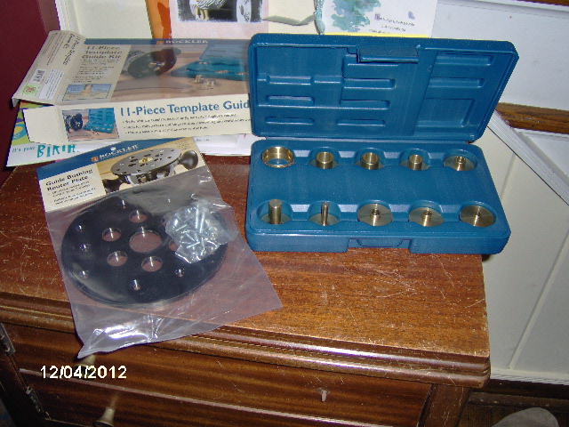

It’s probably just me butchering the proper terminology. They are "router guide collars" that fit into the base of the router, or in my case, an adapter plate attached to the base of the router.
The extended portion of the collar surrounds the cutter and can be held against a template "guiding" the router shoe around a profile.
The advantage over flush cutting bearing bits is that the cutter can be set at any depth and the collar always stays in the same relative position to the shoe.
For the templates that I have been making out of thin underlayment ply, this is a big issue. With the thin templates each flush cutting bit can really only be adjusted to a very narrow range of depth and still ride on the template, and even with a cutter the same length as the depth that I want to cut, there always seems to be a space between the bearing and cutter, and the double sided tape raises the template off of the work a little, too, so it doesn’t always work out with the bits that I have on hand.
When making deep cuts in wood (or other firm materials) it is not such a concern because you can just go deeper on the next path and follow the cut you just made. But what if you want to make a shallow cut and the only flush cutting bits you have are longer? I haven’t tried it, but I doubt that the bearing will ride on foam well without deforming it and wandering off.
I could make the templates out of thicker material, but that costs more $$$ and takes a lot more work to do (the thin ply can be cut quickly with a razor knife and straight edge, vertical band saw, or router with just a little clean up from sanding.
The disadvantage (although minor) is that you must make your template offset (smaller or larger) to the shape that you want due to the diameter of the collar being bigger than the cutter.
