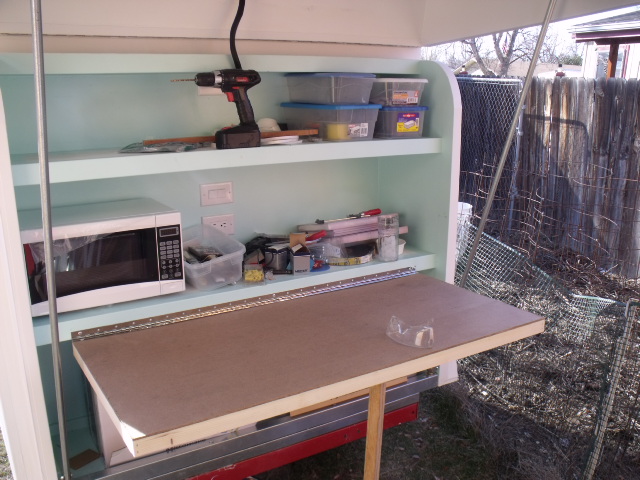

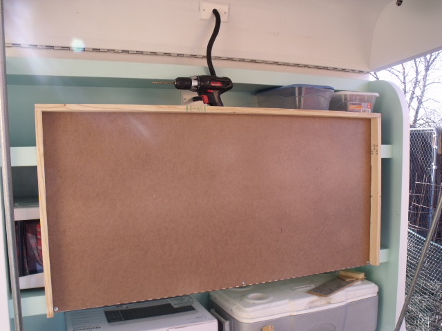

Last weekend I worked on getting the galley counter installed. Eventually I will be doing the paper bag method to finish off the counter tops. Still need to work things around in the galley to find their place first though. The counter will have a hole cut into it for the sink to fit into. Here it is mocked into place. The counter will be supported by cable from the support struts that hold the hatch up.
Counter stowed
Counter deployed

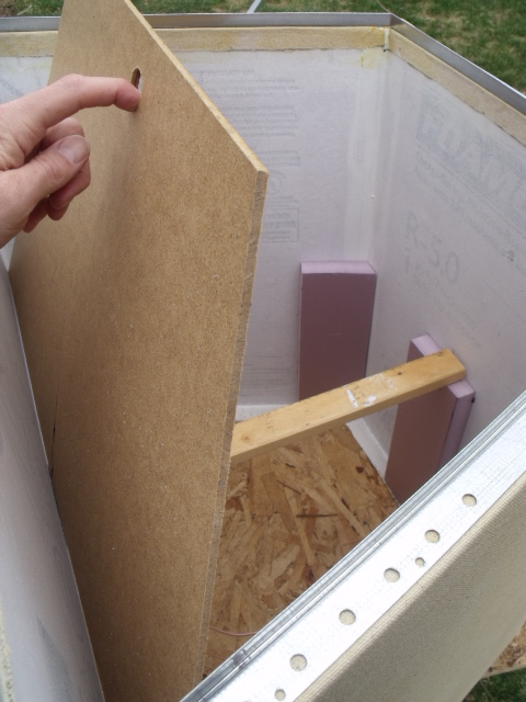

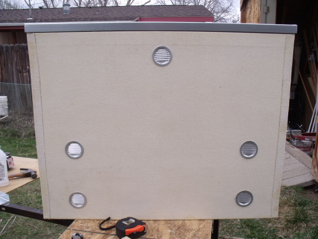

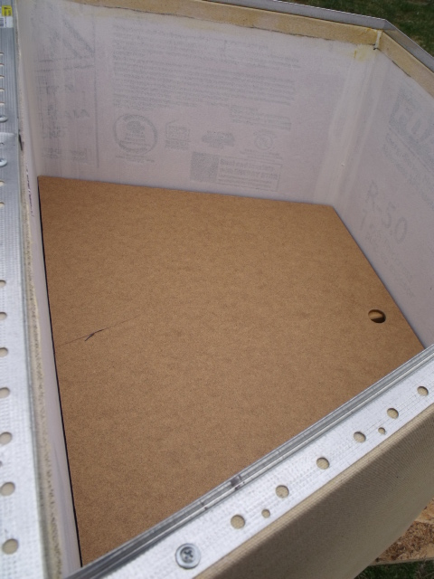

I had forgot to mention that I did install vents and a false floor in the battery box a few weeks back.
False bottom down
False bottom up
Vents
George.

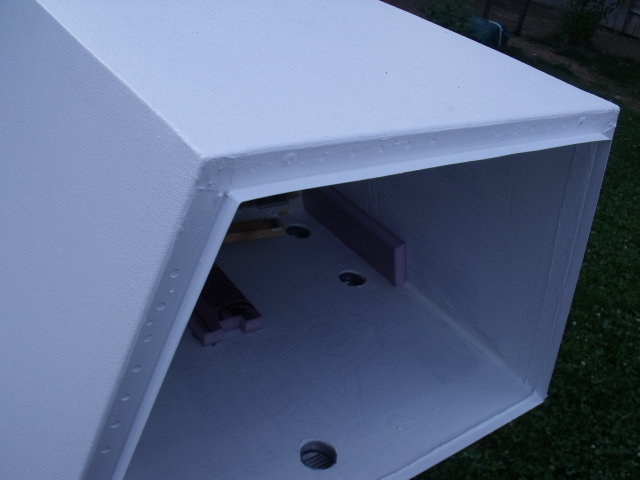

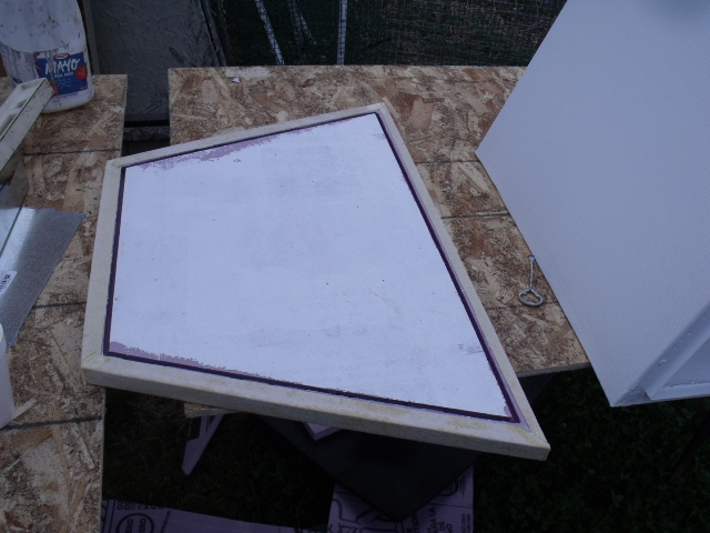

And then this weekend I started to harden up the battery box hatch. This will protect the edges and allow a attachment point for the hinges and hasp.
Hatch hardened

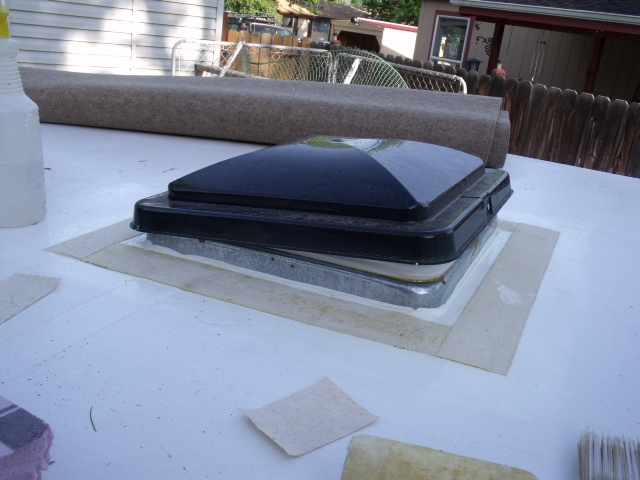

Postby ghcoe » Tue Jun 06, 2017 7:49 pm

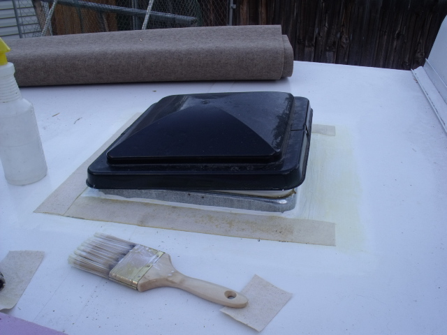

I got a few items done on the trailer last weekend. Been wanting to seal the vent a bit better than just the vent flange. I just sealed the vent on without using screws or rivets so as to not encourage leak points. Just to make it a bit more secure I added some canvas over the top of the vent flange. It will be sealed and painted to match the roof.
Vent install
Vent install 2
George.

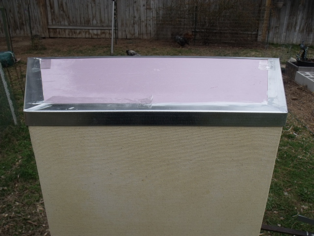

The battery box is getting closer. I got the canvas installed on the hatch.
Hatch
I installed the sealing flange with pop rivets and then primed and painted.
Flange

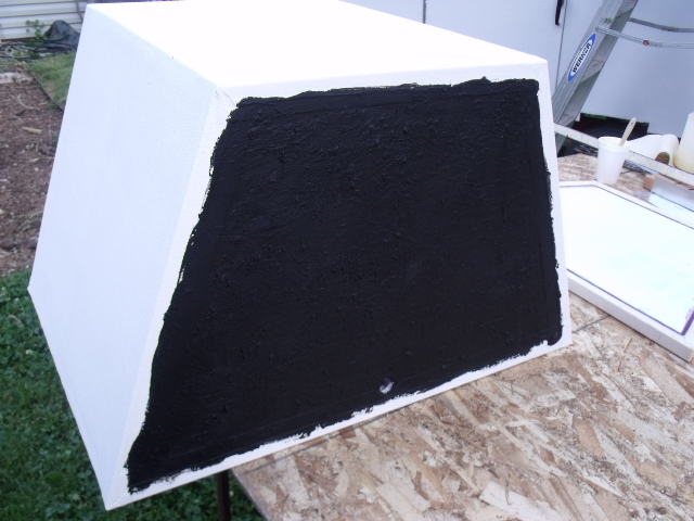

And I painted on the black nasty stuff to the bottom.
Goop

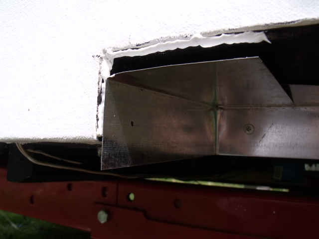

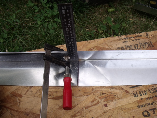

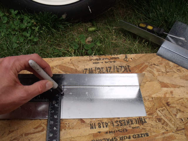

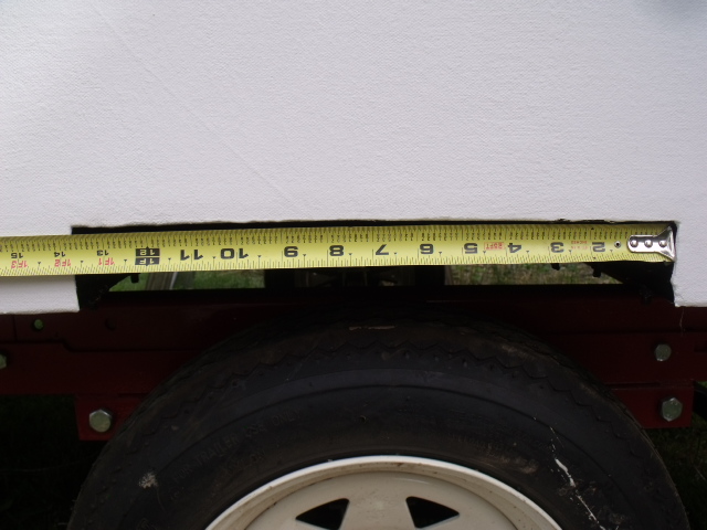

I also worked on sealing the wheel wells. I used 3"x2" angle flashing and 7"x12" flashing square to make the well with.
First I measured.
Measure
measure 2
Then I marked for the cuts. I made my cuts about a 1/8" short so the flashing would easily fit into the well.
Mark for cut
George.
ghcoe
Posts: 1982
Location: SW Idaho
Re: #1

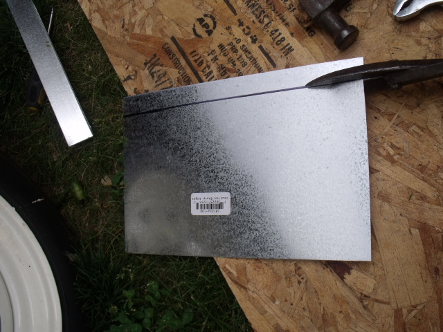

Postby ghcoe » Tue Jun 06, 2017 8:05 pm

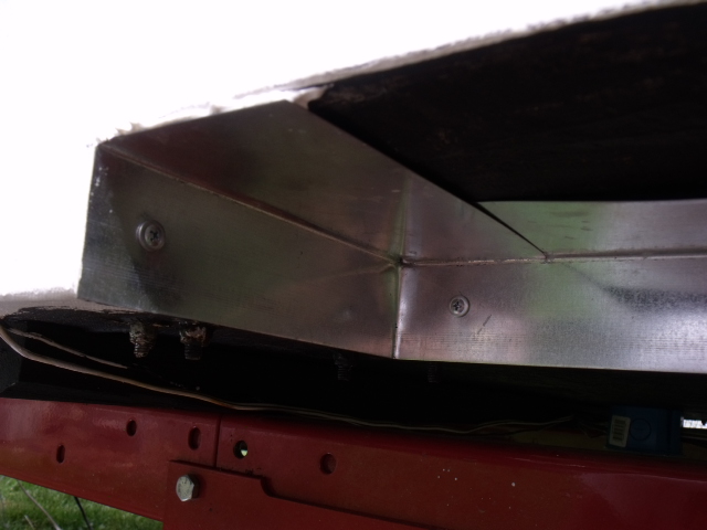

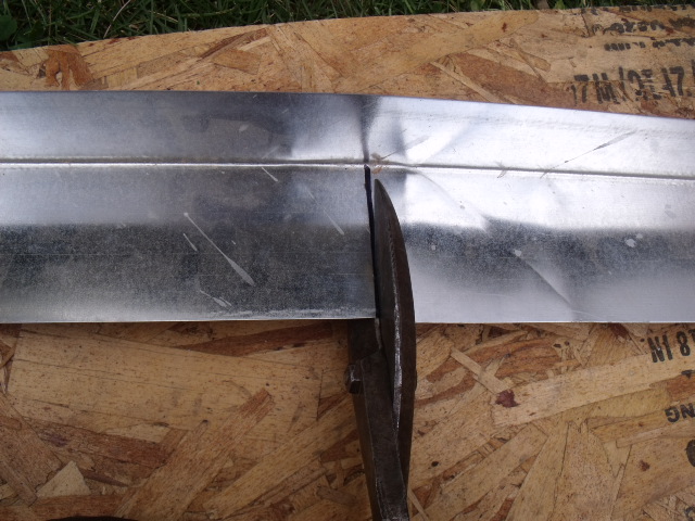

Then it was cut.
Cut
Bend.
Bend
Caulk.
Caulk
George.
ghcoe
Posts: 1982
Location: SW Idaho
Re: #1
Postby ghcoe » Tue Jun 06, 2017 8:08 pm
Install.
Installed

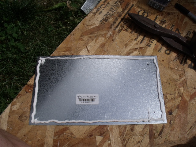

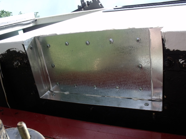

Next was the flashing square.
First I cut it to width.
Cut to width
Then added the caulk.
Square caulked
Then screwed it in place.
Square installed

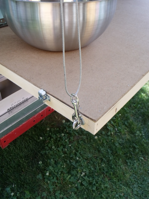

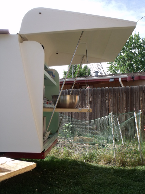

Postby ghcoe » Tue Jun 06, 2017 8:20 pm
Then on to the hatch.

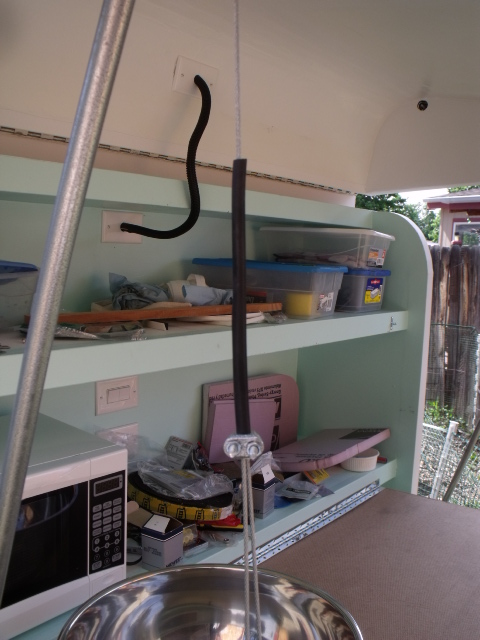

I wanted a fold down shelf. I am supporting the shelf from the hatch supports with 1/8" steel cable. I installed eye bolts into the shelf and then installed clips to the cables.
Clips and wire
I clamped the wire so the shelf would be level and then slipped over the wire end some vacuum line to keep it from poking people.
Wire protector
And now I have a shelf for cooking on and for my sink. :thumbsup:
Shelf deployed
